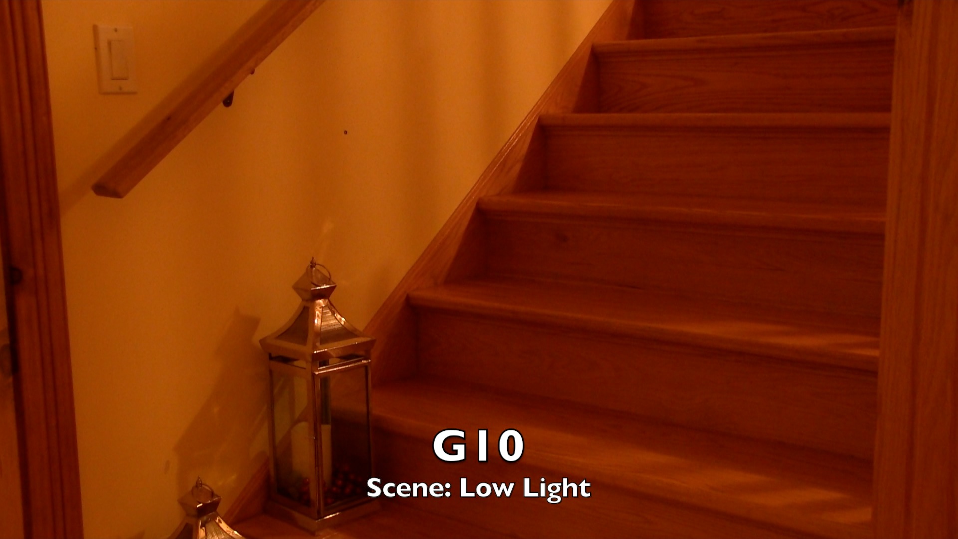

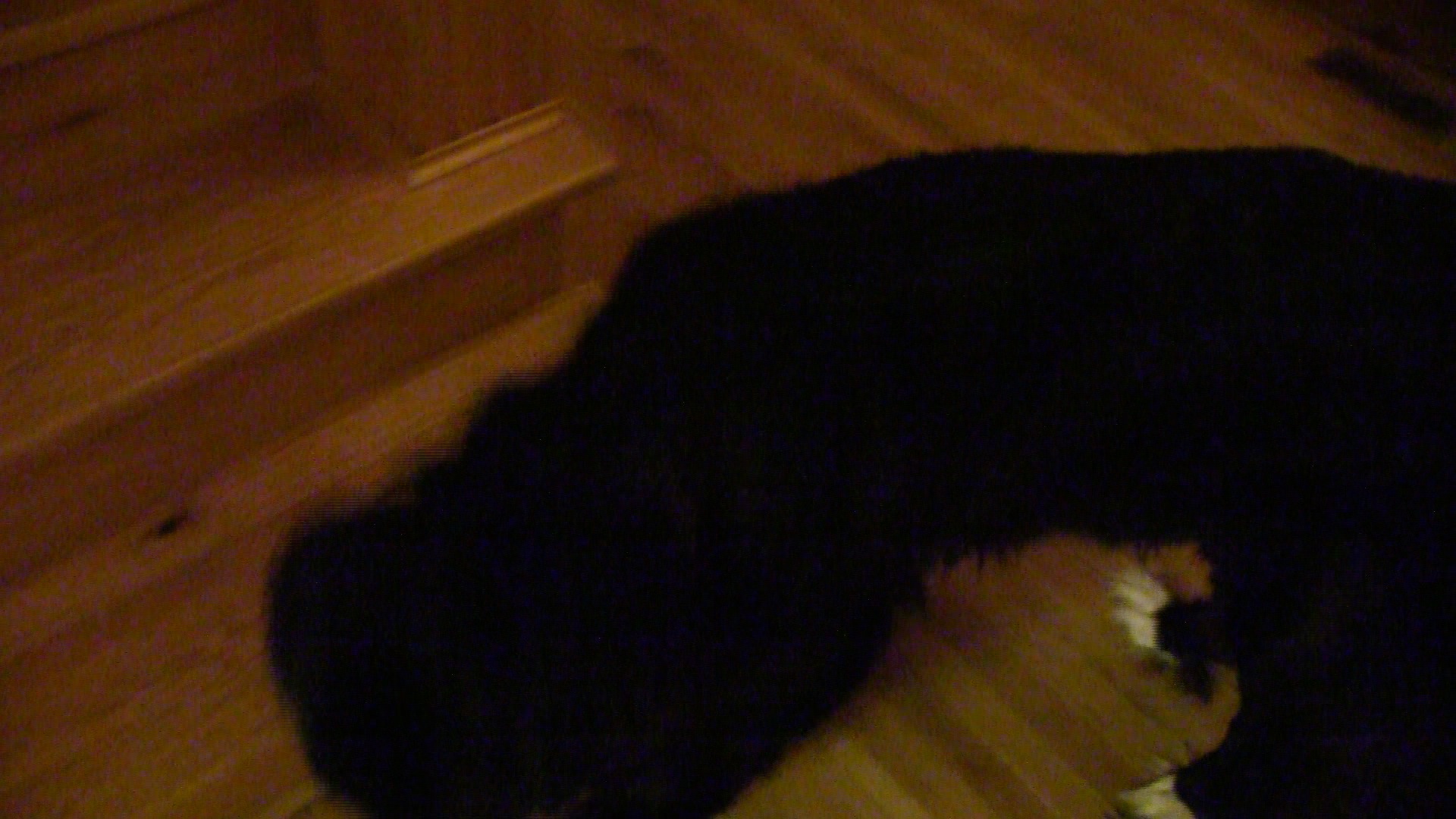

OK. This is a still taken from the video after importing to FCPX. The scene was lit with 4 x 60w bulbs overhead, so low light but not exactly dark. What on earth is all that purple noise? This particular test was just awful. I think there's a problem with this unit. I don't see how the editor can introduce all this rubbish on import. Any ideas? Just one thing, and I don't understand it, the "Colour Profile" for this clip is shown as HD 1.1.1.... does that mean anything to anyone? The still looks like it's been taken at very high ISO on a DSLR that can't handle very high ISO! Just to add, this was shot on Full Auto, which should give much more reasonable results than this.

Your test is done using full auto, that is going to produce the worst images possible, the noise will be significant. Your conditions of 4x 60watt bulbs is very dark, by any standard, and any 1/3" sensor would have issues with that lack of light.
You are expecting more from the camera than can is reasonable.
The XA10 is much cleaner in low light that the G10, but even with it you must use 18dB as a max gain, not run in auto. Auto gain sucks. The room you are shooting is is much too dark, in the real world most of us would add light. If you routinely shoot in the conditions you demonstrate you must use lights or go with a DSLR. Even the EX1 would have issues in your scenario.

Jeff, thanks for your reply. I'm not sure I agree about the lighting conditions being very dark... it's in a hallway that is quite bright, as in addition to the lights in there it is lit by lighting from other rooms, too. An artificially light living room typically has a lux value of between 50 and 200. I don't have a meter but based on that I'd say the hallway would be at least up around the higher end of that range.
This G10 has a minimum lux rating of 1.5 (on programme AE, 1/30th sec shutter) and Canon recommend 100 lux up, so quite honestly I'd expect better quality than that seen so far.
Camcorder Info use full auto for their tests and were "blown away" by the low light performance. There's a post from Federico a few under this with night shots in Soho and I can't see much noise in those clips, nor that well reviewed Tower Bridge clip on YouTube (which looks gorgeous)..... I'm not getting anything like that. I'm starting to suspect I have a faulty unit.
I'll wait for nightfall, stick it on a tripod and test various modes / settings and see how it performs.

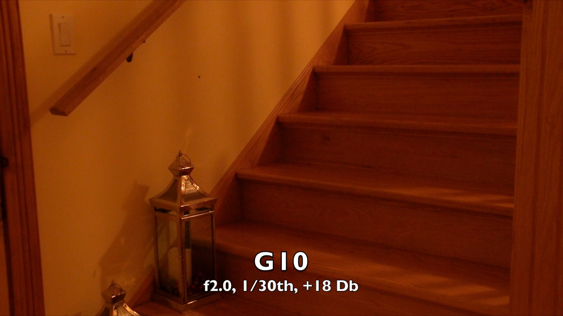

Joe, thanks, I dropped to 30p (as a start) and there's a noticeable improvement.
Jeff, I have followed your advice and set gain to manual, +18 max.
Jase, the word is that the extra bucks you paid for the XA10 got you more than a snazzy handle! There are discussions on here indicating that the XA10 sensor is a noticeable improvement over the one in the G10, even though the published specs look similar! I might try and persuade my wife to let me go this route ... :-)

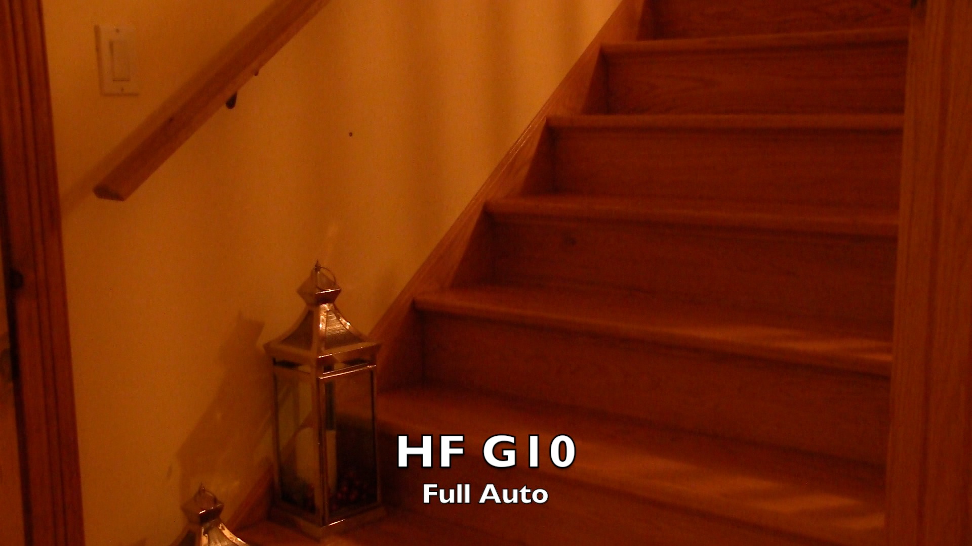

So, I did my experiment. No angle or point to push... the results are what they are. I have to be honest the differences were so minor I thought I'd left it on auto, then realised you couldn't change the settings in auto!
The huge difference is WB. As I said earlier, auto is way off. One shot shows after I adjusted to tungsten, which is much closer to the real life colouring. XM2 auto WB much better, closest is iPhone!

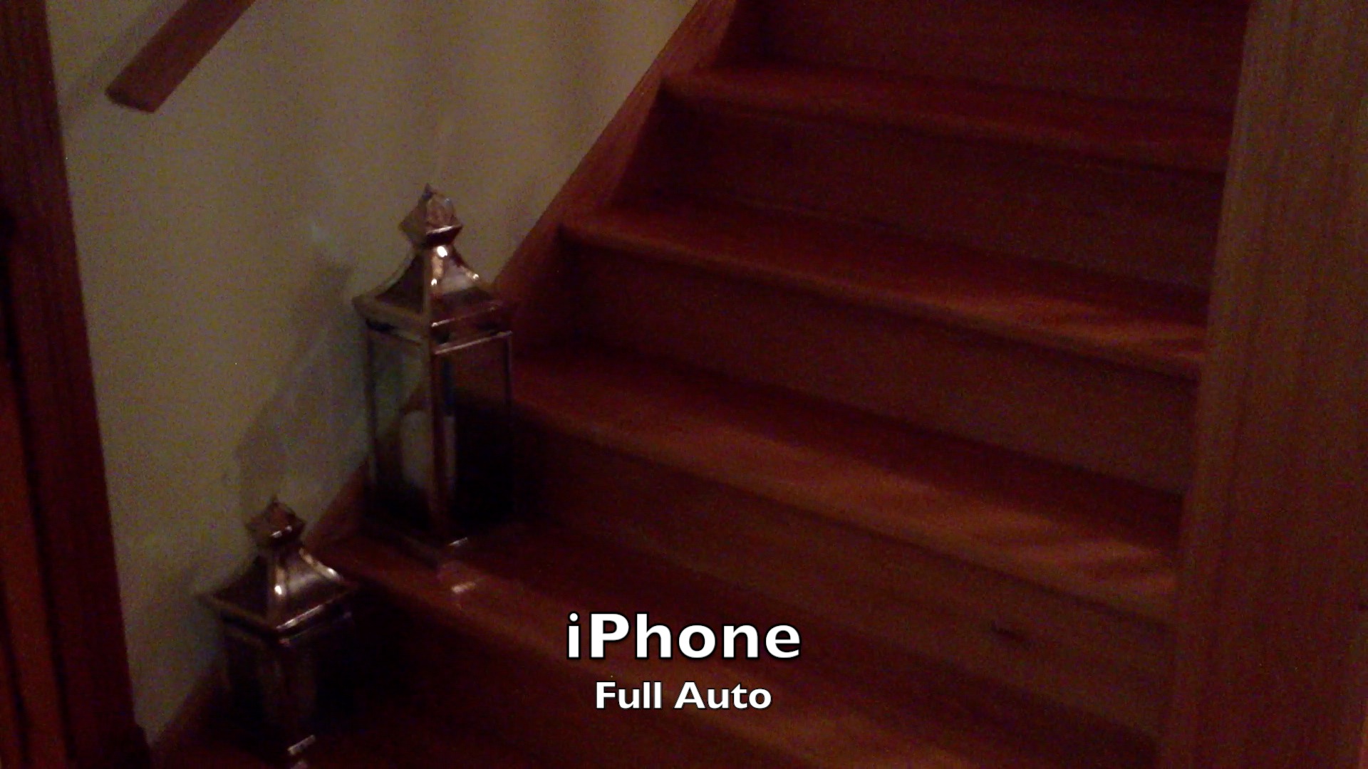

I have put iPhone shot and XM2 in... iPhone is a bit unfair as it couldn't be put on a tripod. I was surprised how the XM2 compares to the G10, I thought it would be better.

Looks a lot better now. I shoot most of my stuff in 30P, but some where 60i makes sense. I think 30P footage looks great. But you have to watch the motion.
Even though the white balance in the cam is generally pretty good, it's not perfect by any stretch. Your white balance is way off. The lighting conditions in that corner you have could be difficult for a lot of camcorders to negotiate. That's why there are several presets and manual white balance. To be honest with you, I don't think I've even ever shot any video from the XA10 in 'auto' mode. I adjust my white balance settings a lot between different shooting conditions to get what I feel is the most accurate image that matches the actual lighting. I think most on this board will feel the same. Learn your manual settings capabilities. Once you get used to using the LCD, it'll be a lot more streamlined for you.
It's not fair to say the GL2 footage is 'about as crisp' as the G10/XA10. I have a VX2000 and the footage looks pretty good in certain well-lit situations, especialy on a smaller monitor, but watch DV footage for 20 min on a larger TV then put up the XA10 footage and the differences become striking. GL2 was a great camera in it's day, but you have the modern version of the GL2 (well, maybe the XA10 is).
You get some significant things with an XA10 over the G10 besides a remote mic (well, you don't ACTUALLY even get the mic, gotta buy that). For one, there's the larger internal mem. Secondly, there is a REAL cold shoe where it should be when you aren't using the handle. The ability to capture better audio is significant because good audio is as important as the video. But, truthfully, you can mount a good mic on your G10 and still get great audio with the right mic and it might be that you don't actually NEED the extra features that the XA10 yields. Maybe you should invest more into DSLR if it is what trips your trigger. There are so many camcorder options out there, ya have to look at your needs.
P.S. I see a ton of noise and ailiasing in the iPhone image.

Yes, I didn't really consider the differences between the 2 cameras. The auto white balance on the G10 is harsh. My unsolicited 2 cents, return the camera even if you have to wait to get the XA. I wouldn't say that if you were happy with it but if you're anything like me, I'd always regret not having done so.
fwiw, when I have used auto on the XA, I thought the wb was pretty decent, a little blue on overcast days but nothing I haven't been able to fix in post.
