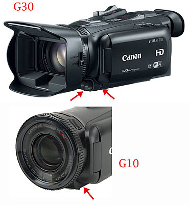

When using the 501 cut plate on the 502 head, are you able to access the exposure compensation button and dial? I use this at every wedding I shoot to up the exposure, and with the wide base of the 502, I just don't see a way to get my finger in there to press the button. Here is a close up of the dial and button I am referring to. The G10 does not have this button.

The plates may be similar, but the top of the 502 head looks larger and wider than the 701. I think the 701 would be easier to access the button/knob.
I ended up ordering the Fancier FC-370. It is far less than I budgeted for a tripod. I was prepared to go as high as $800. I tried a 501 head at a local photo shop and when it was on the tripod I could not push the button. I guess I could put a spacer between the body and the bracket but that seems really silly to me. I ordered the FC-370 from amazon so I can't return it if I really hate it. I'll report back as to how that work for me.

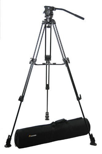

The Fancier FC-370 tripod is not going to work. The legs were ok. A little flimsy but worked well and resulted in a good working height. Overall it was a really cheap design. The bubble level did not work. There was fluid in the level but know bubble. How do you use a bubble level with no little air bubble in it? The bowl adjustment was hard to get right without going way loose with the knob. It took longer to level it with the bowl than it did using the three legs. The tilt was ok, but a little stiff. The pan was so stiff that it caused the sticks to twist up. You had to be careful at the end of a pan to let the tripod release it's wrap up. The spring return was also set very high for a light camera like the G30. The camera, led light and large battery comes to 1.5kg. I was able to access the compensation controls while on the tripod. To change the battery required using a coin to remove the plate before releasing the battery. The video came out ok, but it was so hard to operate that we decided it was just not going to work out. So we sent it back and ordered the 502 along with a couple of different plates to try (Benro QR6 & 50PL)
I'll follow up when I get a chance to try the 502.

The g30 works very well on the 502 head. I have no problems accessing the exposure button and knob. I have the camera mounted very far foward for balance but that also helps with the position of the knob.
