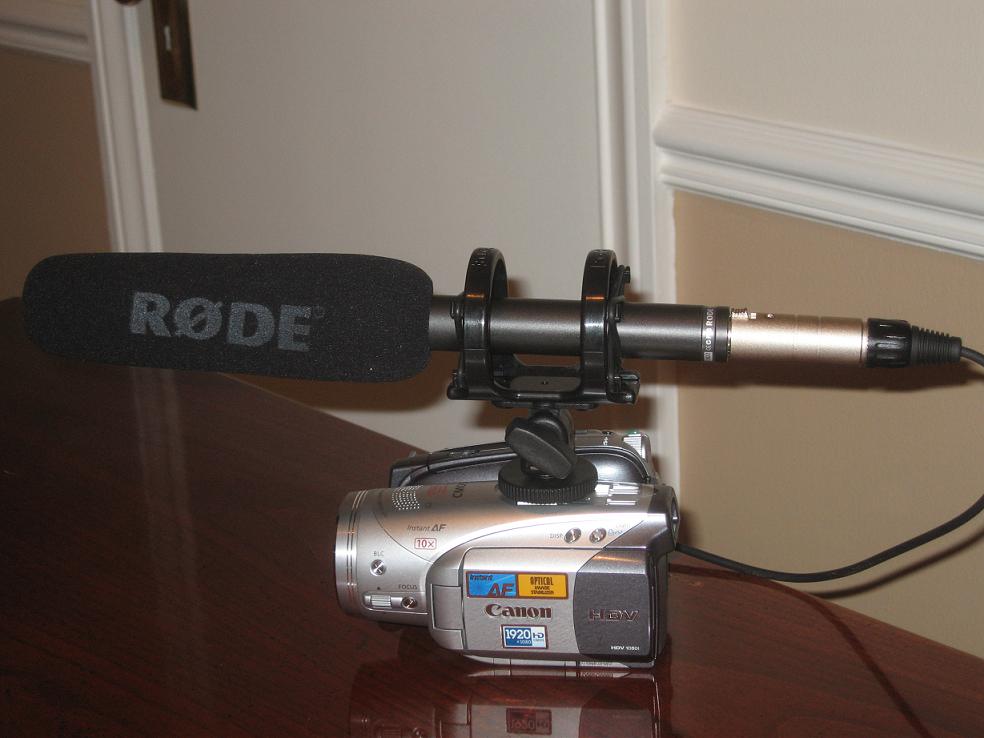

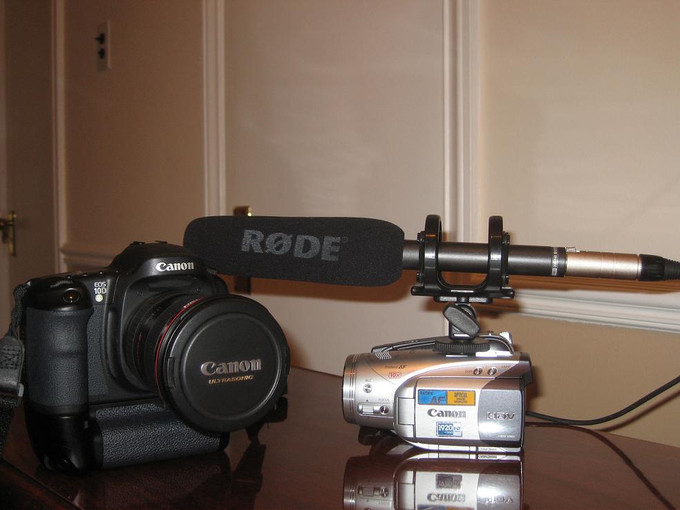

Here are a few pics of the cam with the NTG-2 on board, along with a cousin.
Rapo
