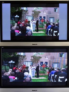

Thanks for the replies, and I've used the 16:9 presets but I'm still struggling with this. I'm including a photo of my TV in 4:3 aspect mode (which has the 16:9 box in it) and then in the "just" mode which stretches the 4:3 to 16:9 but as you can see the letterbox crop is still there and the movie is now actually narrower than 16:9. If I go to the "zoom" aspect setting it fills the entire TV but looks pretty bad.
Thanks again,
Vlad

Old May 22nd, 2007, 03:09 PM   #6
Location: Springfield, US
Posts: 63
Pixel aspect ratio does matter in both your editing app and authoring app. They both need to know that the 1440x1080 should be displayed as 1920x1080 or 854x480 respectively. I think this is accomplished by the 1.78 ratio.
Ian Albinson is offline   Reply With Quote
Old May 22nd, 2007, 04:28 PM   #7
Contributor
Location: austin, tx
Posts: 300
we are talking standard def dvd correct? it looks like the authoring app your using adds "hard coded" bars to the image, again in Dvd studio pro you can select whether you want it to letterbox, panscan or both. or it could be a setting with the dvd player as to how it displays 16:9 content. when you playback the dvd in your computer or another player are the letterbox bars hardcoded there as well?

Old May 22nd, 2007, 06:53 PM   #8
Join Date: Oct 2003
Location: Santa Fe, NM
Posts: 80
Austin, I think you got it, it is my DVD player. I haven't tried another one yet, but I've played it on a couple different computers and it looks fine.
Thanks for your help,
Vlad
