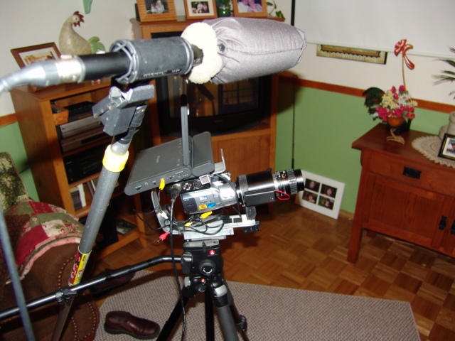

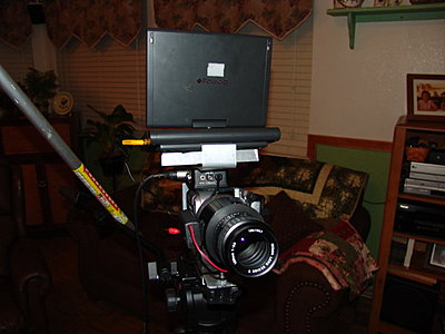

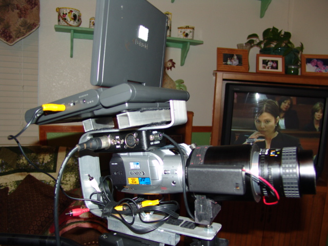

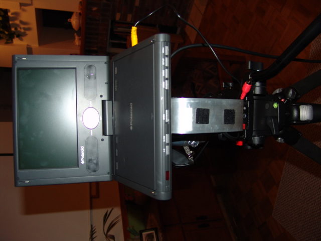

Here is one of configurations I shot the camera in. The video screen is a simple SD DVD Player which has AV in. Focusing is a challenge, but I think we did pretty well with it. In some scenes, we used a flat panel HD TV to monitor. Used Beachtek XLR adapter. Mic is the Senheisser ME66, with the K6 power module. Sound man actually turned power off on mic, as his field mixer provided phantom power. I didn't even realize the mic could be used in that phantom power configuration.

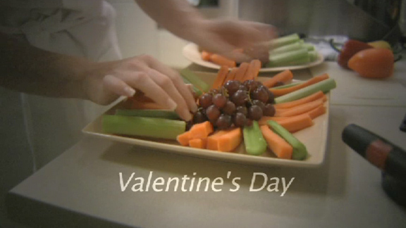

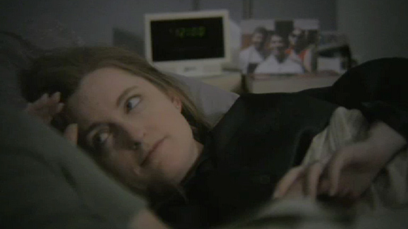

Last night we went to 48Hour screening in SF. Very interesting. I was a bit disturbed that the 48 hour people did not have a better system of assuring that the films were shown cleanly. A lot of the films appeared to be shown in the wrong aspect ratio. I'd like to see them take better care in screening the material. Our film showed in the right aspect, but also demonstrated interlace issues, and the right last 1/20 of the frame showed smearing and tearing of some sort I had never seen before. Our director had edited and sent everything in a data file rendered out of FCP, which I don't use, so I don't know if it was our issue or theirs.
All in all, though, we were pleased with the audience response. Ours was a rather dramatic film, while most others had comedy tones. We were the 10th of twelve to play, and most of the preceding films were light and comedic. The audience seemed ready for another funny one, then you could tell they suddenly realized it was serious. In the end, it was well received I think, because in the after screening question and answer period, when our director introduced himself, there was a very nice sustained and appreciative applause, expecially from the other directors.
As far as the look we got from the HV20 paired with the Letus, I think it did come across well. Problem I had in watching it there, was that I had seen better renditions of the film on my computer screen, and so I was noticing defects in the screening wondering about that, and lost track of just enjoying the feel of the screening. A couple of the shots seemed darker than we output we saw on our previews, so I think this makes it clear we should have scoped the film. Again, I don't know how that is done in FCP, but I would have looked at it in Vegas. Of course, that all presumes that you have the time, which you don't in a 48 Hour competition.
I'm attaching some low rez grabs I got from an H264 pre color corrected version I had, with the permission of the director. Very shortly we will have different on line versions of the film for you to review to. When they are up, I will post a link.

Wow, you did the 48 hour thing too? Your film looks very nice, based on those screenshots. I can't wait to see it. I went to the screening on Wednesday, and even though our film wasn't visually spectacular, it was great to see on the big screen, and the audience seemed to like it. Lighting is what killed us though, and I think it's what separated the professional-looking shorts from the Youtube-looking shorts. That, and sound issues.

Yeah. We did takes some time lighting but should have pushed that a bit more inside, as we were using Letus. As I said in earlier post, we pushed the exposure edge. In post, it can be fixed, and in fact versions we will have up shortly will be fixed to some degree, but the original submission could not be color corrected because of the time constraints. We actually had to contend with a 2 1/2 travel time because we had to deliver from here.

Very interesting film. Nice to see that the HV20 can perform like this under the right situations. The only thing that kinda threw me off was the lighting in certain scenes, like when the girl was in the kitchen finding out her son had died. There were some other scenes too, but it might have just been the crappy youtube compression. Either way, very nice film!

Yes, YouTube compression was a problem, but film really needed some brightening in post. We were at the edge of good exposure in some of the indoor scenes and we would love to have had some time in post to color correct.
