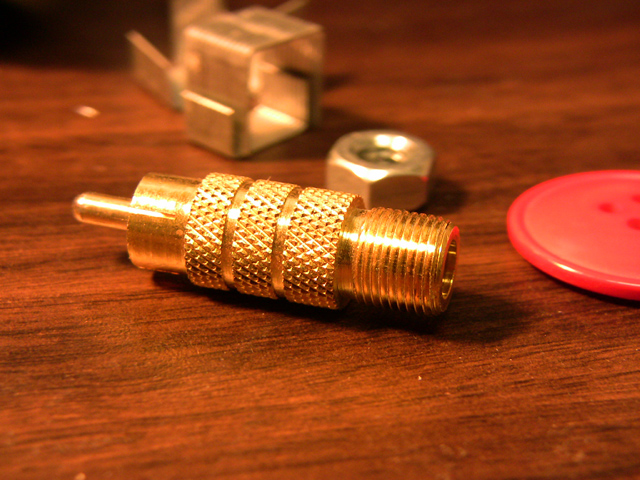

You might consider something like this. I used Cinevates achromat for its 35mm adapter to take these photos. It cost $245.00, but you could by an adapter and get it to boot... :)
