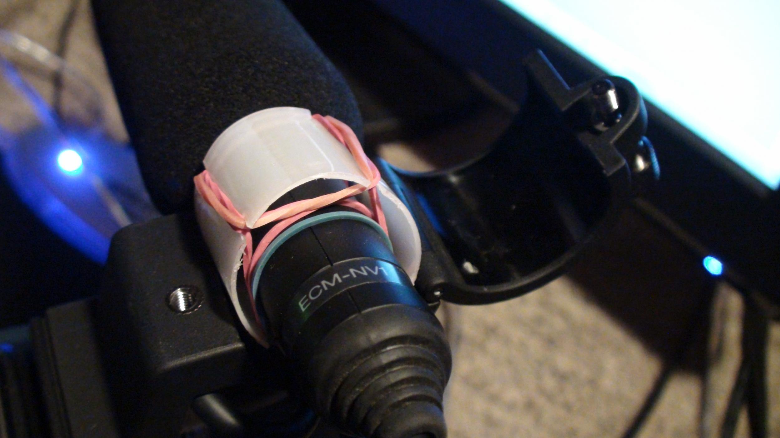

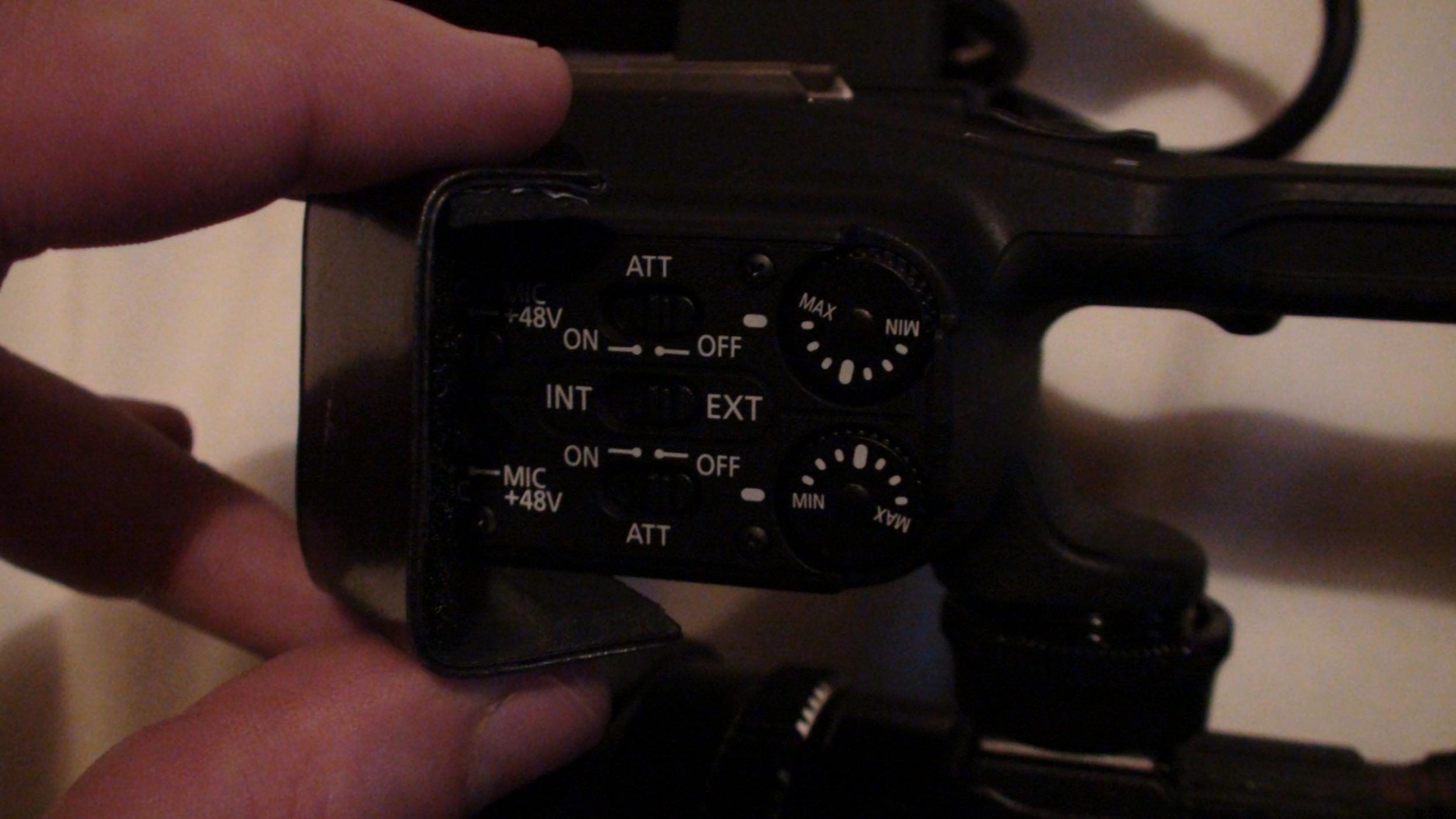

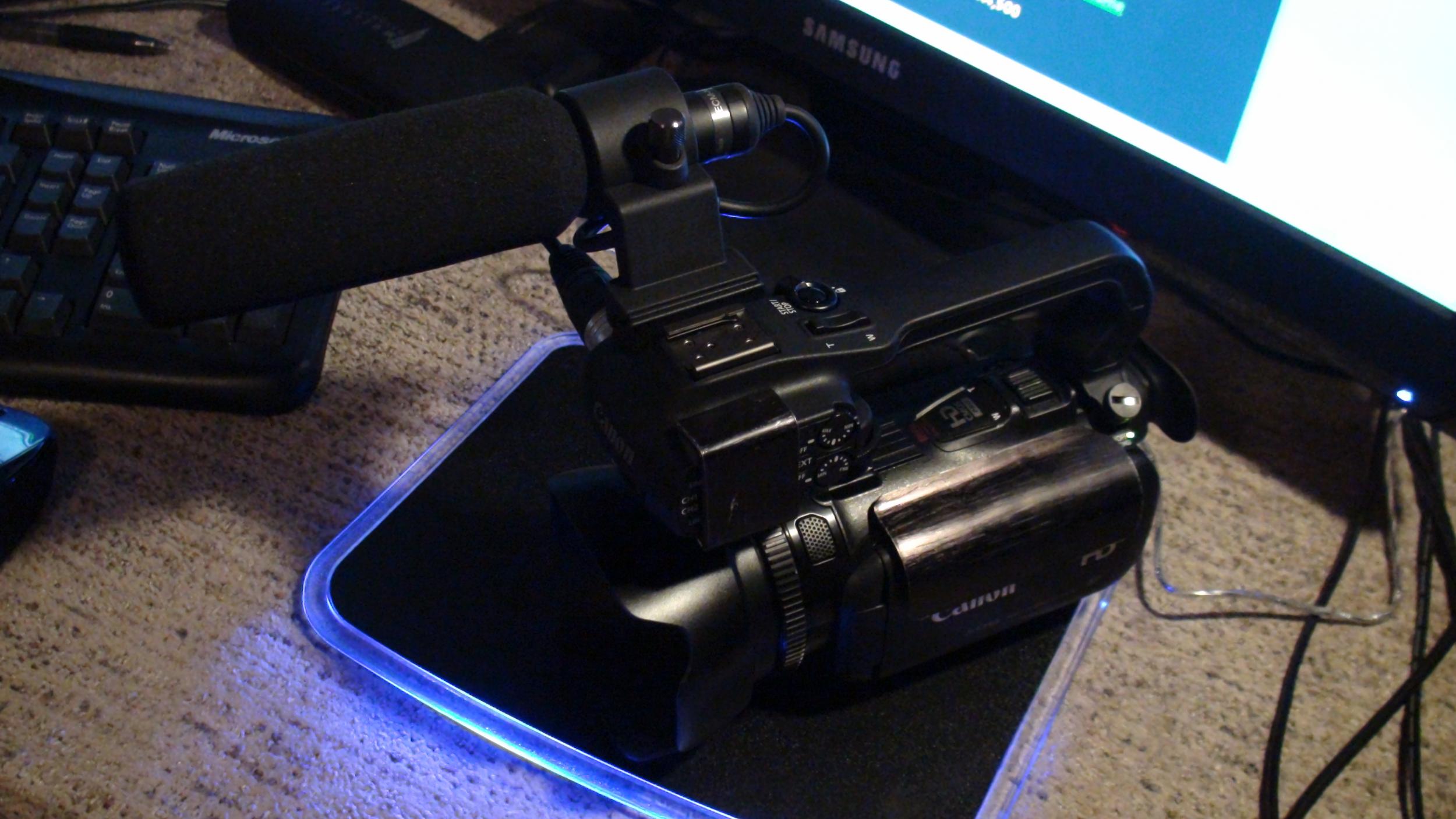

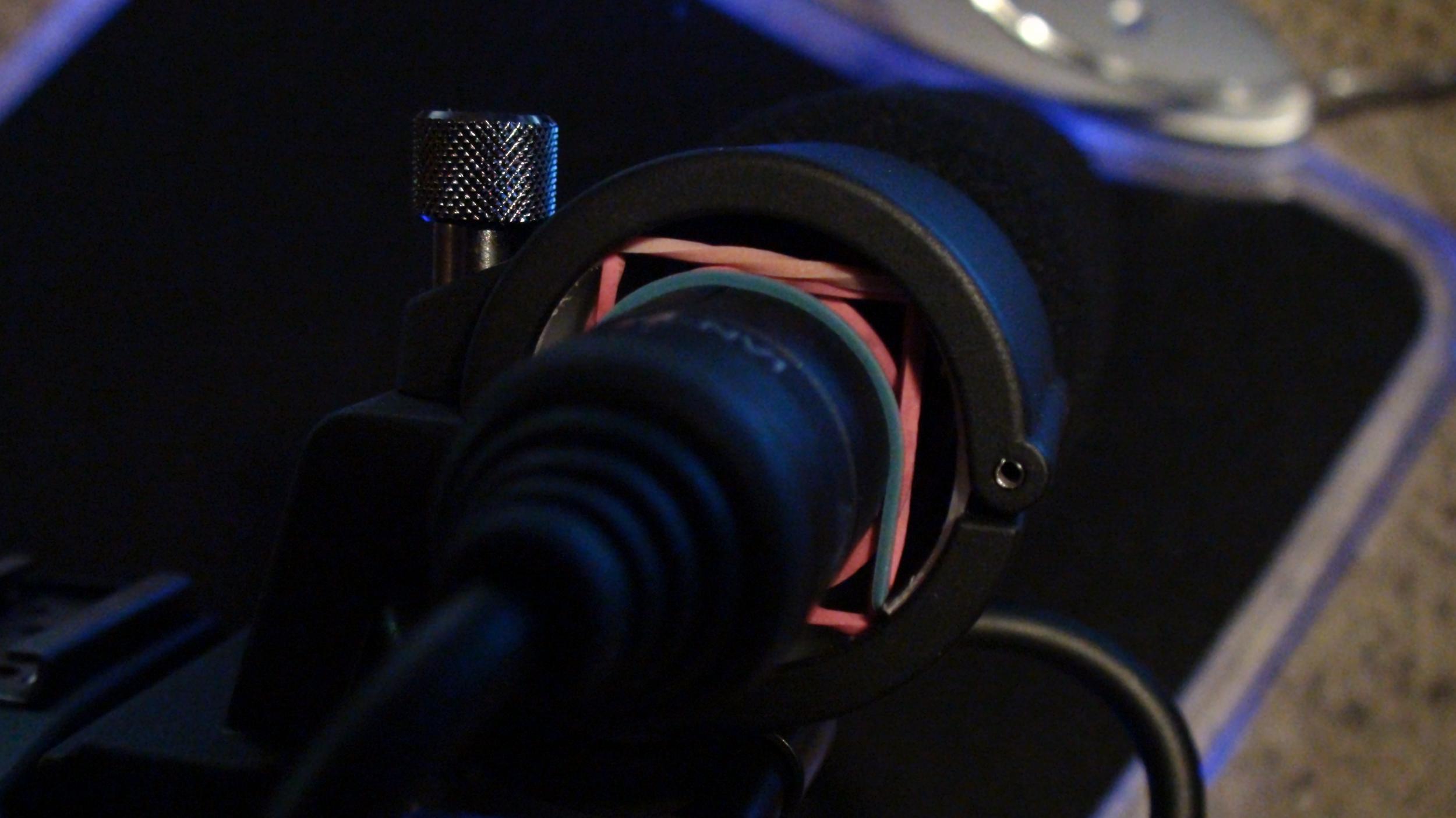

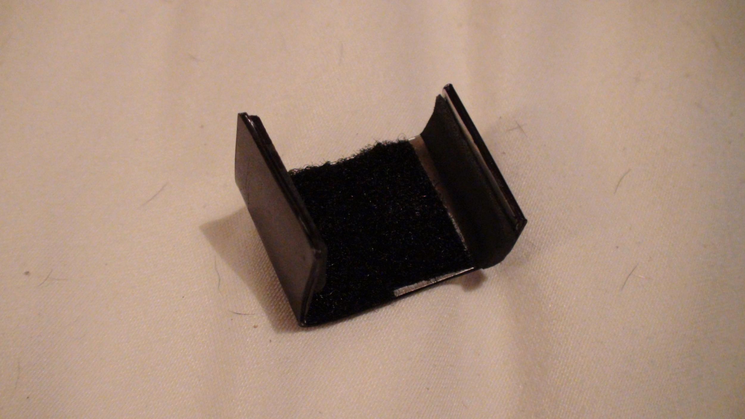

This is my solution to the problem.
The plastic switches on the handle makes a noise, also the base plate has a small piece of plastic that also rattles.
The DIY shock-mount is so that you don't hear the camera zoom.
