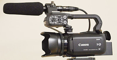

Audio Technica ATR875 work well, sized nicely. A recent thread has a photo showing it on a G10. Here is a shot ontheXA10. (The battery shown is a Wasabi.)
