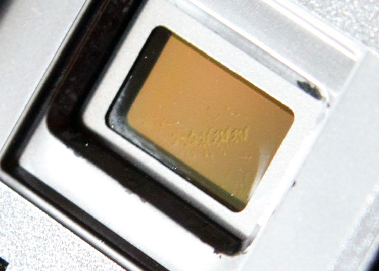

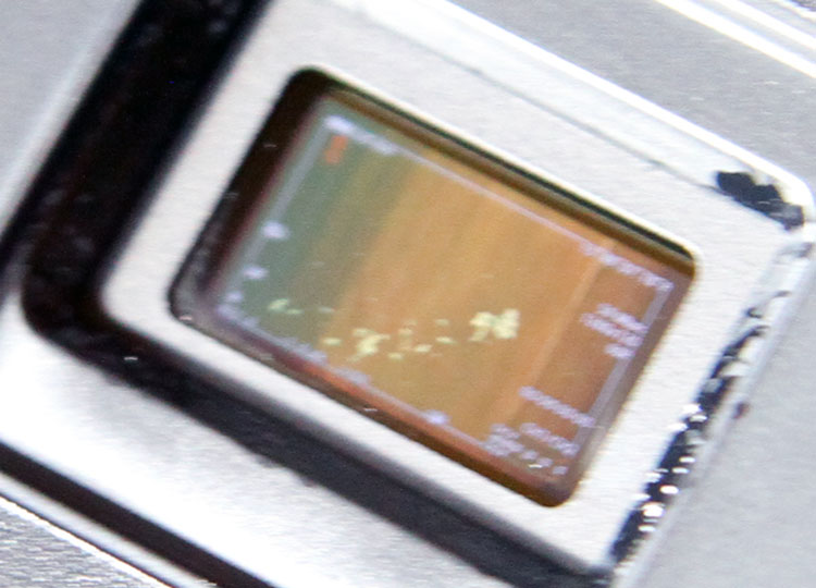

Location: Victoria, B.C. Canada
Posts: 21
Re: Burned artifacts in viewfinder!
I have not yet found the time to park my xf300 long enough to not effect work, so am getting by with tape on the viewfinder and using the screen. Not the best, but I have to do what I have to do.
Am posting a couple of photos to show the damage, one with the cam powered up, another off so you can see it clearly burned in.
From reading other posts here I am hoping this will be covered, but I am almost ready to get it fixed and put up for sale. I simply cannot live with this and do not have the time to chase Canon should it happen again, so I will shoot until I have a month off before the warranty is up next summer.
Crazy how some of us have this and others do not. Makes for a difficult issue to deal with.
LP
