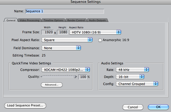

Prores is a more robust format, so I would use that for jobs that require lots of colour correction, but for day to day work it's great not having to transcode, and super fast. After using log & transfer with the "native" 50mb setting, I've been popping clips in a new sequence and letting FCP determine the sequence settings. They look like the attached (yes, a Sony XDCAM sequence).
When you create a new sequence, drop a clip into the timeline - FCP should ask you if you would like to change the sequence settings to match the clip. I've been editing the native files with a three year old macbook pro, and they work just fine, no rendering needed. Not sure why you're getting the orange line, good luck!
