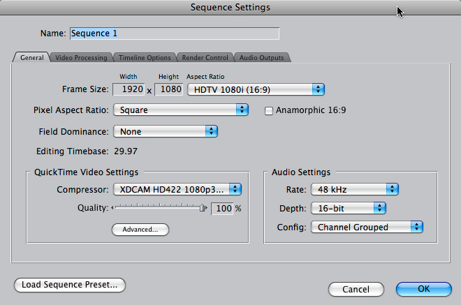

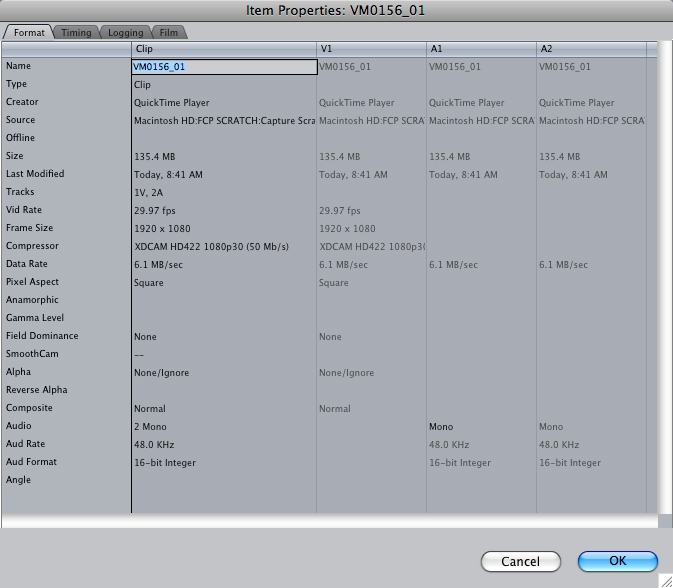

Larry,
Here are a couple of screen captures. The one on the right shows the properties of an XF305 clip (1920x1080 50Mbps 30P) that was imported natively using "Log & Transfer" into FCP 7.0.3
The one on the left shows the Sequence settings that FCP automatically chooses when that clip is dropped onto a new Sequence and I answer "yes" when it wants to change the Sequence settings. I'm not saying these are the best settings, I'm just saying that this is what FCP chooses automatically.
When the clip is on the timeline with these Sequence settings, there are no colored lines to indicate that rendering will be necessary.

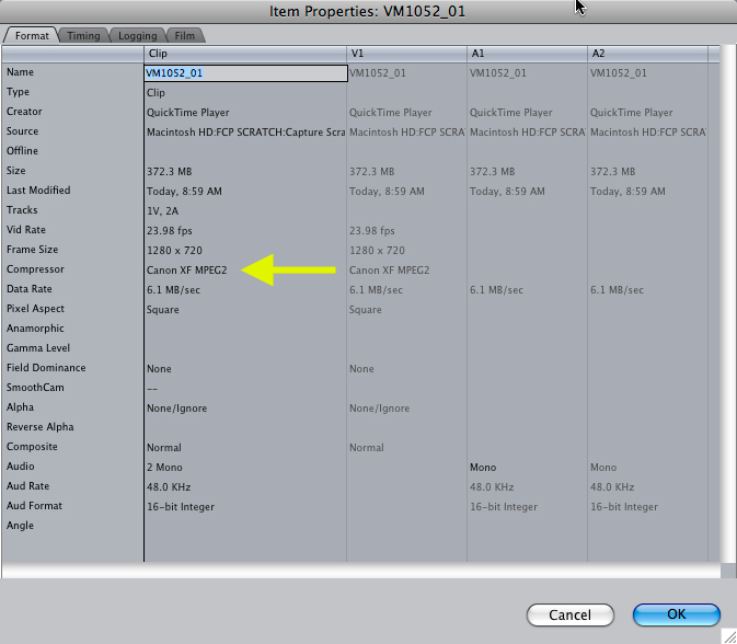

Larry,
Good news and bad news.
First, the good news. I can confirm that FCP will not ask to change the Sequence settings if your first clip is 720P. You might be happy to know that you're not doing anything wrong and you don't have a software problem.
The bad news is, I don't think there's anything you can do about it. It's a Canon/Apple problem.
First let me say that I am not an FCP expert so what I am about to say might be totally wrong, but this is how it appears to me.
If you look at the jpeg capture I posted earlier you can see that the Compressor settings for the 1920x1080 clip uses Sony's XDCAM422 codec. Final Cut Pro has built-in Sequence settings that match that codec exactly, so therefore will ask you if you want to match the Sequence to the clip's properties.
Now, look at the screen capture for the 720P clip. Notice that the Compressor settings say "Canon CF MPEG2". That is the problem. If you look at the whole list of avaialble Sequence settings, Final Cut Pro does not have an Sequence preset called "Canon XF MPEG2". Therefore, it won't offer to change the Sequence settings for you because it doesn't have anything compatible.
Until Apple updates FCP to include the "Canon XF MPEG2" codec, then I think you will always have to render. I guess you'll have to decide if rendersing is better or worse than just importing as ProRes.
I could be wrong, but that's how it appears to me. You might try using 35Mps 720P instead of 50Mps and see if that is compatible. Maybe FCP will be recognize it as XDCAM EX footage? I don't have time to try that myself right now -- gotta get some real work done!
