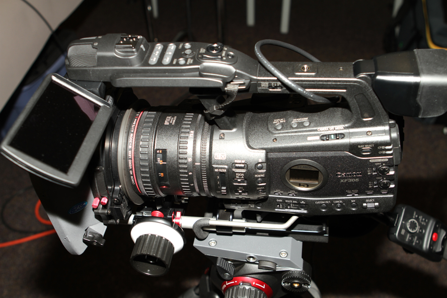

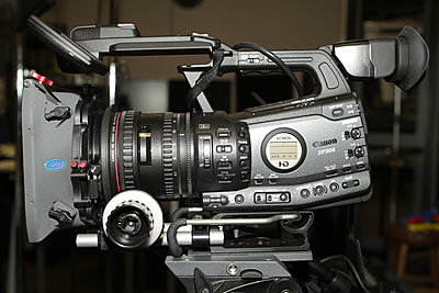

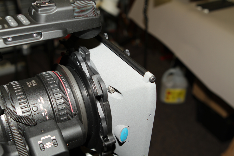

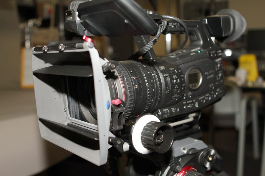

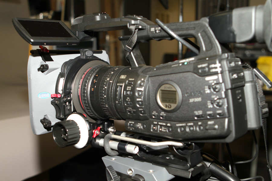

I have used several matte boxes, inluding Chrosziel, Tiffen, Genus and CaVision. Currently I have a Vocas on my Canon XF305, and it's really is nice!
The parts were a little hard to get together here in the US, but it was well worth the money and time waiting. The MB-250 matte box has the ears inside the front that close down, and you'd be surprised at how often these can be used to shade the lens - without the need for an additional eyebrow. Attached, I can turn the rotating filter drawer around (to set a polarizer), It does have to be rotated to the camera right to pull the tray out. The back, non-rotating tray must be dropped through the bottom to remove. The rails do not interfere, but the mic on the camera prevents taking it out the top.
I use the MBS-100 rail support. It mounts to the camera nicely, and lets me keep the follow-focus on the rig while I can pull it from the tripos to do hand held work. The follow focus is nice too, with the new gear Vocas has, it locks nicely to the ring Canon has onthe lens. I like the FF fitting underneath the lens, because it keeps the unit compact and out of the way.
I lkie the Vocas because I also have the adapter rings to fit the matte box onto my Canon lenses for use on my DSLR rig. Changing this out is easy, and Vocas has engineered nifty little lock down tabs to make it clamp to the rail system or calmp onto the adapter rings.
Completely configured, I can keep the unit all together and I carry it in a large Kata bag. Depending on the shoot, I used to have to attach the matte box and accessories which took a lot of time and extra cases to lug around. Now it is all in one nice "package."
Like all good matteboxs, the system is not cheap, but I feel you get a very quality product for what you pay for. (looks really nice configured with the camera too!)

The Vocas MB-250 on my Canon XF-305
Matte Box Recommendations-canon-xf305-vocas-1.jpg   Matte Box Recommendations-canon-xf305-vocas-2.jpg
Matte Box Recommendations-canon-xf305-vocas-3.jpg   Matte Box Recommendations-canon-xf305-vocas-4.jpg
