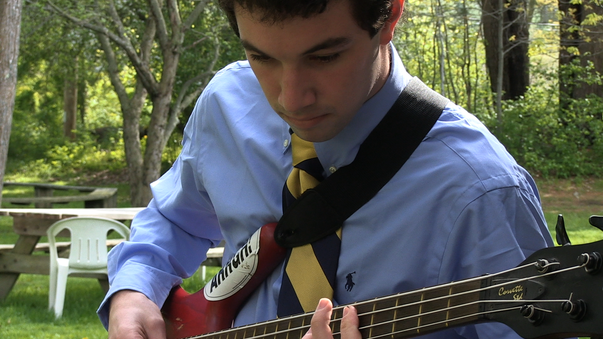

A still image from today. Noisy?
XF100 - how clean / noisy is the image?-xf100-still-image.png

I only see the tiny tiny dotted noise when gain begins at 6db, it gets pretty bad at 12db, but Red Giant's Denoiser works like a charm against that.
I don't see any noise at 0 gain either, are you sure your gain was at 0?

I was seeing noise even at -3 db in daylight when I had sharpness at +2 while shooting landscapes with lots of detail and some motion. I now shoot with sharpness at -8 and I'm not seeing the spidery noise anymore. Image resolution has not suffered at all. In fact, without the sharpening artifacts and occasional noise, the image appears to have more resolution and is much more natural looking. Very smooth...

You got it, number 1 rule for all HD cameras, turn the sharpness way down
