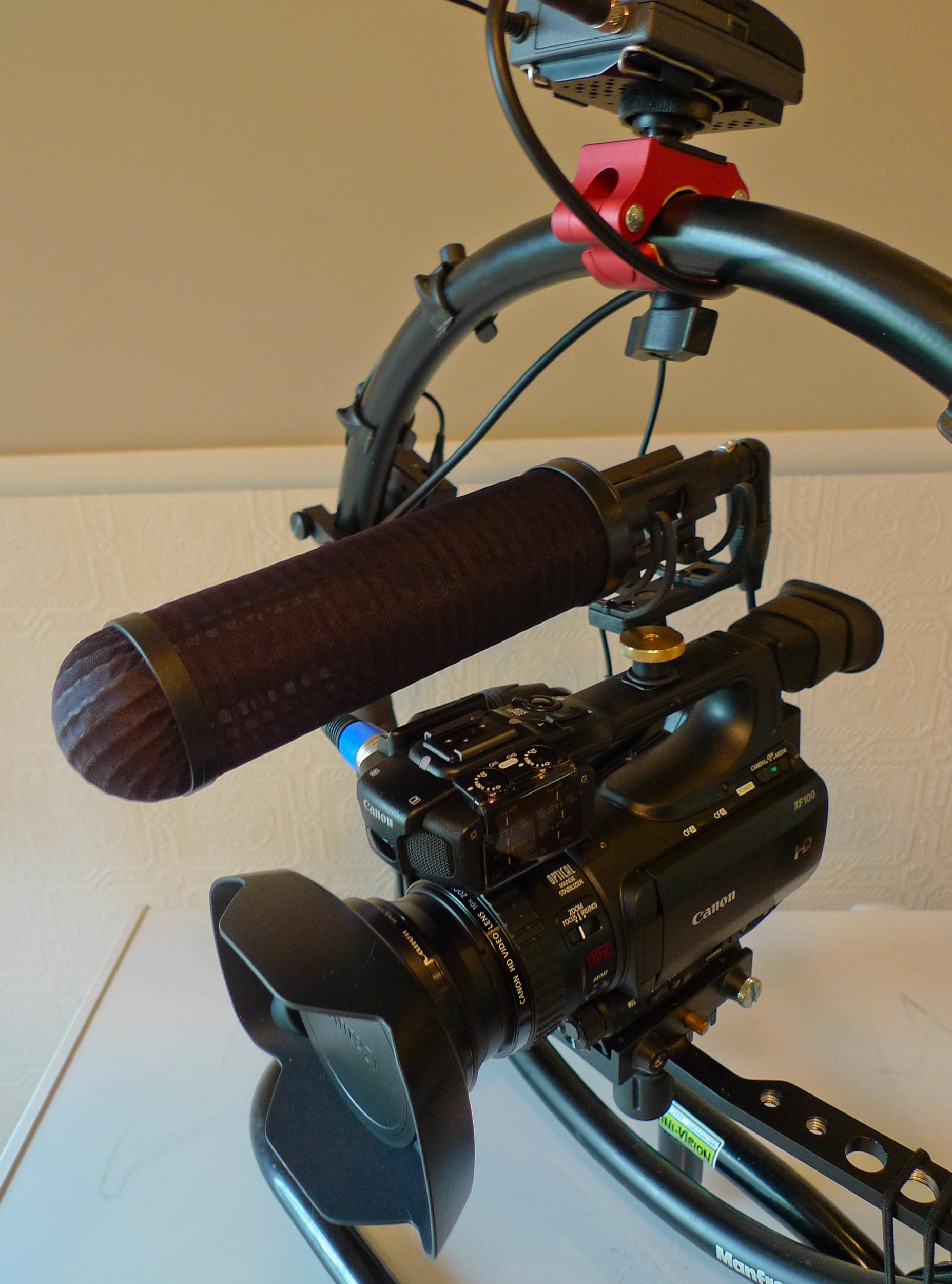

For those who want to put a shotgun mic on your XF100, this is pretty slick.
Everything I had "in stock" didn't work utilizing the Canon mic holder, the mic stuck way too far out in front of the camera. Moving the mount to the handle screw is the logical conclusion and the Rycote Invision Kit fit the bill quite nicely.
The camera is small. Outfitted with the WA adapter the XF100 is still a little shorter than the Sennheiser 416 with a right angle XLR cable and windshield. The mount is very adjustable,(more so as a shoe mount) and the kit came with a Windjammer, hot shoe extension and a few other interesting pieces. There's enough there to figure out a way to mount your wireless receiver also, I'm sure.
Here's the link and a photo
http://www.bhphotovideo.com/c/product/668031-REG/Rycote_116002_InVision_Universal_Camera_Kit.html

Actually, it's an 0.8X Canon lens and it's different than the old one I had, of course. The camera without the lens hangs in a "nose up" position and with the WA lens it hangs perfectly off your index finger. Great addition to the kit and balances the camera like it was made that way and yes it is a zoom through.
The mic is on a slight tangent on the right side, when you use the stud in the handle mounting it directly over the handle isn't possible. . It would need some kind of riser and mounting on the left obscured the LCD screen. I like this camera more every day.

The WA never comes off the camera, for my style of shooting I need wide. On paper it doesn't seem like a big difference (30 to 24) but it’s a marked improvement. Since “on location” for me often times is a boat, it helps a lot. I leave it on the widest setting and move the camera and rarely touch the zoom rocker on the lanc controller, just start or stop. The distortion on this lens I would rate as good, just be aware of the horizon when framing.
I do lots of interviews of groups of people and wireless mics are impractical. With a wide angle it allows me to get closer making it easier to get good clean audio with a shotgun or stereo mic. These are same day edits that I post on my web site and the last thing I want to do is try and clean up bad audio after a long day. It still happens but much less frequently.
