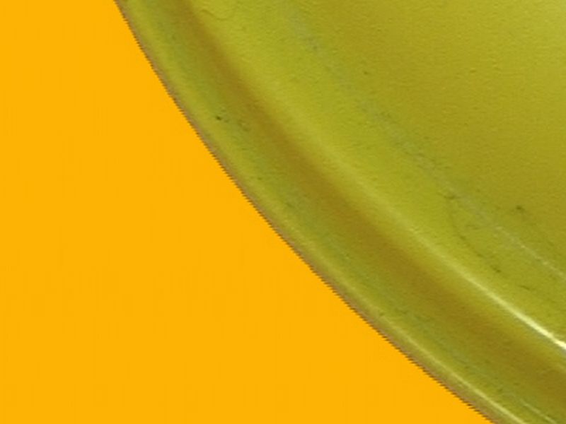

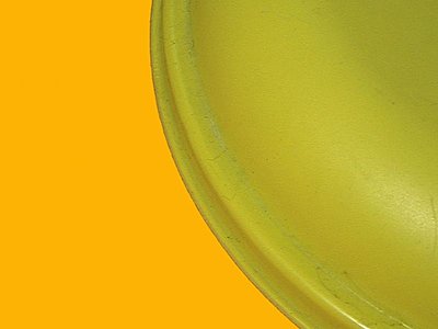

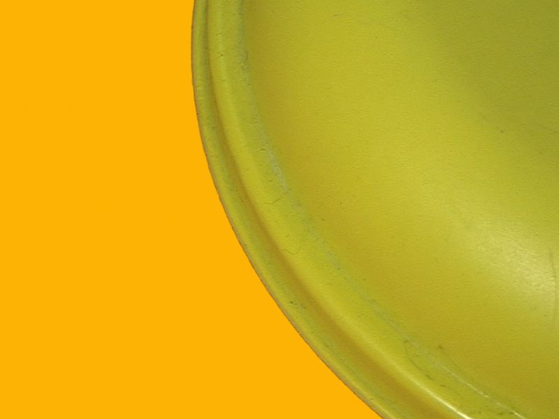

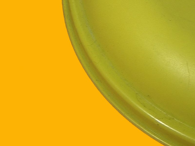

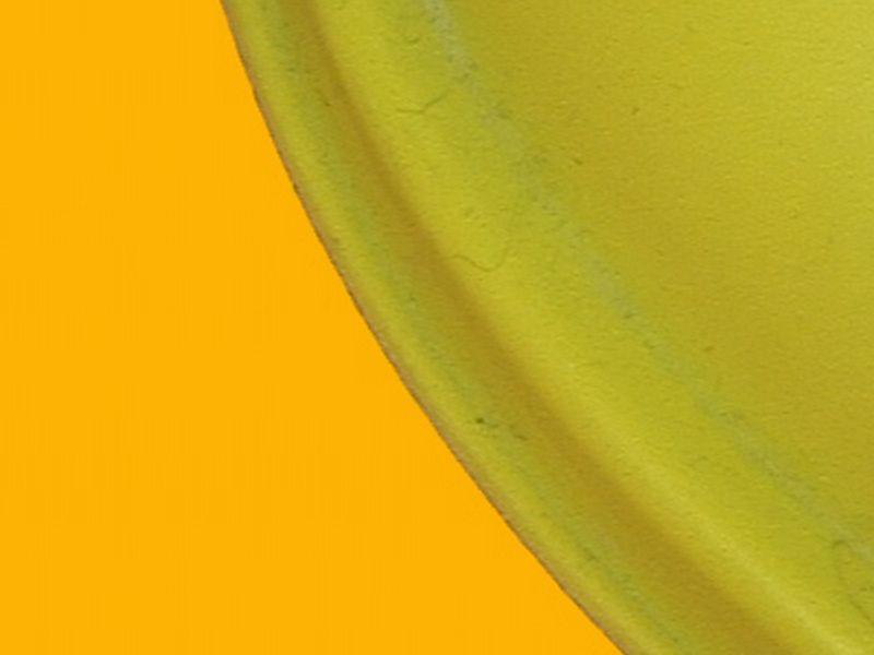

I did a test of the XF100, 422 vs 420 with chroma key (Avid MC) at 1920x1080/50i (without any moving, there is no interlace issue).
There is a noticable difference, the "422" looks ok (i know that it is computed by de-bayering from 420 BAYER, from 1920x540 green, 960x540 red and 960x540 blue, but it is ok).
XF100 - 422 vs 420 chroma key-001_xf100_klicovani_422_crop.jpg   XF100 - 422 vs 420 chroma key-002_xf100_klicovani_420_crop.jpg
XF100 - 422 vs 420 chroma key-006_xf100_klicovani_422_crop_zvetseno.jpg   XF100 - 422 vs 420 chroma key-007_xf100_klicovani_420_crop_zvetseno.jpg

XF100 is not the king in chromakey, XF300 is much better. I did this test for more information about "debayering" from CMOS with 2mil pixels. I want know if the 422 colors are only "upscalled" from 420 (or if the interpolation durig the debayering gives 422 samples).
I think that this interpolation gives 422 precomputed samples, after this easy a chroma key test. The 422 colors are not only "upscalled" during the output compresion .
