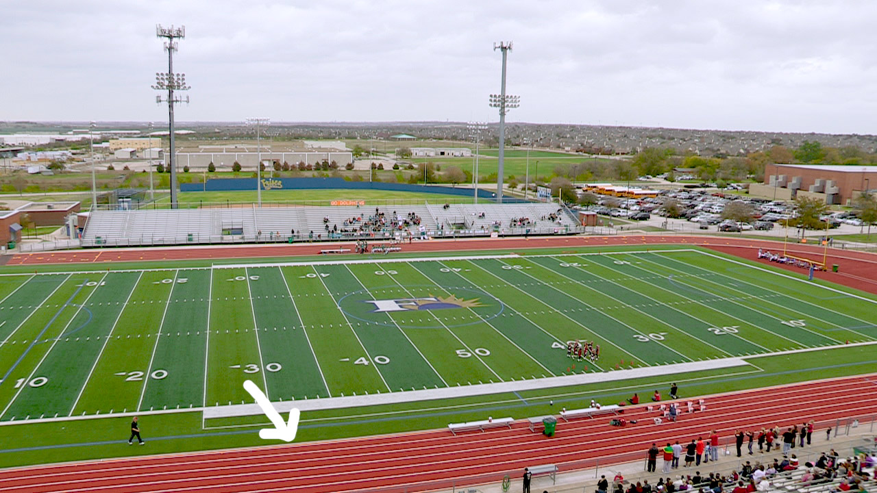

I am getting used to the XF300 and am very happy with the image. But I noticed this from a shot today and wanted to see if this had ever been solved or addressed.
The image has been adjusted in Photoshop to try and get the gamma correct as this is a frame from Edius and the YUV to RGB conversion always kills the image.
The lines on the track are showing horrible aliasing. This looks like a poor downconvert. I did not check this in 1080 as I do not film much at lower framerates but it makes me wonder if the 720p mode is hampered by a less than optimal hardware downconvert from 1080p?
Anyway, thanks for your input and I will contact Canon on Monday.

Yes, XF300 has a great mode 1080/50i, 720/50p mode is very bad.

Please talk to as many folks as you can. In speaking with the level II tech yesterday I got the impression they had never heard of 720p aliasing issues. He hinted that no reports from the call volume meant a low chance of anything being done about it.
I just does not make sense to me if the chipset is progressive how this could be introduced when downsampling to 720p. Maybe the chipset is not progressive or maybe the aliasing happens in 1080p as well. I only shot in 720p60 that day.
I would be happy to test more but to be honest, I only want to put the effort out there if Canon is willing to work to fix the problem. No point in going to great lengths only to get a "sorry" at the end of the road.

One thing that helps a lot is increasing the noise reduction. This happens before scaling and if you take it to 10 the 720p will be pretty clean.
