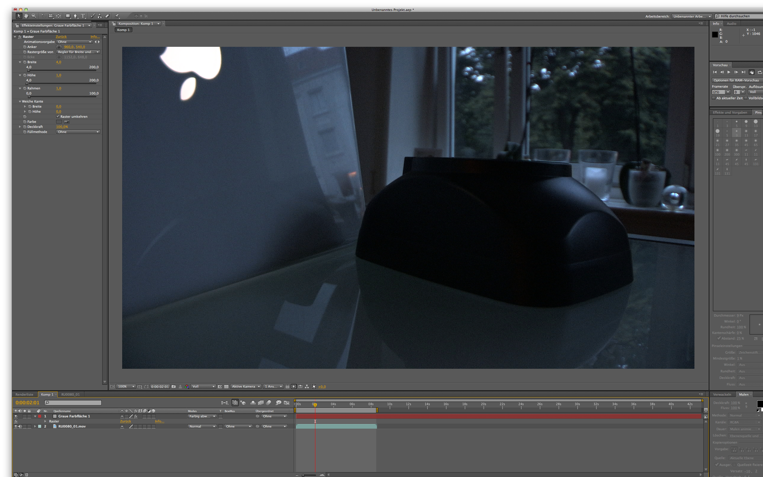

Glad you've brought this topic up. My XF300 shows a horizontal line pattern as well (more visible in the shadow area – see attached screenshot). Don't want to pull away from your thread, but I'd like to refer to my previous thread about this issue.
http://www.dvinfo.net/forum/canon-xf...n-visible.html

Images: 18
Re: XF300 Pattern issue with video
Now I'm really starting to wonder whether I'm going blind..................
If there's a horizontal pattern in that last screen shot that isn't because it's only a 1080, I'm stuffed if I can see it.
Come on, folks, is this real or are you just making it up to keep the forum going?
Sorry for messing this up, maybe I should have called the pattern „vertical“, it seems as if every second line (out of 1920, from top to bottom) differs in luminance value.
Happy New Year, Matt!
I have to admit the pattern is not that pronounced in the original frame and most often subtle in „real world shooting“. To point out the issue to Canon I've emphasized the effect on this very frame by setting up an AE composition.
