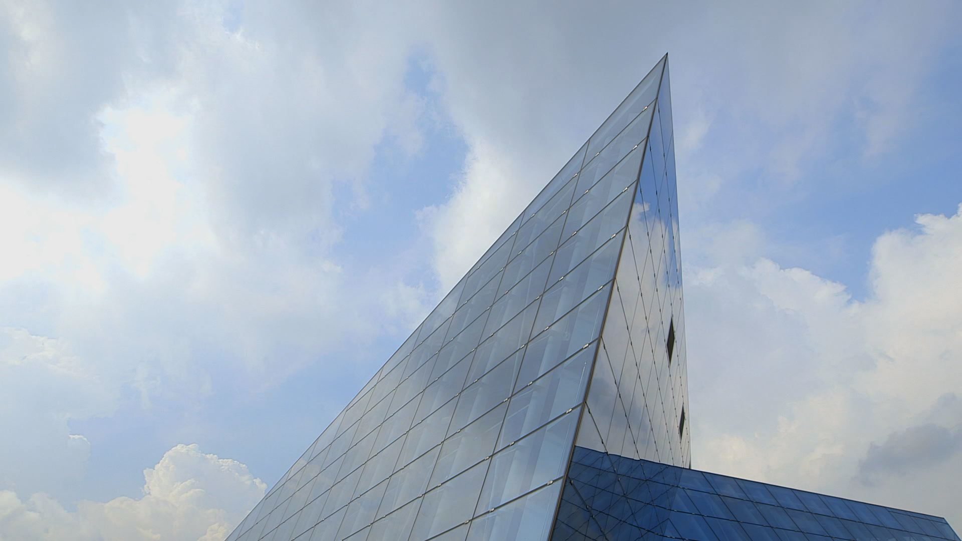

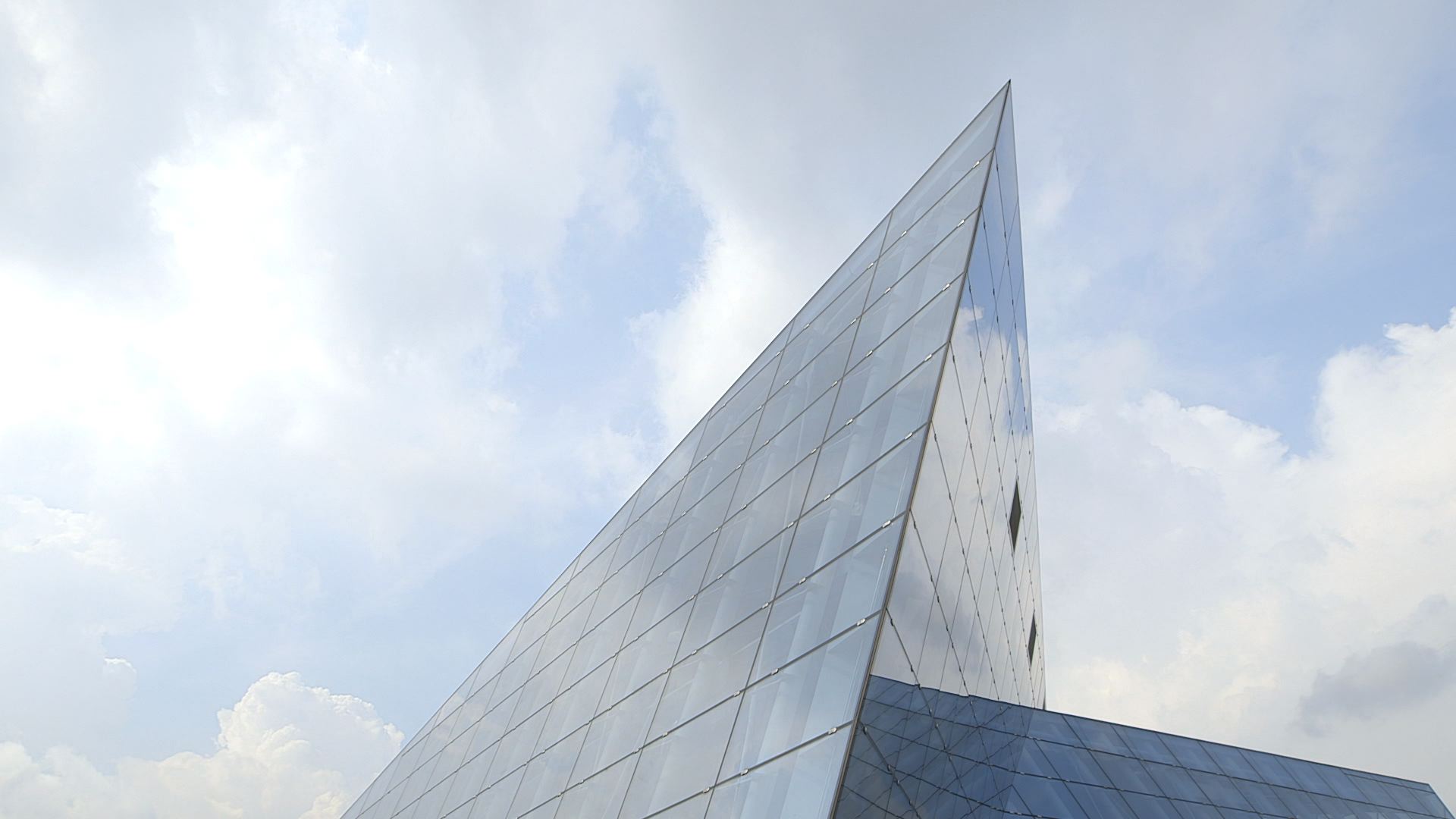

Its no sin at all to go over 100%. Coming from a broadcast background it has been common-place for cameras to record a 104% signal which is then brought back in the edit. As such NLE's are well-suited to deal with such a signal.
If you have Final Cut do some tests - record some footage of landscapes/urban scapes (with nice white fluffy clouds), or a similar subject with nice white areas where you want to retain the info, play with the aperture a bit to allow parts to go over 100%, then pop it into Final Cut. Then do a basic colour correction - using something like the 3-way colour correction, and bring down the whites to broadcast-safe, and see how some detail is brought back into the highlights. NB: not necessarily ALL info is brought back.
Yes, there may be some 'crushing' going on, but its not noticeable, and its certainly better to have the extra detail than to lose it.
I've attached a couple of jpegs to help illustrate the point. Look at the highlights in the clouds on the left.
Cheers,
Chris
