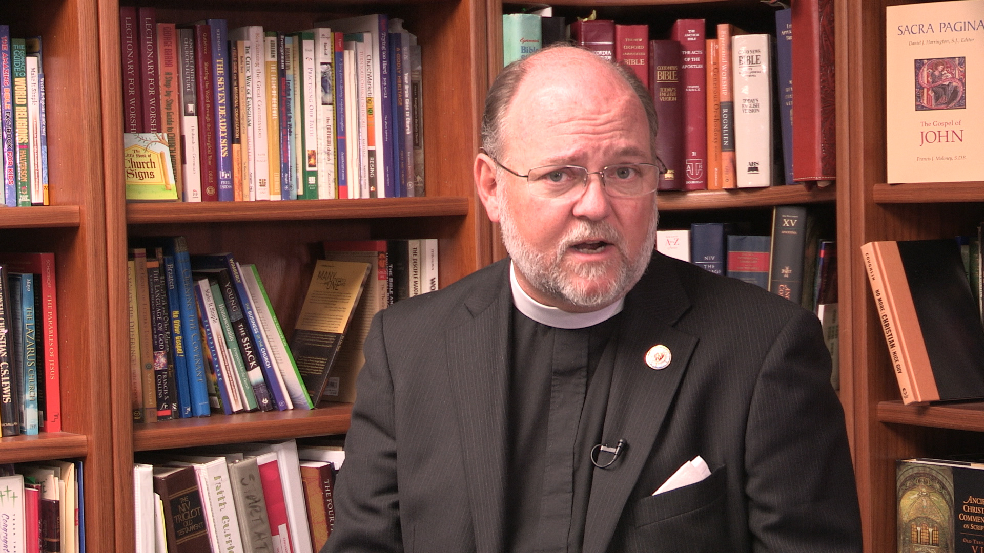

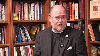

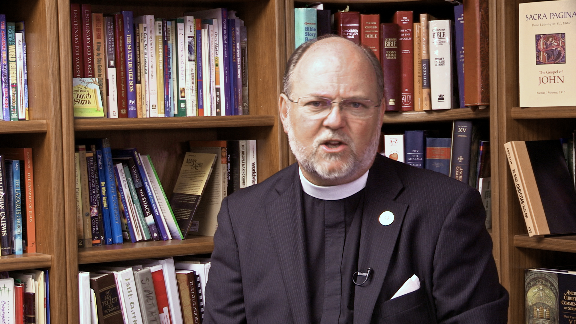

I attached (I hope!) some frame grabs of what I did wrong on my last interview - all auto, Mojo CP, warm balanced with 1/4 warm card - a DISASTER!. It took me a LONG DARNED TIME to get it at all usable - and as a photographer, I'm still not happy with the file-seems a bit crunchy, and I can see where the original was blown out, especially in the red channel. It feels like I'm trying to color correct a jpg file that already has the color, white balance and so on cooked in. If you screw it up, it is a PAIN to get it back.

Larry, I think your focussing needs some tweaking too, have a look at the vicars face in the corrected shot in particular. On the XF series they have a fantastic tool to help you with critical focussing. It is called peaking, have a look at this thread for some interesting comments. http://www.dvinfo.net/forum/canon-xf...non-xf300.html
There are so many things to check as you appreciate so any help you get on these forums are only an another asset provided you take them as constructive feedback :)

I went back and played the video and focus is ok. I think what you're seeing is the low res of a frame grab and maybe a little motion blur. I was actually using face recognition focus, and it works really pretty well on a close subject like this.
I had shot him before using a 5DII (and 24-105L lens) and he drove me a little nuts - he moves around quit a bit-rocking back and forth as he speaks (I learned NOT to let him sit on a chair that rocks, moves or creaks at all! The sound issues ruined a couple of takes).
The facial recognition tracking on the XF300 was a real benefit here - it just didn't come across in the screen grab well. I went back and looked at the footage on Canon's XF utility, which shows a marker whenever the face recognition kicks in - it was tracking him really well, and I remember shooting him and watching the tracking squares. It locked on him well, much better than I could have manually! But I DIDN'T have peaking on - that would, as you say, been a good check to make sure it was locking on.
I THINK for an interview shot or a ENG-type shot with one or two people in the shot, facial recognition works well. For a more formal and complicated shot, throwing it on manual focus is, I agree, the way to go. Beyond that, plotting the scene out with follow focus markings on the focus ring (or a follow focus device rigged on the camera) would be preferable. For landscape shots, FOR SURE peaking... closeups of a person or a few people (especially a "rocker"!), maybe ok to use FR.
I DID one interview of two people and FR kept switching from the person who was talking to the other person, and I had to keep using "Select Face" to keep it on the right person (happened maybe 5x in a 10 minute interview - so, not too bad).
Alan - have you tried the facial recognition focus? What do you think about it?
