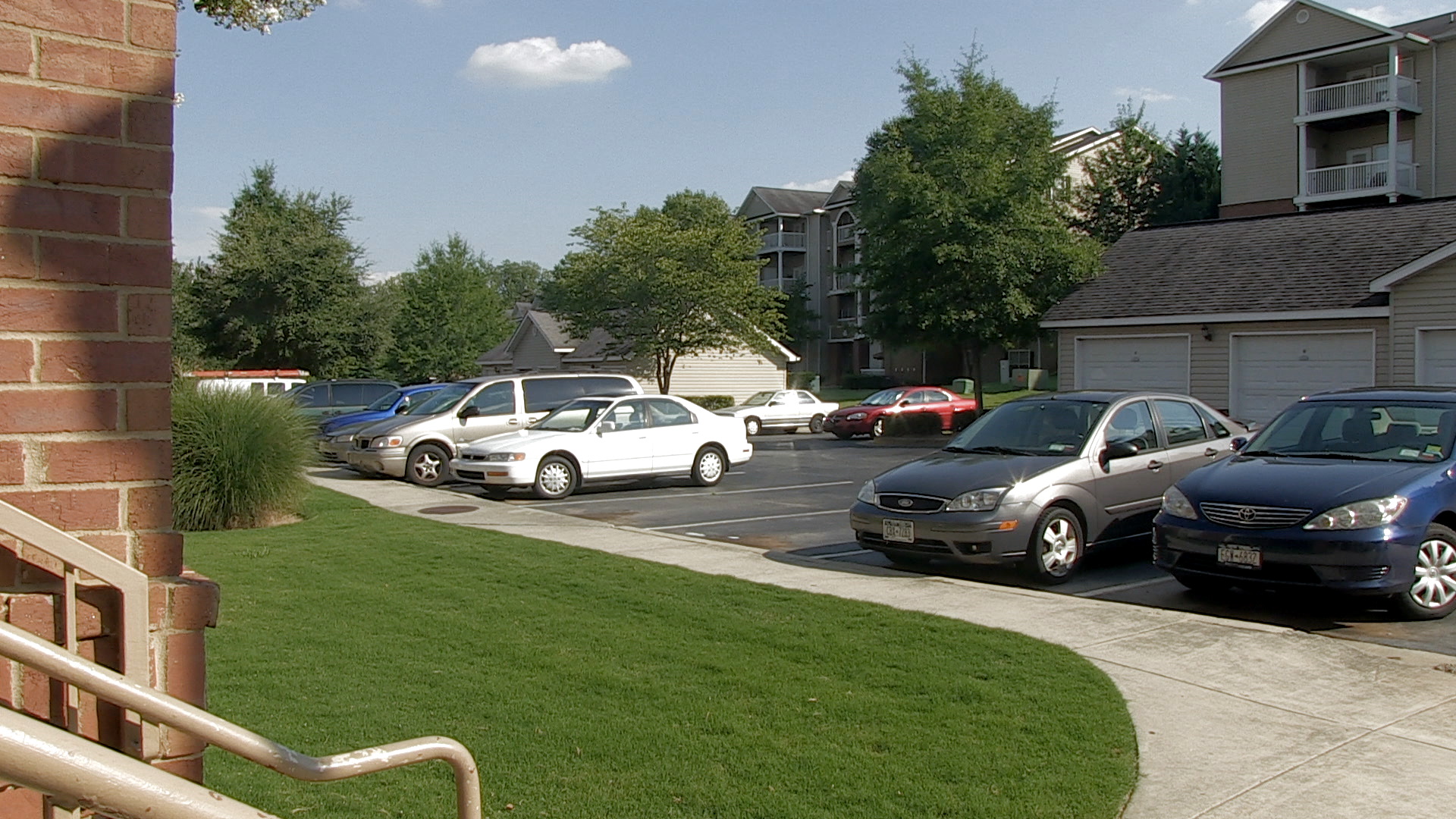

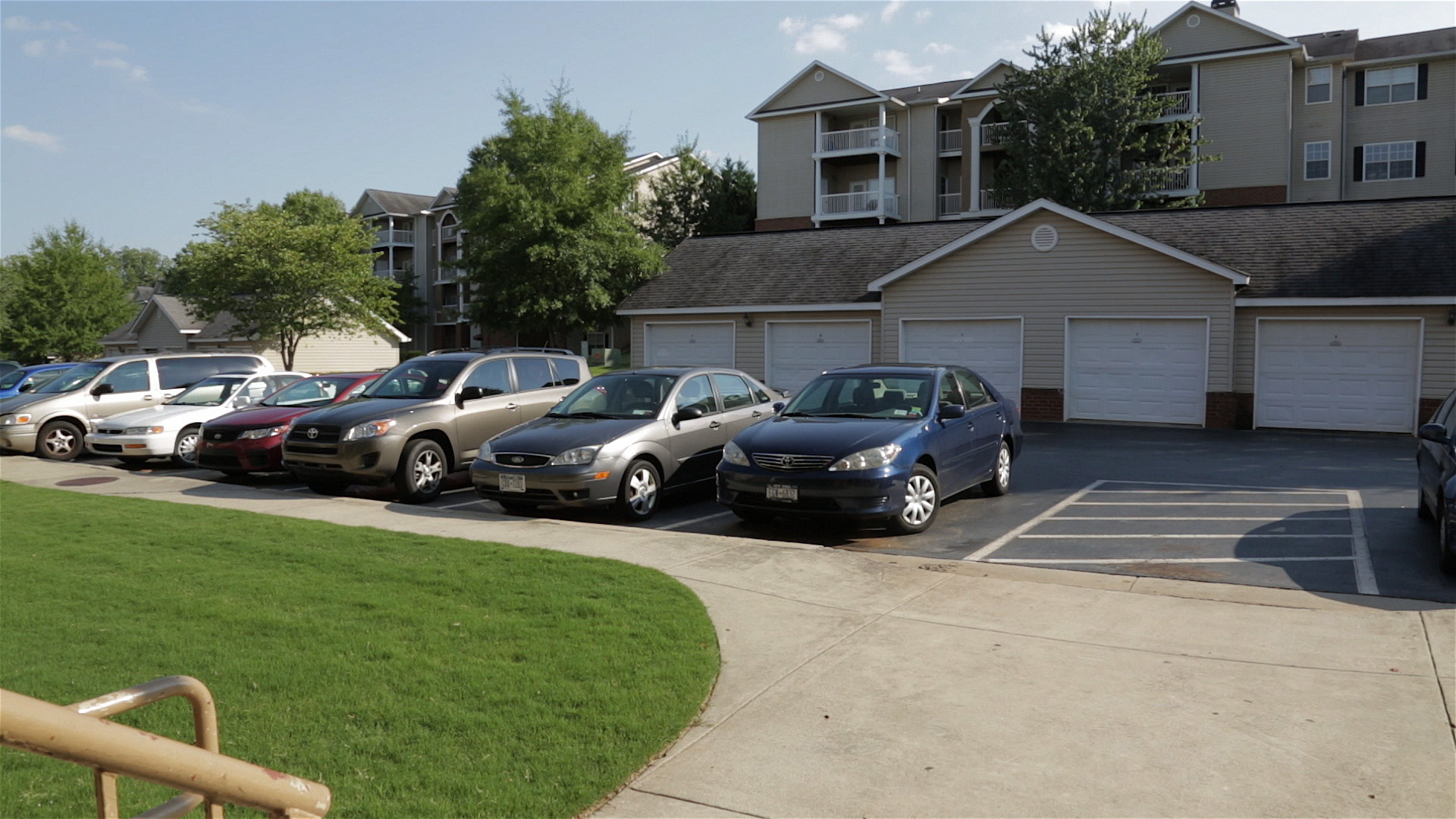

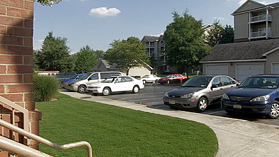

I got an XF100 about a week ago and have used it on one shoot so far and have done some of my own tests. I gotta say I wasn't very impressed with the footage. Using it is a joy, but I'm really not liking what I see when I get home. The codec itself is robust and holds up to a lot of CC, but am I the only one who finds it to be very inefficient during motion? I must be nuts because I know this codec is better then this. Yes, I've check to make sure I'm in 1080p 50mb/s mode (24p), and yes my gain is turned down and automatic gain is off. I've tried lots of different settings and have gotten some decent footage by now, but I'm still unimpressed by its quality. Details in the background are absolutely lost in the compression. I figured this thing had more inherent resolution for the price. I'm sure people are sick of hearing about the little camera and it's not perfect at all, but my hacked GH2 (even un-hacked) kills this thing in a wide and I think that's a shame. I have to keep sharpness at 0 or under to avoid any gross haloing around edges, which look terribly artificial. I had the sharpness turned up on my XHA1 often (not too high but mid-range) and it handled the sharpening with a lot more class then the XF100 seems to.
I took a shot outside to get my 5D matched color-profile wise. It wasn't meant to be a beauty shot, in fact the shot is quite plain and not even exposed that well, but I wasn't concerned about that for this example. I CC'd the XF100 to match the 5D as close as I could get and I got them really close. That wasn't what caught my eye. What did is how much better the 5D shot seemed to look with a tiny bit of post sharpening. I realize the smoothness of the 5D due to DOF and OLPF can be the reasoning here, but it still surprises me. The XF100 shot on playback shows some moire in the siding center frame, and the overall quality of the footage and compression isn't that great. With that tiny bit of post-sharpening, I think the 5D is probably 90%-95% of the way there sharpness wise with the XF100 at full-wide. Look especially at the siding on the garage behind the cars...very different to my eyes.
These are two totally different cameras for two totally different purposes so don't come lobbing nasty comments. The XF100 is actually a very solid camera all things considered. I was a long-time XHA1 owner for many years until early 2012 when I sold it. It was and still is the best piece of gear I've ever owned. I even shot a feature with it that hit Redbox this last Spring. I might have been expecting too much from the XF100. I was hoping it was going to be a big step up from the XHA1 but I guess that was foolish of me. The footage is cleaner, but things just seem muddier to me. It might be the added noise of the XHA1 and how that helped give the footage a more organic look instead of a digital look, but I'm not sure. I find myself missing my A1...
Bang for buck I guess it's not that bad, but as I have a few shoots coming up I don't really have a lot of confidence in using it. If I absolutely need ENG and I can't get around it any other way, I'll definitely pull it out of the bag but otherwise I think it'll stay in there more then it should...and that makes me disappointed.
I'll be using the camera more to try and see if I can get the hang of it. There's no way it's as bad as it currently seems because too many seem very happy with it. "Best in its class" is what I hear often. The XHA1 felt pretty crummy until I used Steven D.'s Panalook preset, but every attempt to try and emulate that on the XF100 in-camera has failed. If anyone has any suggestions in that regard I'm ALL EARS.

The XF100 shot looks fine to me and even the grass is a bit sharper. I can't see the problem in the siding you mentioned. The shots are slightly different focal length so that's not helping the comparison. They are nearly identical as far as I can tell. (BTW - technically I'm color blind... in case that matters.)

Kyle: I have both a 7D, a 100 and a 305. I would assume that comparing a 5D and a 100 would likely result in not the best comparison for the 100. It appears to me that the given the choice between the 305 and the 105, the 105 is the B camera. There is lots to not like on it compared to the 305. I bought my xf105 as a B camera for the 305, and am still understanding it's limitations. Let's take your points one by one...inline
Originally Posted by Kyle Prohaska View Post
...(some snipped) I'm just curious what people think given my experience thus far.
...I gotta say I wasn't very impressed with the footage..
Al says: Compared to a 5D or a GH2, I would have to agree. The larger sensors produce beautiful images out of the camera and this smaller xf100 single sensor cannot totally compete for footage one to one, especially at higher ISOs/lower light. But for many shots, including outdoors, properly white balanced and exposed, then used on the Internet at full screen, can be just fine for 90% of my shooting. Would love to see you post some side by sides of something other than a car park (G). The xf30x produces a much better image, and allows much better control. And to be fair, I've shot bad footage in low light with my 7D as well. It can be very ugly in the wrong ISO, and in the wrong light (especially fluorescent).
I have worked a lot on setting custom picture profiles and agree that you have to find the right one for your lighting needs, including the kind of daylight you have where you live. The BBC settings are my default. I work from there as needed. CC is a standard for me in post.
Kyle: The codec itself is robust and holds up to a lot of CC, but am I the only one who finds it to be very inefficient during motion? Details in the background are absolutely lost in the compression.
Al says: I haven't seen that issue myself. Are you shooting at 24/25p? Maybe see if it changes by going to 30 or higher? Also, there are a lot of shutter options, from 180 degree etc. Be sure to check out your shutter settings carefully in your tests.
Kyle: ...but my hacked GH2 (even un-hacked) kills this thing in a wide and I think that's a shame. I have to keep sharpness at 0 or under to avoid any gross haloing around edges, which look terribly artificial.
Al says: sharpness of Canon cameras like this is usually recommended to be lowered under 0 by most people I've read on this board and elsewhere. Nothing unusual in that, or damning in and of itself, I'd say. As to the GH2, it's a fabulous camera, producing beautiful but contrasty AVCHD footage. I used to own an HMC150, and liked it a lot. But the AVCHD format with this large sensor is beautiful out of the camera. No question there. Maybe the best quality I've seen. I have used it together with my 305 on some shoots, as a local shooter has helped me and has one. Lovely stuff. You won't match that footage on a single small sensor xf100, in general, I'd say. But to be clear, I am always toning down the GH2 footage when matching with the 305. I prefer to have a softer look. The GH2, out of the camera, seems too sharp, a bit unreal. Not very *filmic* I'd say.
Kyle: What did is how much better the 5D shot seemed to look with a tiny bit of post sharpening.
Al: To be expected, I'd say. The MOV format on Canon seems a bit soft overall, both on the 5's and the 7Ds. Not that they are *soft focused* but that it just doesn't seem as contrasty as the AVCHD does. Then again, it could be your lens.
Kyle: I realize the smoothness of the 5D due to DOF and OLPF can be the reasoning here, but it still surprises me.
Al: It's something I've come to learn about the 7D. But I don't think it is for the reasons you think. I think it's more the MOV format. It's just not a great container married with the H.264 as they do. I'd take MXF any time. It seems to be perfect only if you always work with Apple computers. It's been problematic for me as I've shifted to Windows and Adobe or even Vegas (which I use at times for fast and dirty jobs).
Kyle: These are two totally different cameras for two totally different purposes so don't come lobbing nasty comments. The XF100 is actually a very solid camera all things considered. I might have been expecting too much from the XF100.
Al: I think so.
Kyle: If I absolutely need ENG and I can't get around it any other way, I'll definitely pull it out of the bag but otherwise I think it'll stay in there more then it should...and that makes me disappointed.
I'll be using the camera more to try and see if I can get the hang of it. There's no way it's as bad as it currently seems because too many seem very happy with it. "Best in its class" is what I hear often. If anyone has any suggestions in that regard I'm ALL EARS.
Al: I think that it's a tool, and like all tools, has it pros and cons. For interviews it's great. An ENG camera of that size that produces great footage, when well lit, and is self contained. I don't need to worry about Canon DSLR AGC issues, I can plug any old mic in and it works (love having a mini jack as well as XLR, my 305 doesn't have that!
If I was trying to make it my only tool, I'd invest in a neutral density filter, and shut off the horrible ND dial. It's really terrible, IMHO. If they only threw in the slider ND like on the xf30x, It would be a near perfect camera, barring the small sensor. The range of the zoom is another reason I grab for the 305 over it. I have managed to get the two zoom controls set so that the handle is the fast zoom in to focus, and the grip is the slow crawl. Works for me like a charm.
Spend some more time with it, though. Not sure you have spent enough time to become fully up to speed on it's ability. But you, like me, are probably going to reach for our 7D/5D/GH2 for normal footage when not needing an elaborate mic setup, long running video for performance/lecture, or smooth zooms. Hmm. That's a lot of my shooting, which is why I have ENG style tools in my bag.
This weekend, I'm shooting some clubs with blues. I'll do the first night with my 7D, and the second with my 100. Maybe I can show some similar setups with similar bad lighting. Would be instructive to all of us, I'd say.
