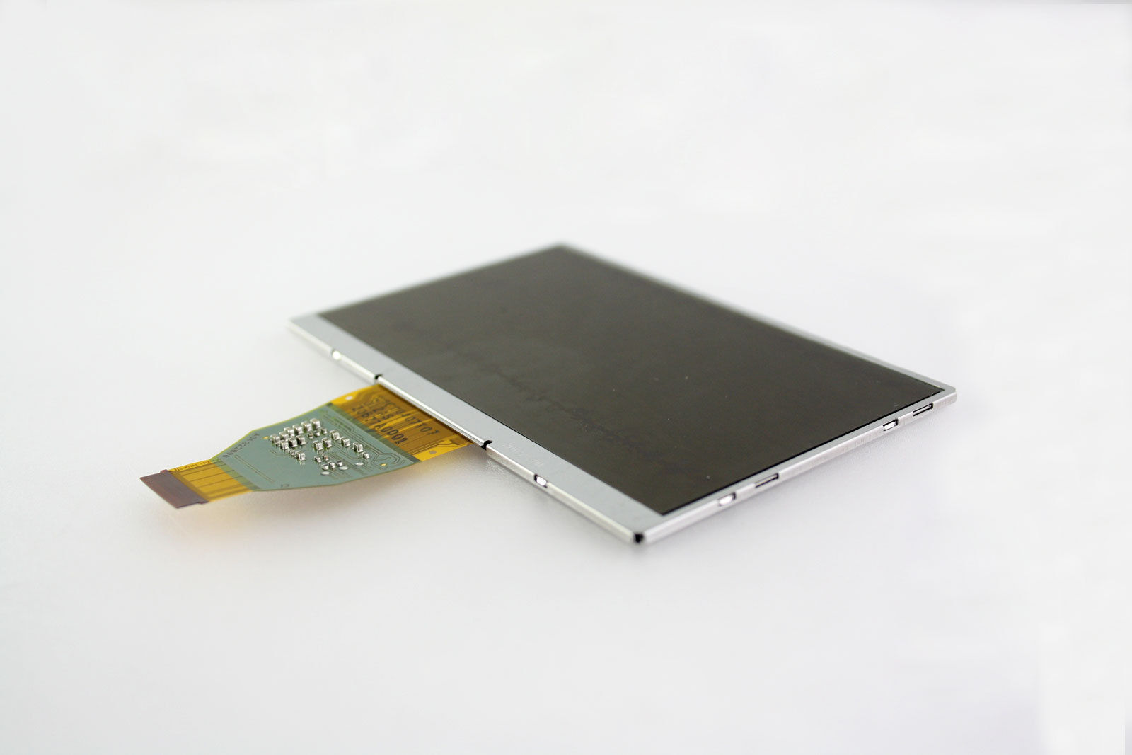

Someone is selling an LCD on E-Bay for $200.
LCD Screen Display Part for Canon XF300 XF305 Video Repair New | eBay
Mark
