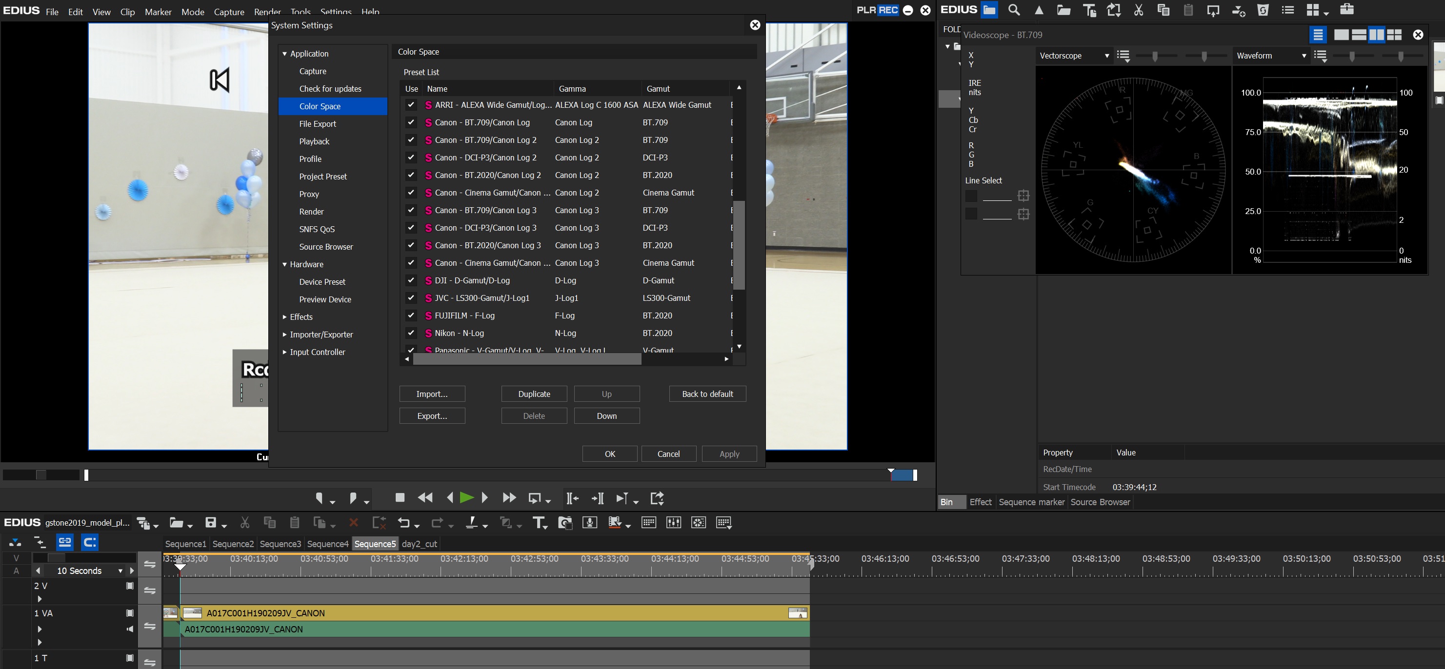

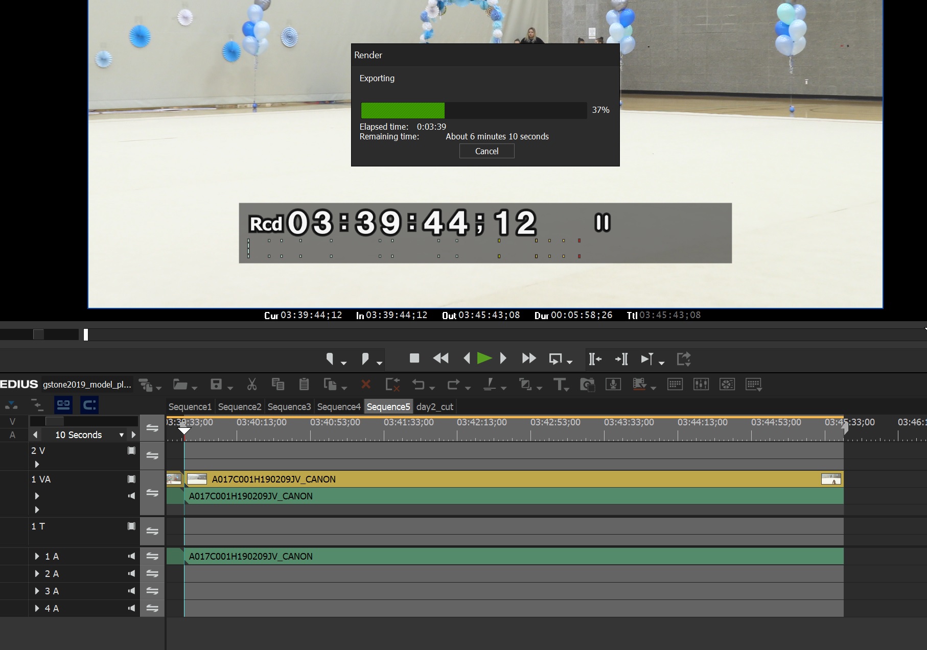

Re: Canon XF705 and H.265
I am using Edius 9 to edit Canon XF705 H.265 4K 160M footage, no transcode needed
Lawrence Kong is offline   Reply With Quote
and Edius 9 support all Canon XF705 color space
709, 2020, canon log3
will try to canon log soon
