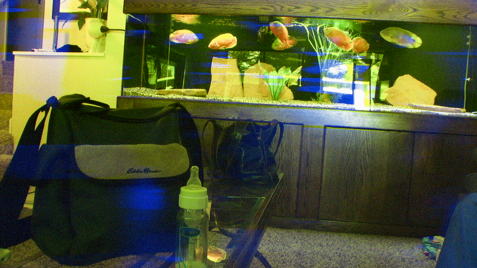

Last night I was shooting some video with my A1. I shot maybe 20 minutes without any problems.
I left the camera on, but not recording, maybe 2 minutes go by. I look into the view finder and the picture looks terrible and there's nothing I can do to adjust it.
I turn the camera off and on. Still looks terrible.
I go to the factory reset option and reset the camera. Still looks terrible.
The 20 minutes of footage I shot before the camera went crazy looks fine. The minute or so I shot while I was troubleshooting looks terrible. It's not just the viewfinder having the problem obviously.
I'll try attaching a still image to show you how it looks. I am going to be sending the camera in for repairs since it's less than a year old and still under warranty. I have a wedding to shoot on September 22. I am scared I won't have it back in time.
Just thought I'd share in case anyone else has seen this.

Isn't that the Van Gogh preset? :D

"Replace 3P Assy clean tape path"
So I guess they replaced something and then cleaned the guts.
The bottom line is the camera is working just fine once again.

Glad you got it sorted, I didn't want to mention it earlier as thought you wouldn't be in the mood for jokes but I was afraid the contents of that baby bottle in the faulty image may have ended up in the camera while you were out of the room :)
