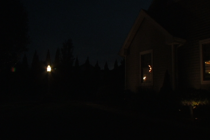

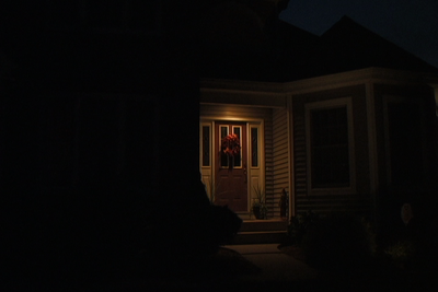

Old October 5th, 2007, 05:17 AM   #25
Location: Central, CT
Posts: 22
A1 Noise
I have same problem with my 1 week old A1. I too cannot replicate the type of quality as I have seen on-line but I am thinking its user error. I dont think its the camera because there are similar complaints from others.
I am importing into Final Cut Express HD through the downconvert setting. My easy setup is set to NTSC DV
I see the same type of grain when pausing the image and sometimes when playing as well. I dont have an HD monitor/tv just my imac G4 screen which is usually really good.
I havent tried the -3db setting.
I tested in really dark areas @ 6db and its ok but not perfect. Tell me what you think or suggest

Old October 5th, 2007, 06:48 AM   #26
Join Date: Sep 2001
Location: Northern VA
Posts: 4,497
Remember it is a video camera, so best to judge actual video, not still frame grabs. In many cases, the video posted as a positive example is something the shooter is proud of, it represents the camcorder and settings at their best.
The files look normal to me, considering you are shooting in the dark. Some folks adjust presets, including NR and coring as an aid in managing noise. This is discussed in a number of other threads and in the presets forum as well. I think you would be well served to browse them.
I think many folks have too high expectations as far as using camcorders (any camcorder) in poor light/the dark, and in the case of the A1, using it as a point-and-shoot out of the box. While it has a point-and-shoot mode, it is not intended as mainly a point-and-shoot camcorder.
Without regard to details of you Mac, in general a PC is a very severe environment in which to view video. Most PC graphics/display systems are not designed or calibrated with video in mind, and the viewing distance is very close, typically arms length.
dpalomaki@dspalomaki.com

Old October 5th, 2007, 10:25 PM   #28
Join Date: Jul 2006
Location: United States
Posts: 306
The pictures I see here are extremely underexposed -- by many stops.
You need to open your iris all the way, slow your shutter speed down, and turn your gain up, in that order, to cope with darkness. But before any of those, add light!
Learn to use your exposure zebras. They're your exposure meter for a video camera. You can't judge your exposure by looking at the lcd screen -- you need the zebras!
Any time you underexpose, it will get nasty. Get the exposures right, first.
Nothing else will help if you don't get the basics right. Don't worry about progressive and profiles and custom settings until you've learned the basics.
This camera shoots beautiful images. But it needs your input to do it.
Chuck Fadely is offline   Reply With Quote
Old October 7th, 2007, 05:52 AM   #29
Posts: 22
I agree its underexposed but that was intentional to try and avoid grain. Iris was all the way up. Gain was +6db. If I went any higher, the image fell apart.
