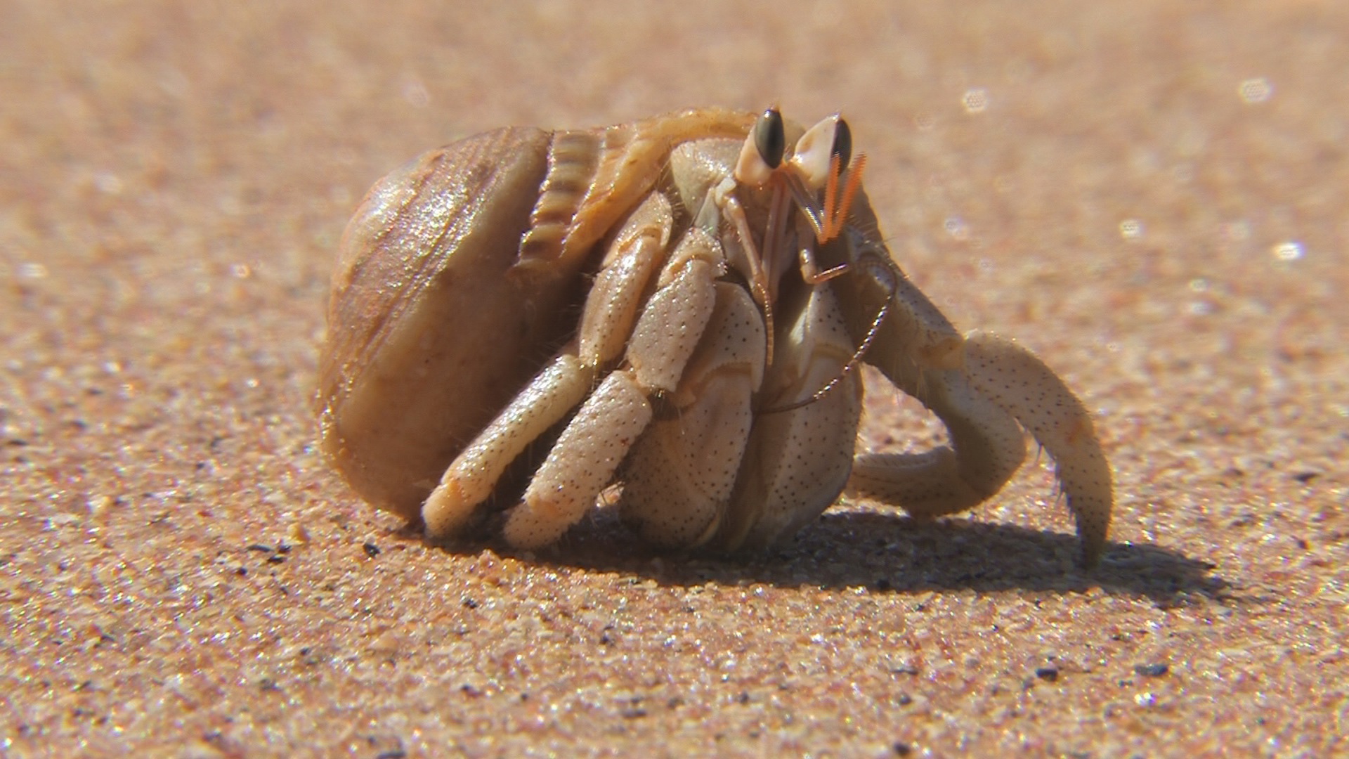

Macro
Here are two photos extracted from a video I did last year. The macro used is a +3. The height of the crab is approx. 1 inch.
Axel
Should I buy the XH-A1 for macro studio shooting?-hermit-crab-1.jpg   Should I buy the XH-A1 for macro studio shooting?-hermit-crab-2.jpg

Axel:
thanks for posting photos. Can you tell me what is the distance between crab and the front of camera : is it a very "close-to shot" or is it a "tele-macro shot", because from my point of view, the tele-macro (at less 70 cm)is the only choice ...

Bonsoir Gaëtan,
sorry for my late answer. I did not have access to the internet for two days.
As to your question to my crab shots, the distance to the crab was about 20 cm and I had zoomed in about 50 % of the zoom range. More details about the macro lens: B+W NL-3. Environment: Beach with bright sunlight. You may want to use a large aperture number to have a bigger focus range. Otherwise most of the tiny object would be out of focus.
Tiago: If you really want to use a general purpose camcorder for your macro shooting, you should also test the achromatic diopters proposed by Jonathan. With my sample photos I just wanted to show that interesting photos also can be made with single lens systems. The single lens macros are much cheaper.
