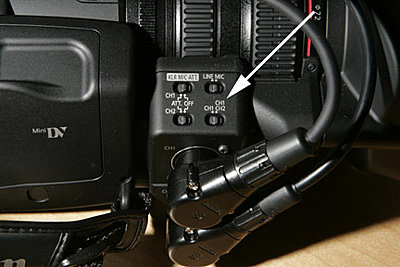

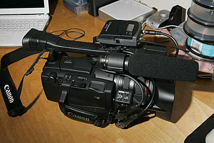

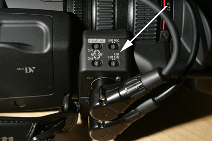

Folks I have a 2 microphone setup, a short shotgun mic and a Sennheiser wireless receiver which I leave both mounted on my camera all the time. In the Ch1 I have plugged in my shotgun mic and in Ch2 I have plugged in the wireless.
My question is this,.. when I want to use only my shotgun mic I slide the XLR switch to Ch1Ch2,.. and when I want to use the wireless and the shotgun mic together, I need to slide the switch to Ch1 "only". I know theirs probably a good reason behind this but does the labeling sound reversed?

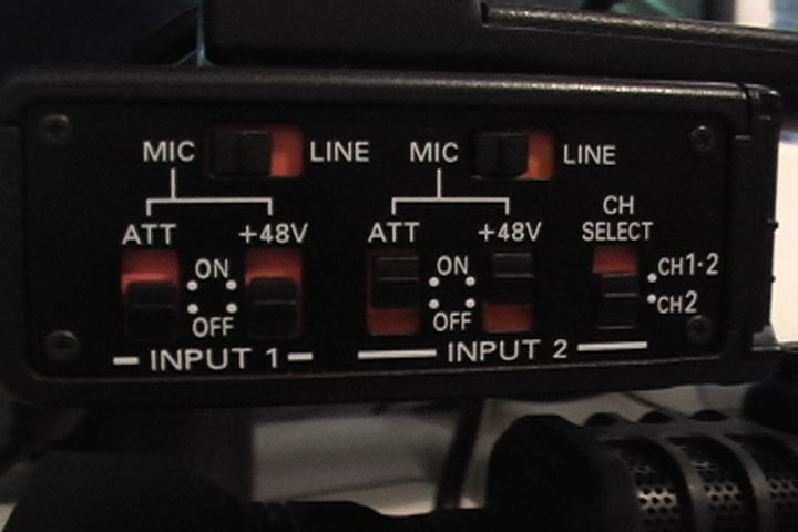

It is the same way on my DVC30. It means that the CH1 XLR input is being split to both channels (Ch1 and Ch2.) I think the Pana markings are a little more obvious. In the Input 2 switch section, it says Ch Select. That indicates where the Input 2 audio is going, to Ch1 and 2 or just Ch 2.
