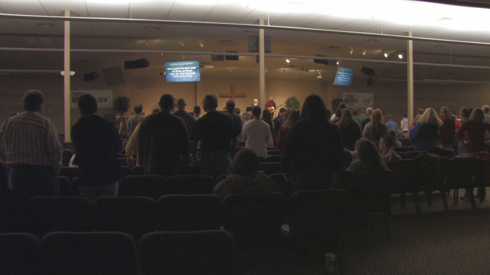

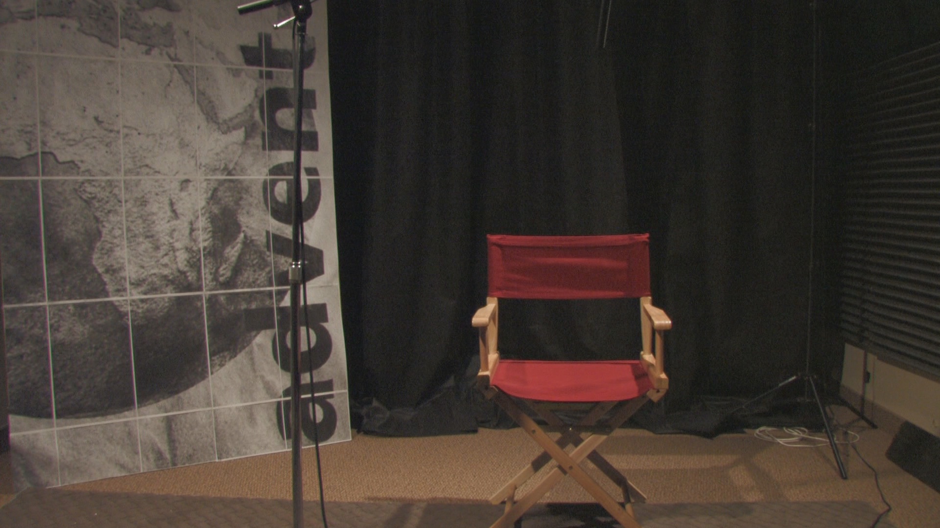

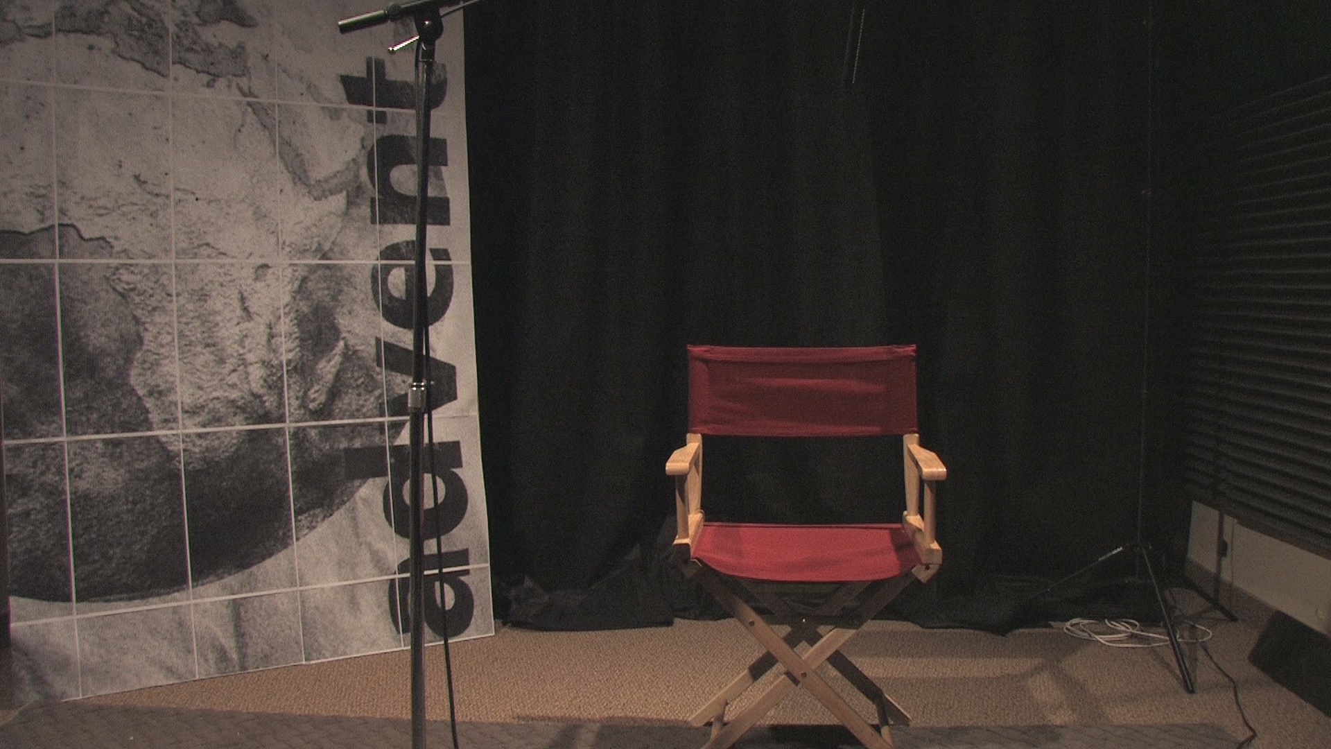

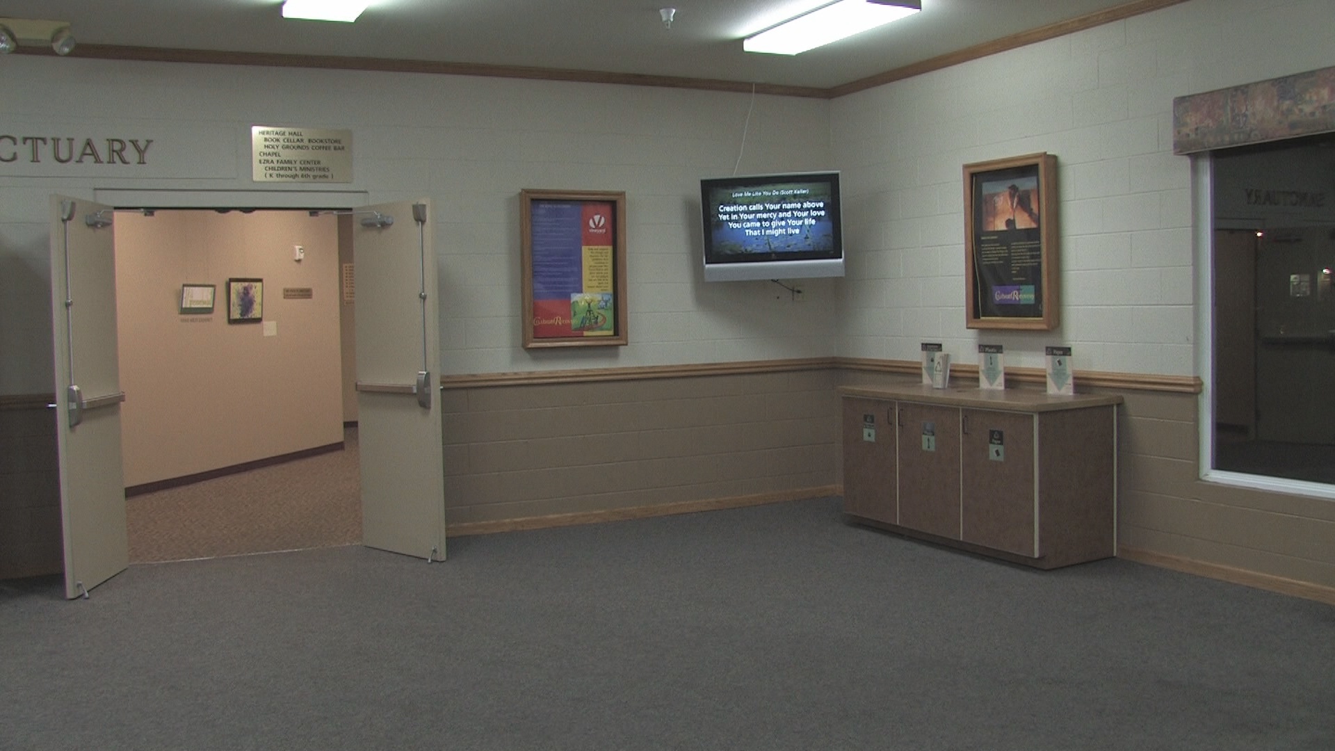

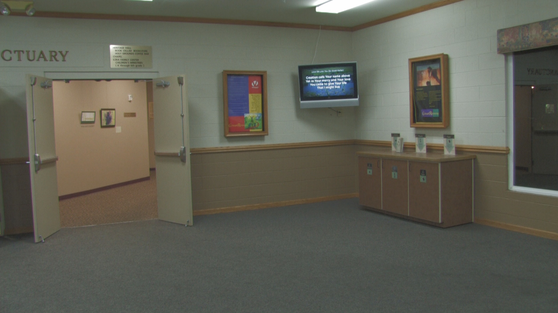

Okay, here's some stills. I ended up turning the overall color gain down, as it was just too much, making me think that individual color gain does in fact control saturation as well (duh). Three different scenarios, all low light with gain at 6db. First I show factory settings, then my cinema mode with color gain. Also, on the cinema mode, sharpening is turned down to -4.
What I'm trying to see is if actual noise is increased, or if I can actually squeeze a bit more juice out of the exposure (again, equalizing it between normal and Cine2 modes so as to be able to shoot in CineGamma and not have the image dark, thereby having to gain up anyway). Thoughts?
EDIT: Out of a hunch, I took two presets, made them both like my cinema preset except had one with R -8 G 0 B0 and the other with R 42 G 50 B 50, then turned overall color gain on both to 0. Even at B&W, when the individual color gains are amped they raise the exposure. So, is this simply meaning that the gain is getting bumped?
