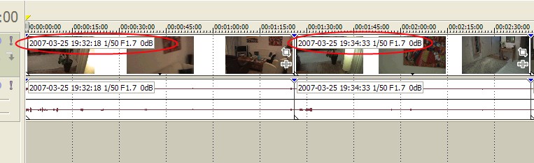

Steven. At home I have a procedure how to capture HDV within Vegas (as one big clip without scene detection) and then let a script do the scene detection. The meaning of that procedure seems to be to avoid 12 secs problems that Vegas seems to have when capturing with scene detection.
If I remember well the scene detection script is able to display all kind of information that is in the footage. Donn't know for sure if the timecode is one of them. I will try to investigate that for you this evening (that will be about 12 hours from now).

Steven, is this the information you are looking for?
Kees van Duijvenbode is offline   Reply With Quote

Old March 27th, 2008, 08:48 AM   #10
Join Date: Oct 2007
Posts: 246
It's done with a tool and a script (for Sony Vegas). The preocedure how to use them is in dutch so I have to translate that first for you. Give me a few days and I will post an answer to your question in english along with the tool and the script.
