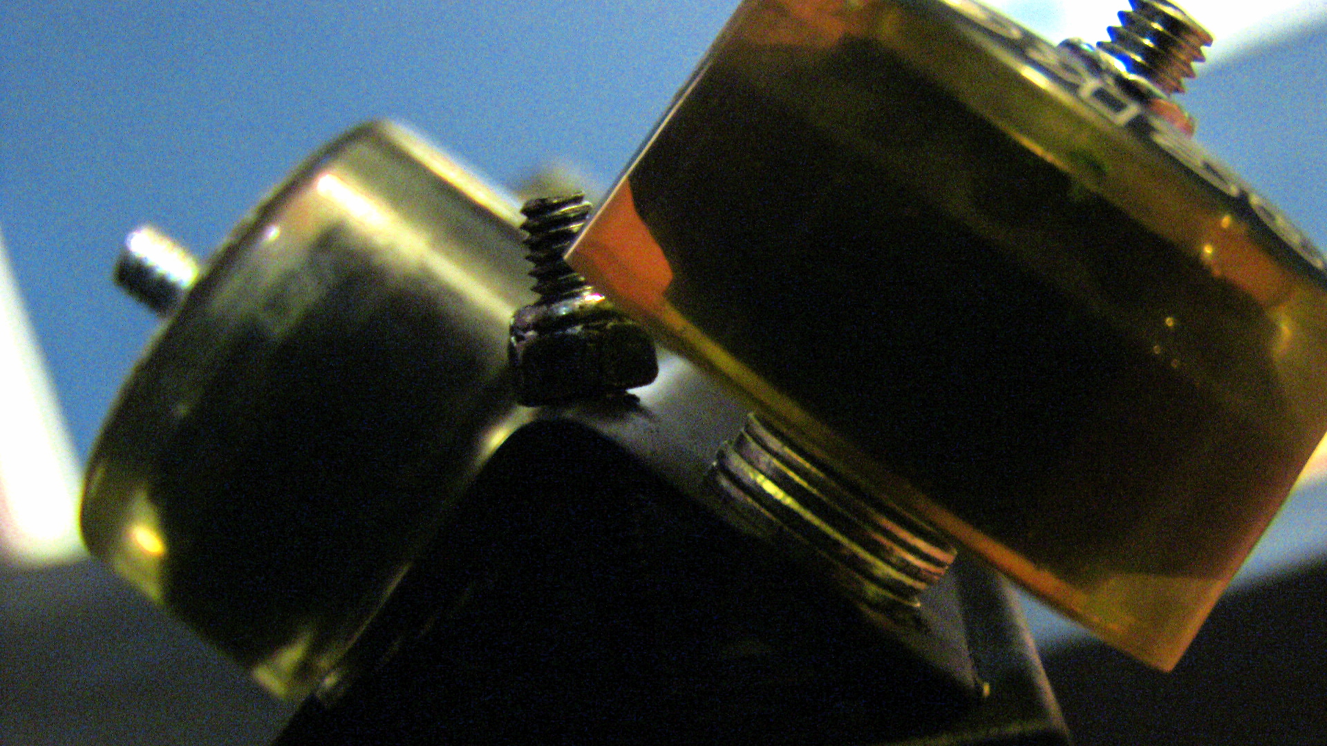

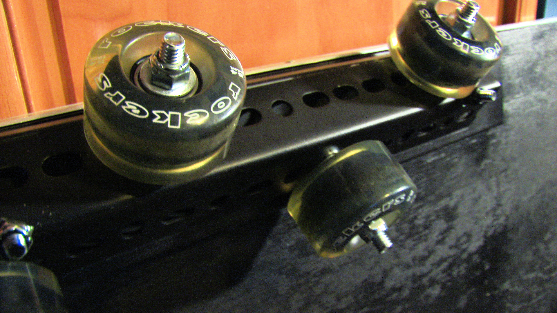

The amazing thing about this dolly is the wheels. I got them here: http://www.skates.com/Pacer-Children...pcltwhl-nl.htm but unfortunately they have got up in price. I got them for $3.99 per 8 pack. They come with ABEC 1 bearings which you would think is terrible. Every place I look everyone recommends ABEC 5 or even 7 for their dollies. But with the insane prices for raw building materials (at least in my area) I tried to cut costs where I could. And it turns out that with 16 wheels ABEC 1's work fine.
I painted the dolly black top and bottom and trimmed it with 3/4" aluminum used at the seams between carpet and hard floors. It looks really professional, especially running on black ABS pipe and with my tripod and camera on it. I'm really happy. I'll post some pictures tomorrow.

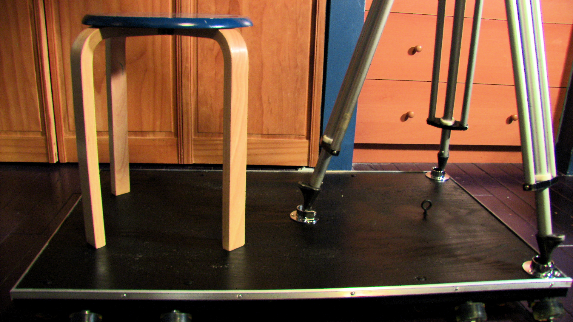

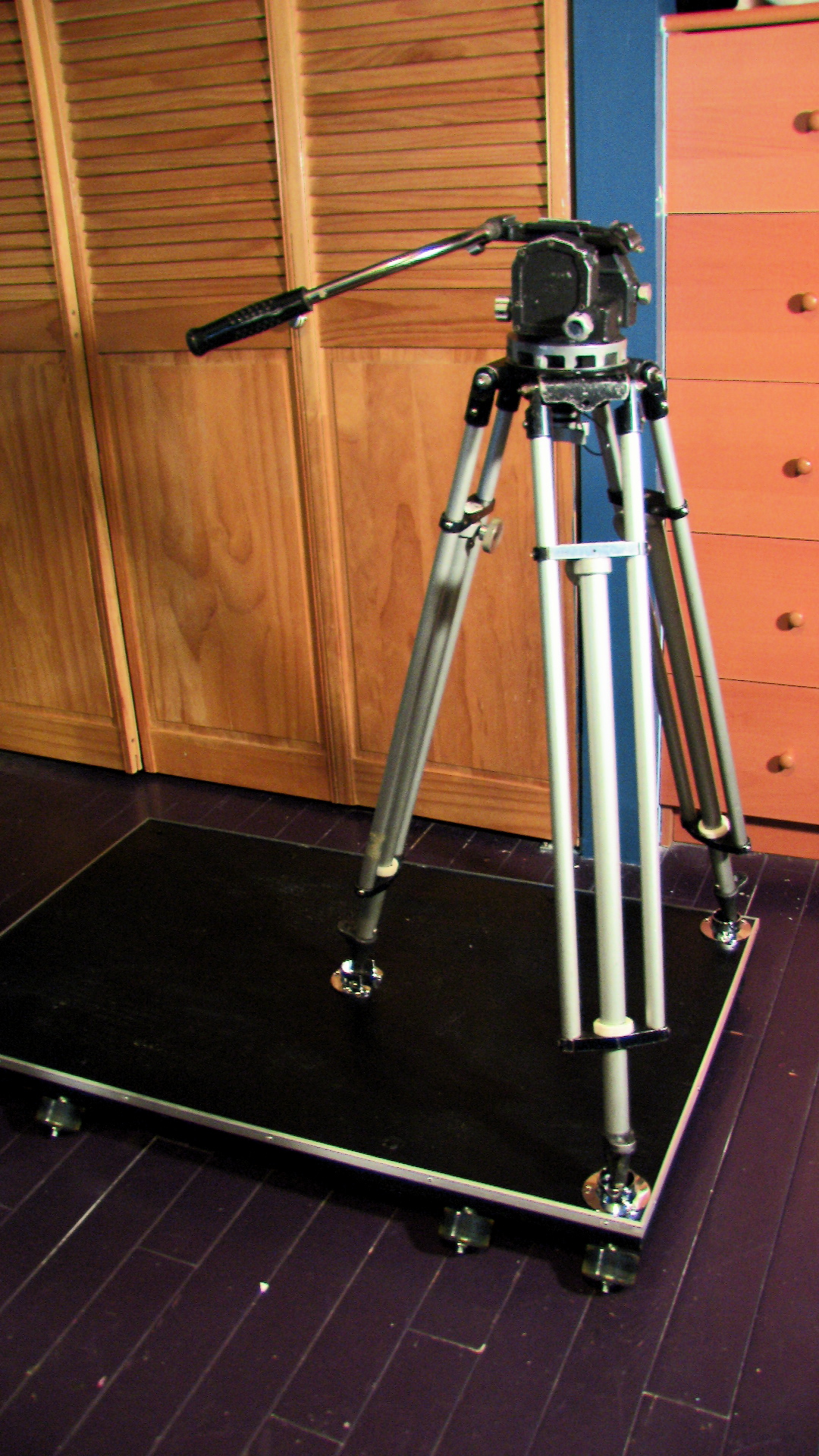

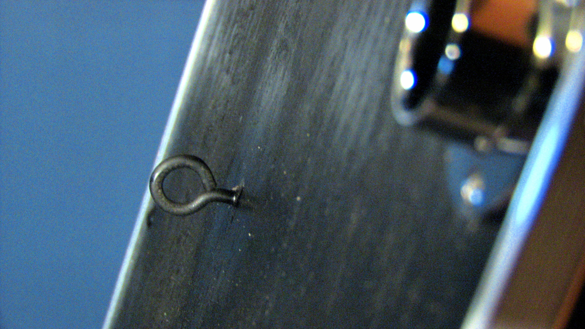

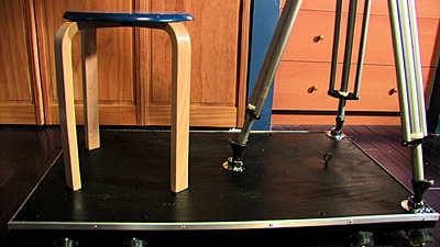

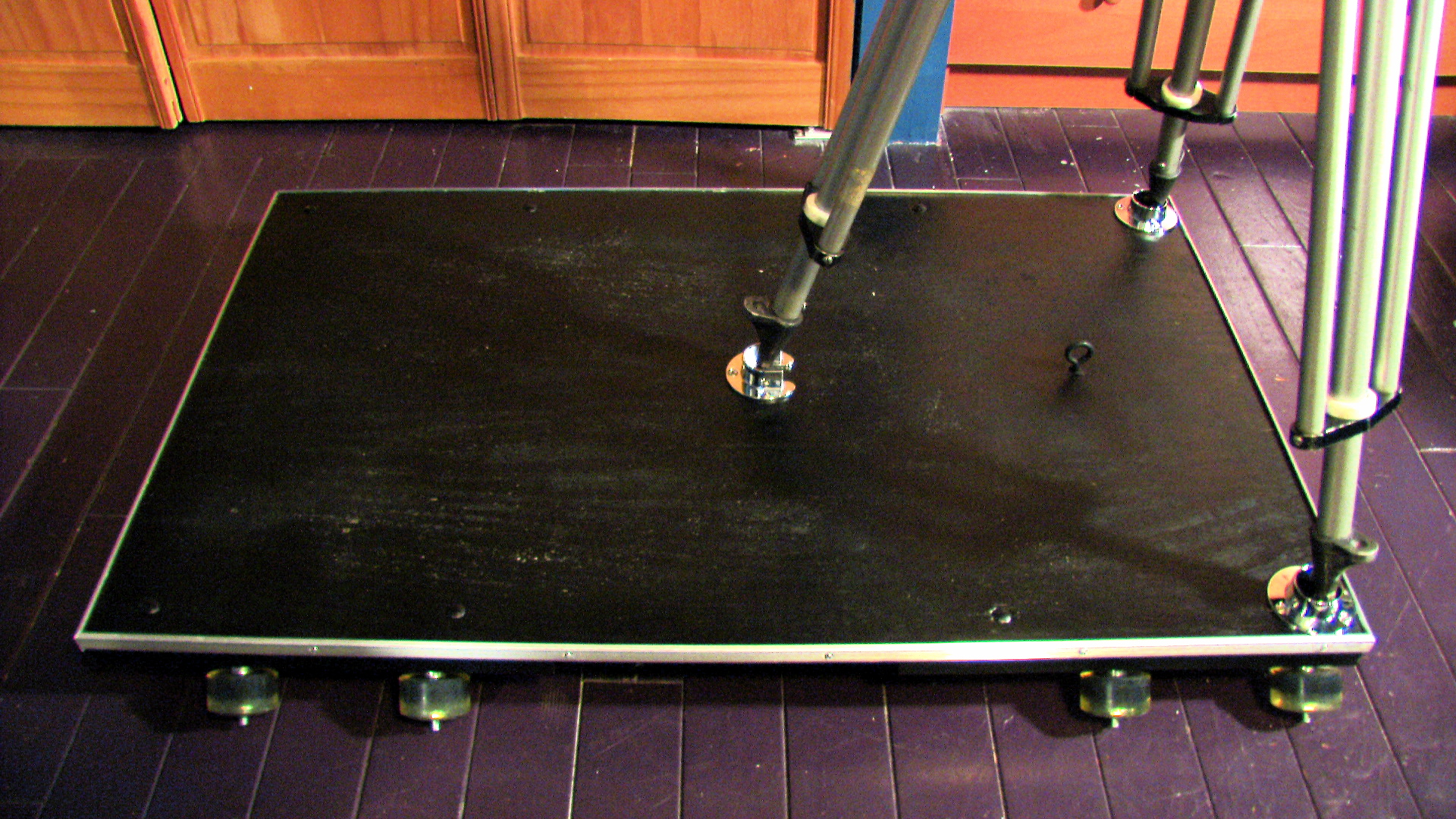

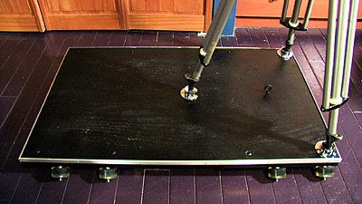

Here are some pictures of my dolly:
Nice DIY Dolly Test Video-img_0138.jpg   Nice DIY Dolly Test Video-img_0139.jpg
Nice DIY Dolly Test Video-img_0140.jpg   Nice DIY Dolly Test Video-img_0141.jpg
Nice DIY Dolly Test Video-img_0142.jpg   Nice DIY Dolly Test Video-img_0143.jpg
