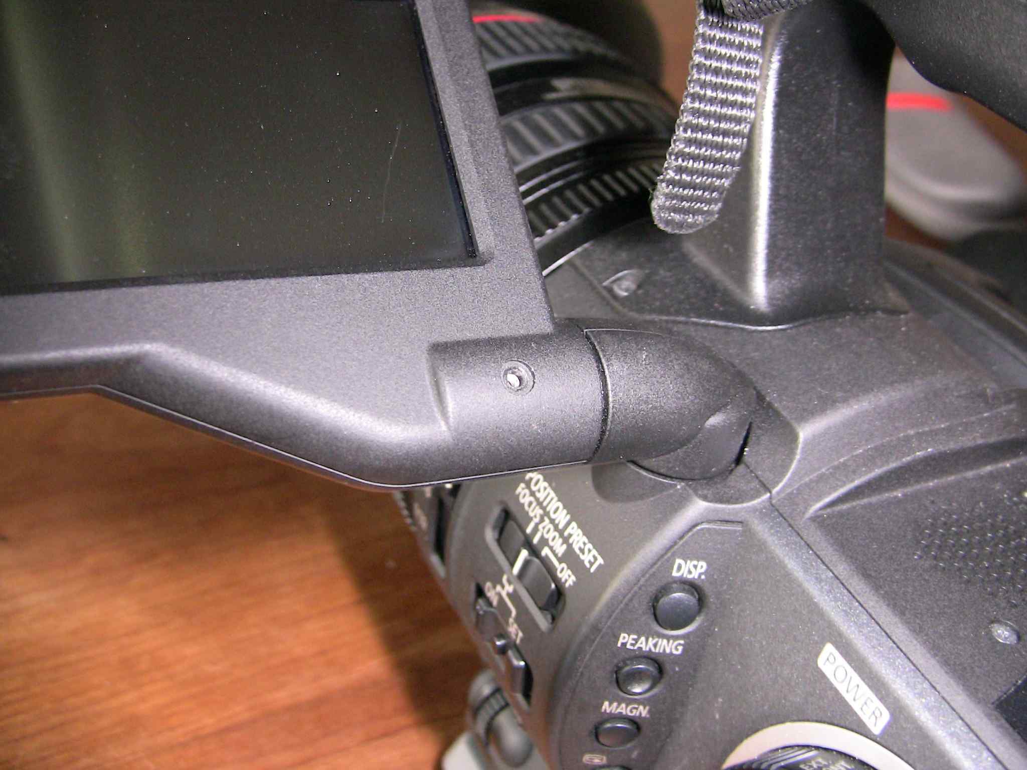

About two weeks ago, I was filming in the south of France, while I suddenly noticed that a screw had disappeared from my A1's LCD panel (see image).
This screw seems to be the one and only key connection to keep the LCD panel on the swivel system. To be honest, compared to the Sony LCD's, I've always found this concept to be a weak looking design. Take a PD170's panel: it's rock sturdy!
The consequence was that I didn't want to use the LCD anymore to avoid further issues, and could thus only work with the viewfinder. A serious inconvenience, anyhow.
My shop is going to discuss this issue with Canon, and try to get the screw, since this seems to be the only problem (I hope so). If I send the camera in for service, it will take me at least weeks without this A1 (I already went through the challenging experience of Canon's after sales services in Europe) - I cannot afford this kind of game at this moment.
In the margin: I handle my equipment with a lot of care.
The A1 is a beautiful piece of engineering, but I've already encountered a few quality issues. Going from the non-usable downconvert option (alternating black line), a not straight positioned baseplate, now this...
From a company like Canon, making and selling tremendous numbers of cameras every day, I would not expect this type of problem, certainly not in a pro range of camera's, and certainly not on vital components.
With Sony, I've also had a few things, but never lost one screw!

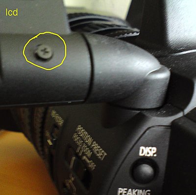

I just wanted to start a new thread about the same problem.
The screw was still in the panel, but almost completely out.

I had this problem with both of my A1s within 1 job... I called Canon's service number, they sent me to the parts dept. and they shipped me out a bag of 10 of these screws, gratis. No problem, lickity split...
