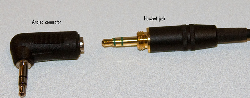

I did the same thing (a year ago) when my camera was only a month old. They charged me $250 to fix it. They knew it was not a warranty issue. This was at the Irvine, California repair center.
I now use a double connector with an angled input so if I do it again, just the connector will separate from the angled one.

Howard
Is there any chance that you could link to one of these connectors somewhere on the web or provide a photo.
I can't visualise it.

Here is a picture, I got it at a local electronics store.

Sure taught me a lesson too. This is why I got the angle adapter. I figure if I did do it again, there would be little or no damage if it worked correctly as I planned.

Is this weakness unique to the XH-A1? Is it because the green plastic insulator is too small? It is questionable that it is an owner fault or a design flaw considering the number of people that have had this part break.
I have one of the right angle adapters but I am not quite sure how it helps prevent the breakage (since it has not happened to me YET!
