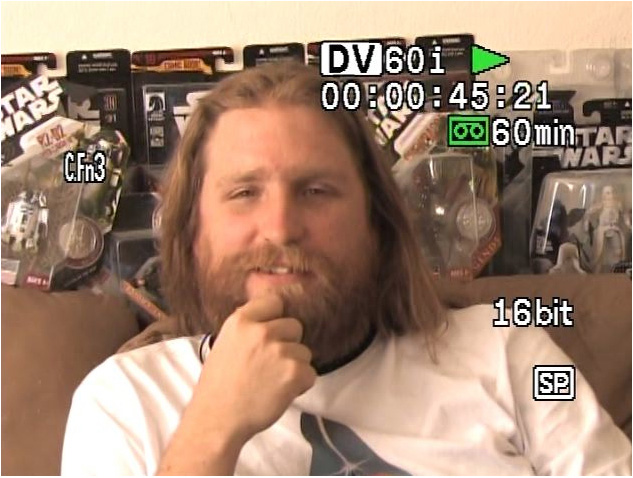

I've been through every menu selection in the Display Custom functions, and there is no way to get rid of the "SP" Time left icon and corresponding tape graphic, "DV with 60i" icon "16bit" icon, and the "Cfn3." I really think that Canon could easily have a timecode only display on the A1, but chooses not to. It would be an easy firmware upgrade.

<<edit* Michael, I think I take back what's said above. I was curious & tried this myself. Try hitting the DISP button while in playback mode. On mine at least, the only thing displaying on the LCD/VF is the TC. Of course for overlaying to video out you need to activate TV SCREEN in the Display Setup menu.>>
Exactly. I can't seem to get rid of the other icons I mentioned in the above post when activating TV SCREEN during playback for the video output. And I've turned off everything in the custom display fields.
Mmmmm. Last year I was able to achieve close to what I wanted, by linking two camera's with firewire. I played the tape with CAM A (XL-1) and had to record a new tape with REGEN timecode with CAM B (A1) and output that through V1 with the TV SCREEN on to my DVD recorder. While in Record mode the TV SCREEN display is more minimalistic, with just timecode and the time remaining icon. But a cumbersome process to say the least!
Here's what I've managed just with Custom Display options.
Michael Garrigues is offline   Reply With Quote

Ok... I just realized my post earlier was while in playback but NOT playing a tape. Pushing the DISP button once only showed the TC & the stop icon. I just tried it playing a tape & sure enough it disappears. However, from your pic... the only items mine doesn't show is the 16bit icon & the SP icon, but that's because mine is in 1080i, not SD. All else is the same & I suppose that's as good as it gets. Too bad positions can't be changed... like TC in lower corners, etc.
