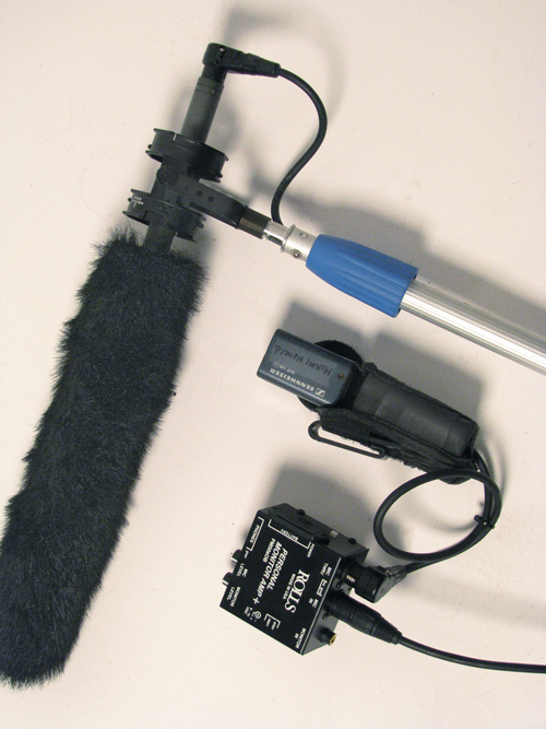

Originally Posted by Ty Ford View Post
We'll stick the transmitter on the mic on the end of a 14 foot pole and let you hold the other end. We'll take it off the pole and see what that feels like. You can disagree with me all you like, but you can't disagree with physics.
Plus, as I said, there's no way for the boom op to hear if the mic's in the right spot.
My suggestion: run the signal via cable to an operator's monitor (we use a Rolls PM50sOB, iirc about $50, I'm sure there are fancier ones) and then, via short xlr jumper, to the xlr transmitter, both units hanging conveniently off your belt....the Rolls xlr plugs are too close together to permit direct use of the transmitter, so a 1' cable does the trick....no weight on the boom, monitoring for the operator, and complete mobility..../Battle Vaughan/miamiherald.com video team

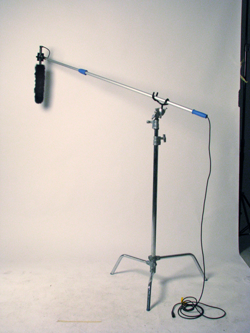

Our boom mike is an A-T815B, which have used successfully with the setup I mentioned earlier. We usually use it as a studio thing, attached to a C-stand, but with the weight off the mike and on your belt it is not bad to hand-hold. /B Vaughan

Thought I'd post a couple of clips of the setup I mentioned earlier. The boom is a diy [I hear the flames coming already :) ] 10' gadget from Home depot with an adapter I machined and an AT shockmount and mike....we use it as a location or studio boom usually, but I have handheld it ok with the belt rig shown in the closeup.../Battle Vaughan /miamiherald.com video team

Sorry, Ty, misread your post. Not familiar with that mike...see images for what we got...works for us...ymmv!:) / B. Vaughan
