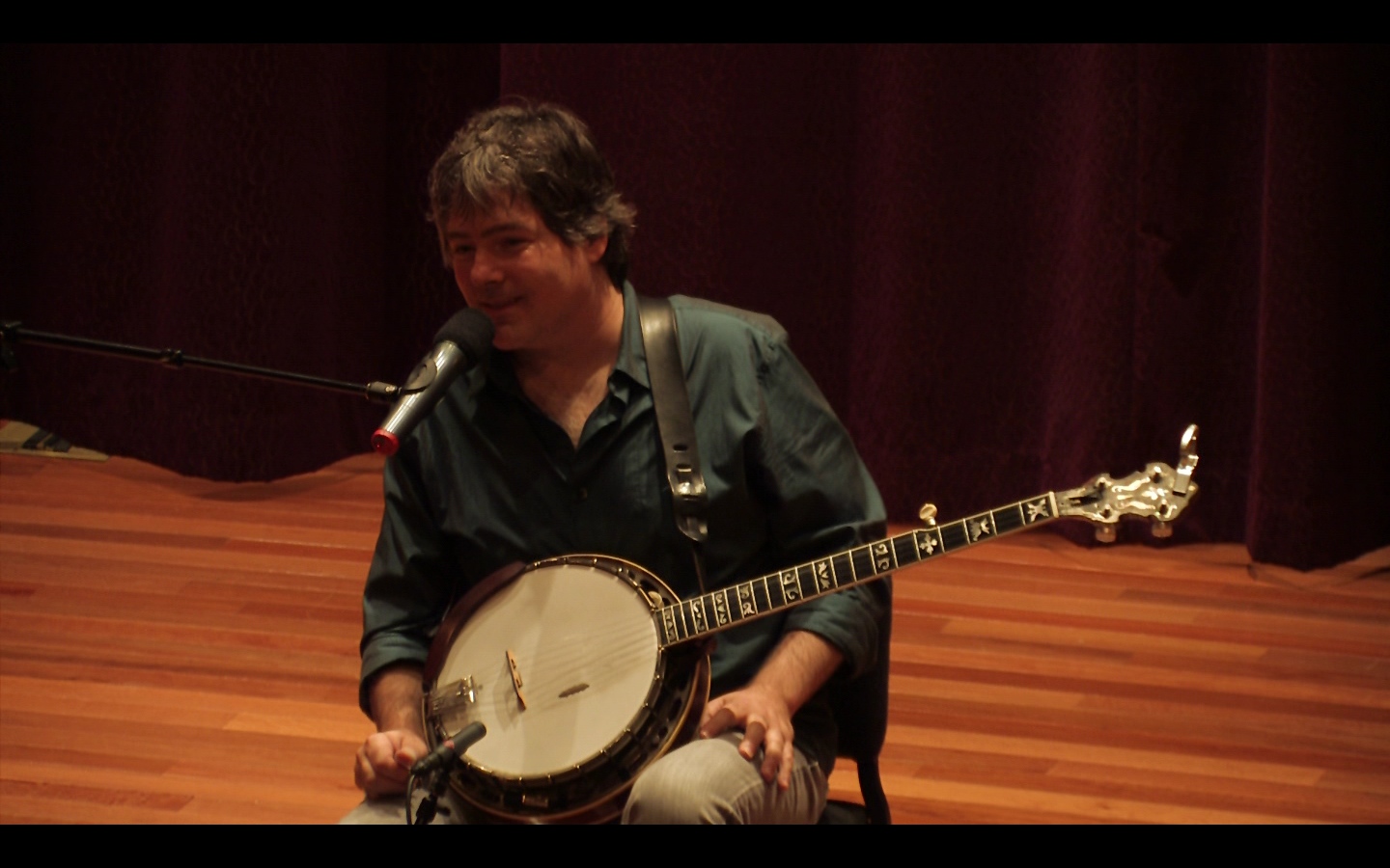

Here is something from what was the second camera in a shoot using the preset. Shot with the XL-H1A. I think this frame has a bit of a soft focus and or the softness from the preset of NR2-High, but that said, the Gain was @ 6 and this was @ 20x so I think it held up nicely. Sadly I am not allowed to post any videos.
