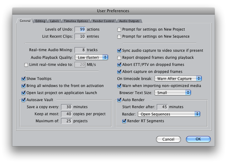

Problem maybe solved......!
After speaking with Apple and getting what amounted to half an hour of free technical support (thank you Apple, I now forgive you that my 17 inch laptop is late) I think we may have cracked it. I ingested two tapes yesterday and they went in like a charm without any drops. I am sleeping better, my wife loves me again and I feel that much closer to world peace. Aaaaaaahhhhhhh at last.
After a lengthy explanation on why HDV is the savior to bringing HD to the masses, he went on to say it is also a crippling format to capture true HD quality and carries no real time code. It sort of manufactures a time code and slaps it on top. In the light of my success, I will take his word for it. He also said that it is "nothing like DV" and behaves very differently. With that in mind he pointed me to User Preferences in FCP and said to uncheck the "Report Dropped Frames During Playback" and to select "Warn after capture" in the drop down menu for "On time code break" He said something like 'HDV has a weird form of time code and it doesn't play well with FCP.'
I can't say I understand all he was saying and some may argue his points but I have ingested 2 tapes (one hour each) and they went in without a hitch. The real test would be to pull a tape that I know had drops and ingest that. These tapes all came from the same wedding shot with the same camera so I can't see it being different. I will ingest them again anyway because now maybe I won't have to re-sync my multicam edits every 5 minutes.
Thanks all for your help and suggestions. If anything changes I will report back in case this can be of use in the future.
