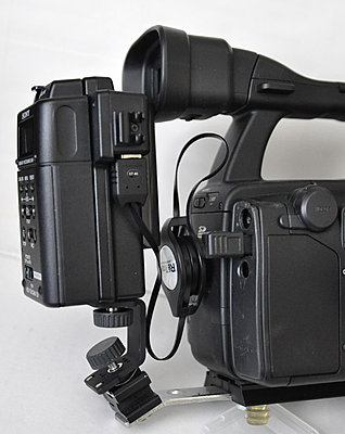

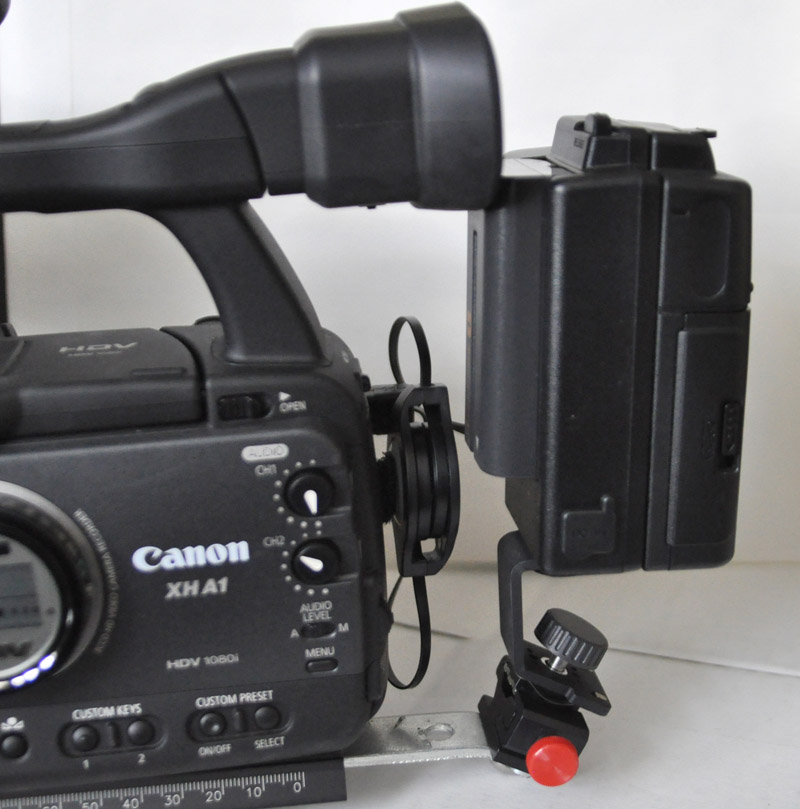

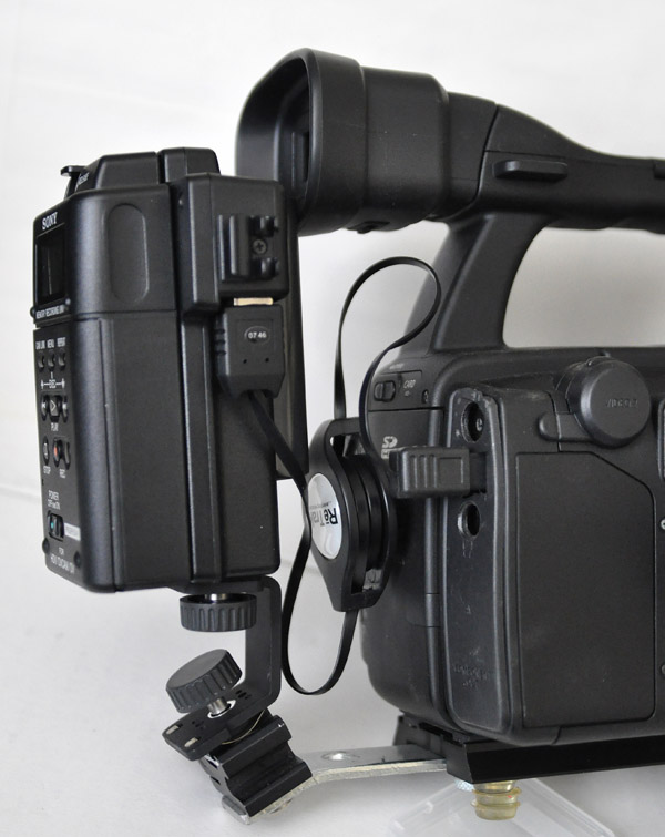

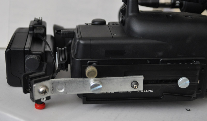

I have come up with a mount for the HVR-MRC1 that works for me. I have attached pictures to see it as I describe.
I purchased the Bogen Long QR mounting plate which is compatable with all my tripods, etc. This allows me to mount a bracket to the bottom that extends back from the QR mounting plate.
1. Purchased a small steel bracket at the hardware store.
2. I bent the bracket at the matching angle to the mount that comes with the MRC1.

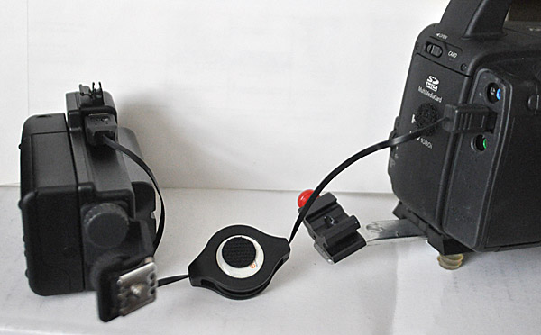

3. I mounted a cold shoe to the bracket. This allows me to quickly slide the MRC1 off to change camera batteries.
The distance of the bend in the bracket corresponds to the clearance needed for the Firewire cable spool and the viewfinder. I purchased a very small retractable firewire cable and attached the spool to the camera battery door via velcro.
I plan on painting the bracket black but I wanted to show all of you the raw design first so you can see it better.
I could have bent the included Sony bracket so my bracket could have been flat but I didn't want to risk ruining the Sony bracket. This would have made setting the camera flat on a table easier. I used rubber bumpons to rest the camera on in my case.
You could mount the MRC1 directly to the bracket but battery access would be a problem.

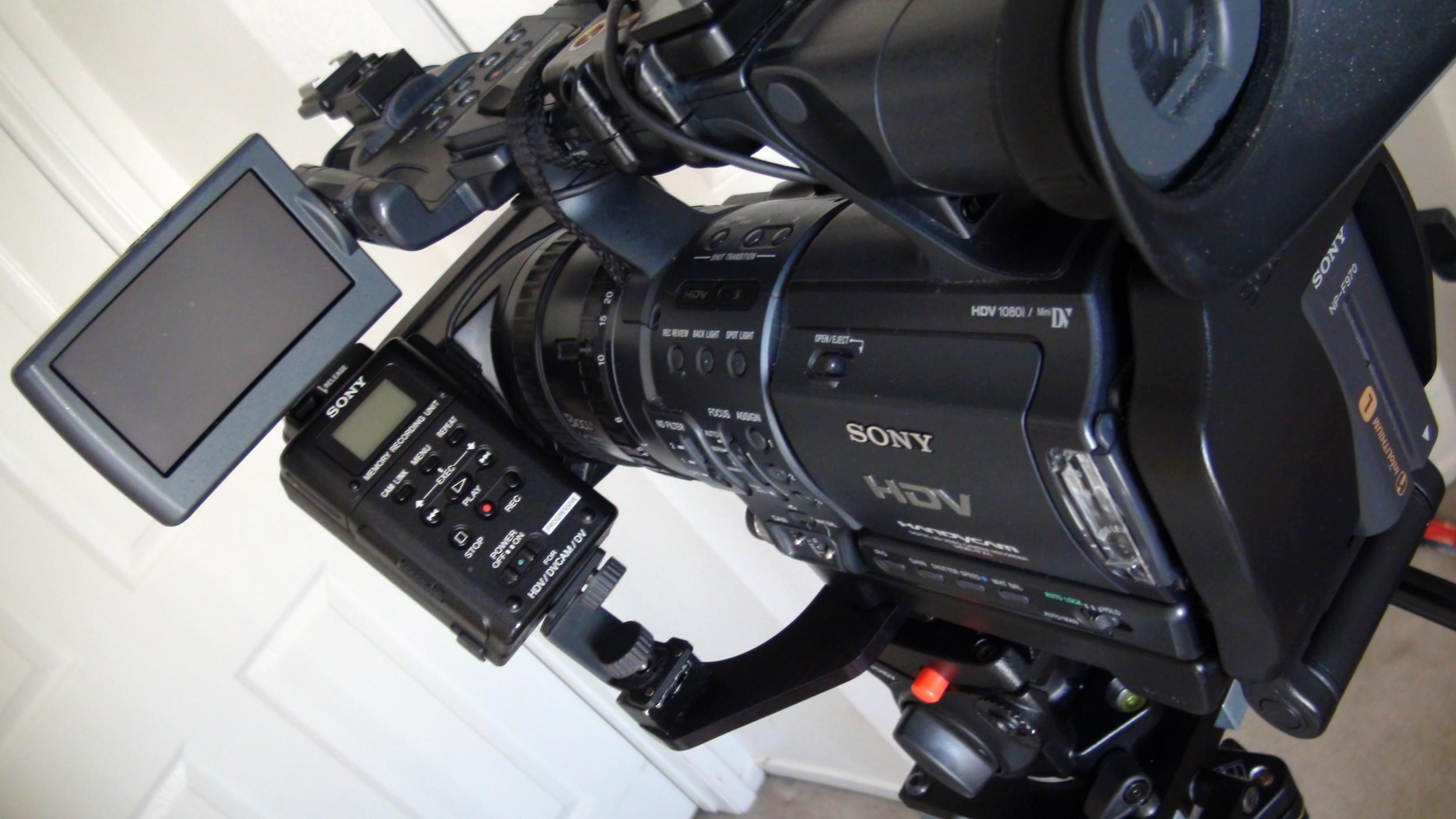

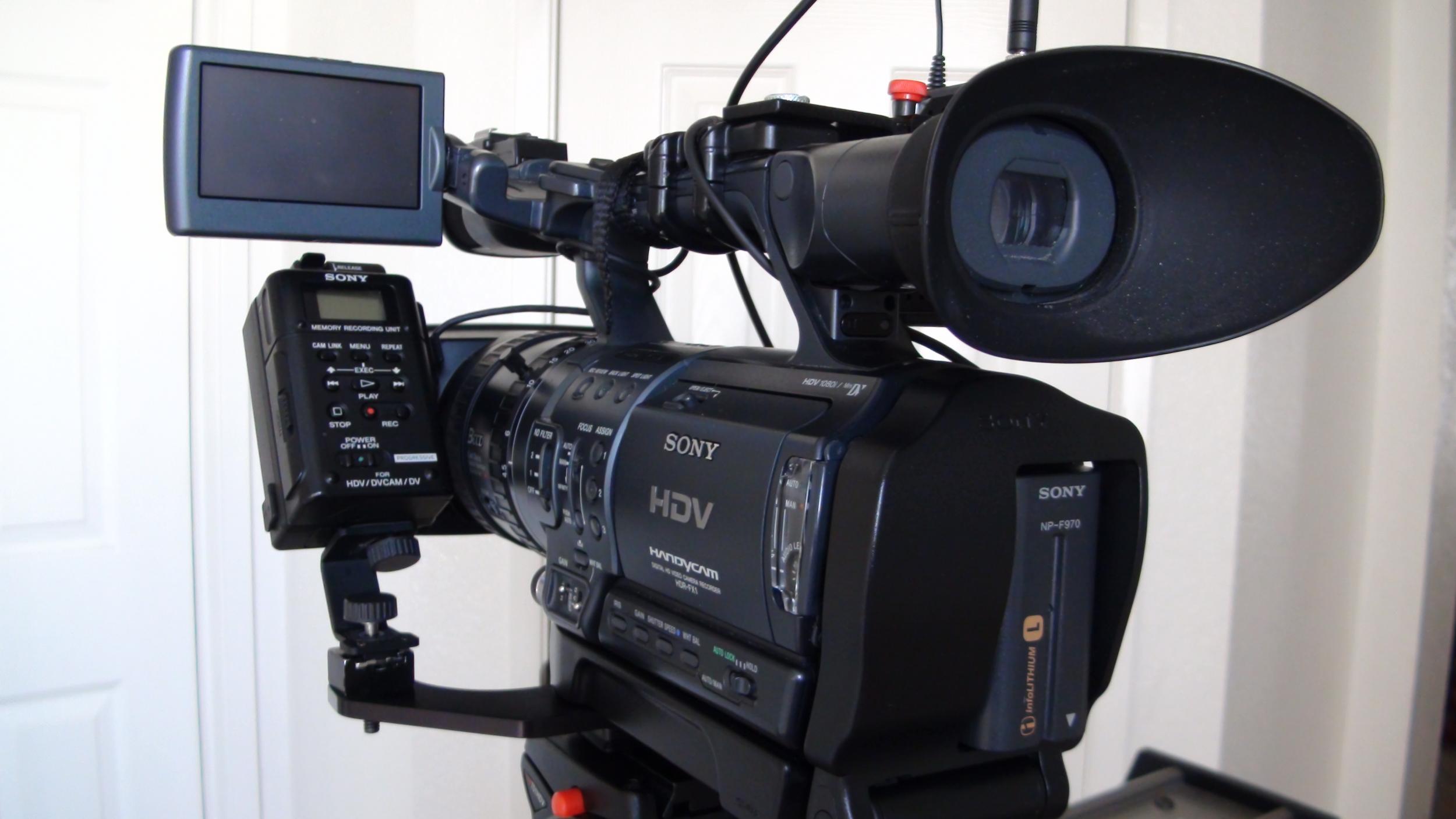

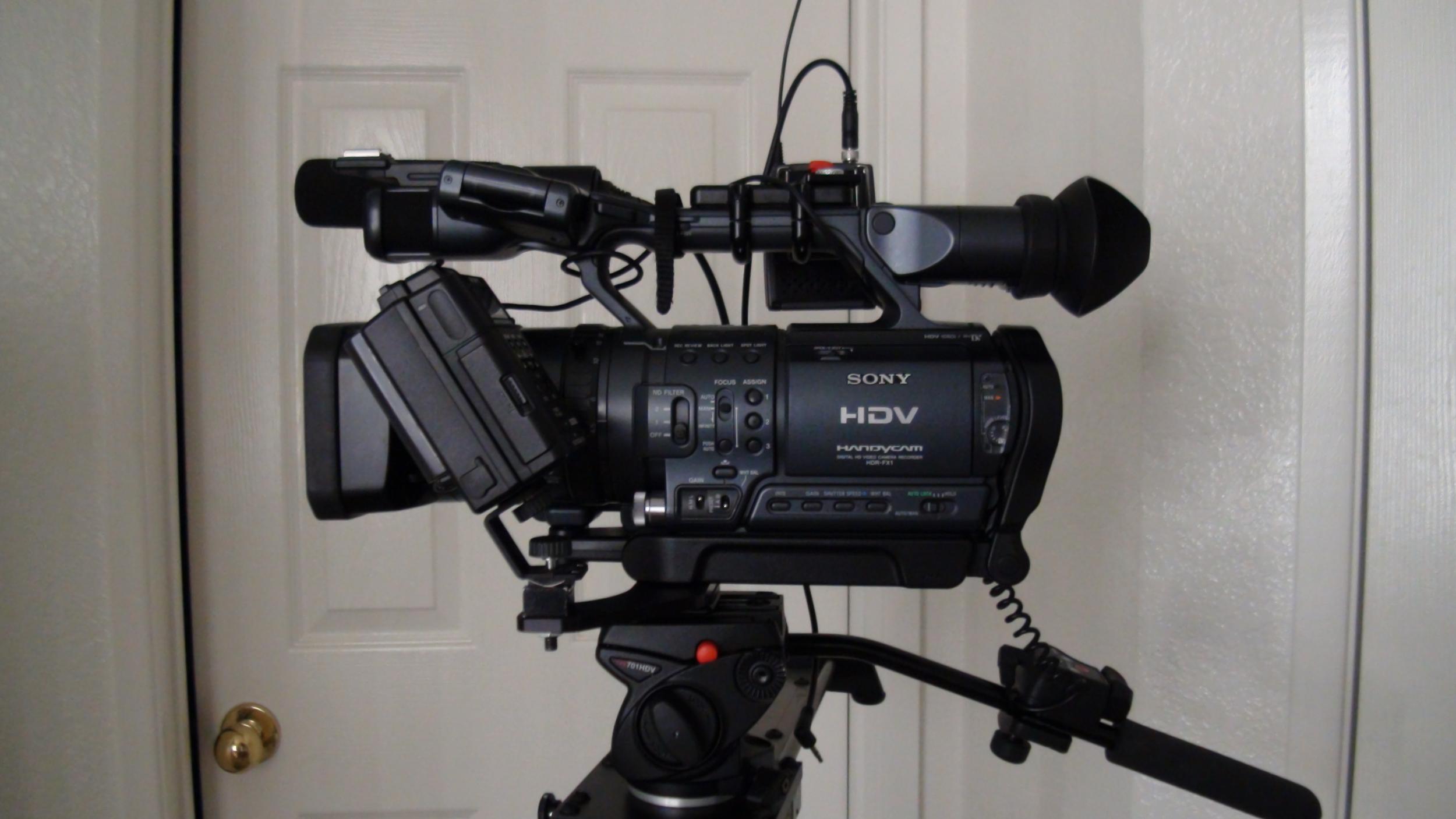

This is my version on my FX1:

which mount specifivally did do you use from IDC? Are you using more than one? I do like the idea of having the HVR-MRC1 on the left side, similar position; torn though, seems like handheld it may be better on the back. I have a XHA1S, but my Manfrotto mount doesn't have an open slot to attach a plate, trying to figure that out.
Great use of the bracket though! Thanks for posting the pix!
EDIT.... it is looking like the dogleg more now... can this be positioned with the "leg" either way? Just curious....

"can this be positioned with the "leg" either way? Just curious...."
This is for left side position only.
I can put the recorder on top of the handle for I have the HD bracket attach to it, but I still prefer on the left side so I could see if the unit is recording while using the eye viewfinder.
I use the dogleg also on my 5D MK 2 to attach the Tascam DR 100.

"Does the unit start automatically on you FX1 with starting of recording on the camera ? Any comments on operation with the FX1."
It you shoot with tape in your FX1 yes it start and stops as you press the record button on you camera, but without tape in it you have to press the two buttons in the recording unit. That is why I like the MRC1 place on that position for I have to press it manually during operation when recording without tape as I usually do.

One more thing Steve on your HVR-MRC1.... just ordered mine, and plan on making a bracket like yours. My camera mount is the standard size and will require shaving off the back ridge, which prevents the steel bracket from being flush on the bottom side of the mount. Once I do that, it should work fine. While I like the idea of having it on the left side of the camera, I ordered 32GB cards, and timing shouldn't be a biggy for the most part. I like having the extra weight towards the back end.

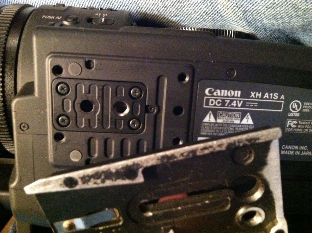

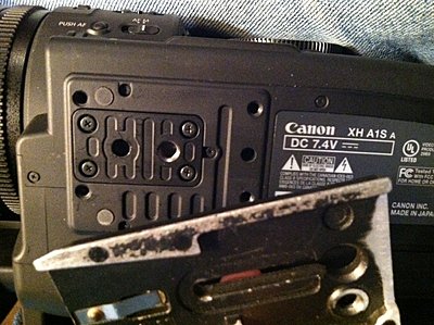

Hi Steve, just wondering if your bracket was just using the main socket, and did you use the 3/8 socket? I have attached an image of the bottom of my XHA1s with the bracket, which I had to shave down the back a little to create a flush surface.
Seems like that may stress that socket a little, what are your observations?
(EDIT: just noticed the additional screw sockets Canon has on the bottom of the camera..... I am guessing those are for a different kind of tripod mount; but beginning to think perhaps I could drill holes in my bracket and use those instead. Seems like it would offer much better support!)
