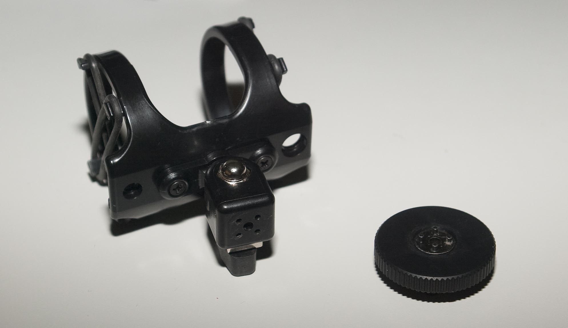

Has anyone ever come across this before? Used the mount with an NTG2 microphone fitted with the deluxe windshield - only purchased and this was its first use. The hot shoe adaptor parted company with the shock mount (see attached photo) after a couple of hours.
Looking at the photos, am I missing anything that I need to fix it or should I just use a drop of glue?!

The SM3 seems rather fragile. I bought one recently and found that the plastic around the swivel joint was broken when I took it out of the bag! I've written to the retailer but not had a reply yet (must chase them up). I think it's cheap for a reason...

Looks to me as if the metal screw that holds it together may have come out or the socket it goes into has become stripped.
I would contact Rode - I had two SM3s replaced free. Both broke around the swivel joint. (I had asked Rode if they did spares for it and they offered a replacement after I filled in a form).

The small metal plate inside the bottom of the top half ( behind the 4 small holes ) is threaded to accept a small screw. The screw must have fallen out. You should be able to replace the screw - I'd agree to call Rode & let them replace it or at least send parts.

mine broke too, because a friend was messing with it. The plastic at the swivel broke. I tried gluing it with some epoxy to no avail. Finally, I emailed Rode and they sent me a new one. Now I'm very careful with it and don't hand it to idiots.

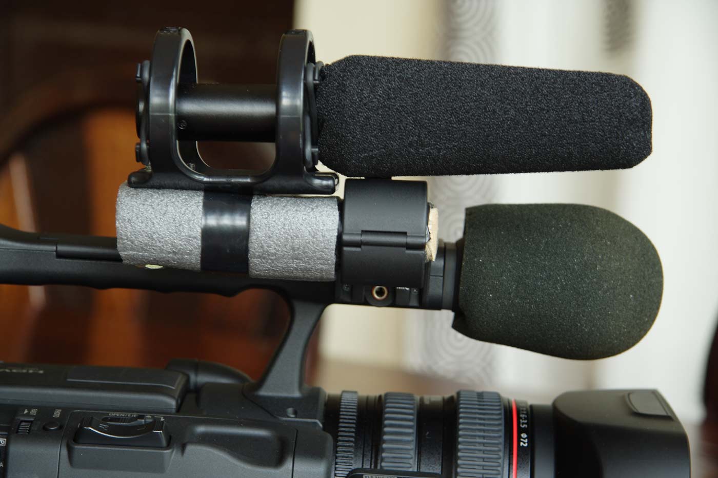

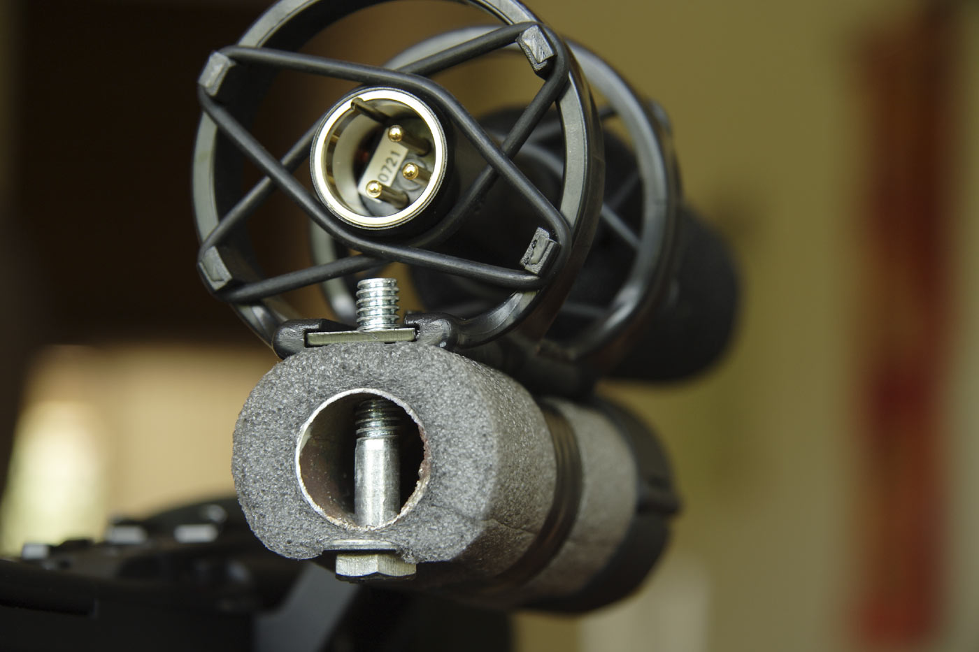

i took a mic stand and sawed off a 6 inch piece, used pipe insulating foam to cover the pipe the length of the shockmount, then drilled holes for a bolt that actually threads into the rode shockmount. the shockmount is seated on the foam (for better insulation against vibrations), and i wrapped electrical tape around the remaining pipe so it fits perfectly in the XH-A1 mic holder and capped it with a wine cork. i think it is more solid than the hot shoe.
