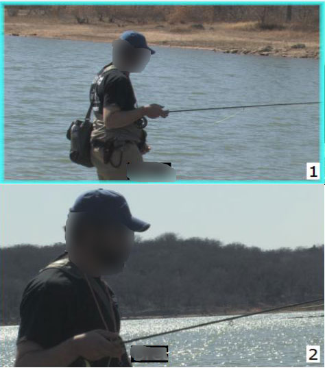

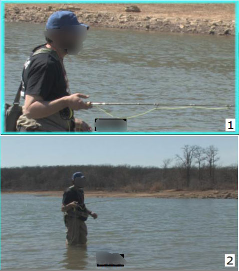

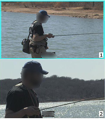

I will admit we are still using exposure in automatic mode.
However I am noticing that one camera will have a "lighter" yet correct exposure while another has a "darker" yet correct exposure. Forgive my ignorance but if I remember anything from still photography, it's that being zoomed in farther requires more light.
So how do I correct this? If we go to manual mode, it's not like I can just tell the other camera "shoot these settings" because we're going to be filming two shots, a medium and closeup or whatever.
Attached see two examples. It's not even consistent as to which camera (zoom level) creates which exposure issue.
What I'm showing here is really just a one frame grab but as I watch the footage, the differences are a little more obvious.
2 camera exposure-exposure_1_cu_lighter.jpg   2 camera exposure-exposure_2_cu_darker.jpg

When you shoot on auto and zoom in, the exposure can and will change because the average brightness of the background changes. Like if you first have a wide shot with sky in it the exposure will be a bit dark. After you zoom in and cut out the sky and get more dark riverbank in the picture the exposure lightens, further zooming has only the fisher and light water and exposure gets dark again. I hope you get my drift here.
The only way to have consistent exposure is to shoot on manual where the exposure stays put. If you are zooming in very deep, choose an f-stop which is available also at the zoom tele end, otherwise the will be some darkening at the tele end (problem with cheap long zooms, they do not hold max aperture all the way...)

In the first shot, look at the sun on the guy's forearm. The second shot is more backlit. You really need to get off auto exposure.

I agree with Bill. And not only that, all four of those shots looks like there may be some lens diffraction going on. Look at the trees in the background for example. Then again there's not much detail at all in those shots. Were you using ND? If not you should, plus trashing auto & open up the aperture manually.

also, if possible, shoot from a different angle so the main subject isn't in shadow and the light is more even. or hire a lighting crew (ha ha). i find choosing the right angle/light in the first place is easier than struggling with two different exposures at once.

Throw it in manual, lock your shutter at your appropriate speed, turn your gain down to -3 or 0 (since it's bright) and dial in your aperture using the exposure meter at the top left hand side of the LCD.
If the meter is always in the middle for both cameras, then it's pretty much "shooting the same settings". Only variable is the aperture which you adjust to correctly expose.
Like Bill B. said, use ND filters first before stopping down the aperture.
