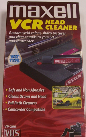

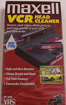

wetdrywetdrywetdry.... I can't think of anything that's been more confusing than this wet vs. dry debate with MiniDV tape. Many years ago though it was more of an issue. We knew it, the tape manufacturers knew it, but it took years before anything was done about it. And even then there's still issues, albeit more minimal than now. I still will run a head cleaner before I choose to change brands. I've been conditioned that way.
Re: head cleaners. I've noticed Panasonics packaging that says "dry type" and I STILL say it has nothing at all to do with what lubricant process is used for the physical tape. If it did wouldn't one think it would mention something on their blank media packaging as well? I believe it says "dry type" because it's referencing back to those horrid "WET" head cleaners that we all saw for VHS & Betamax. Remember those? There was a bottle of fluid you put a few drops into openings in the shell? It wasn't long before they all got a bad rap. I ruined 2 home vcr decks back in the day using that crap.
Here's a "wet type" head cleaner :D
