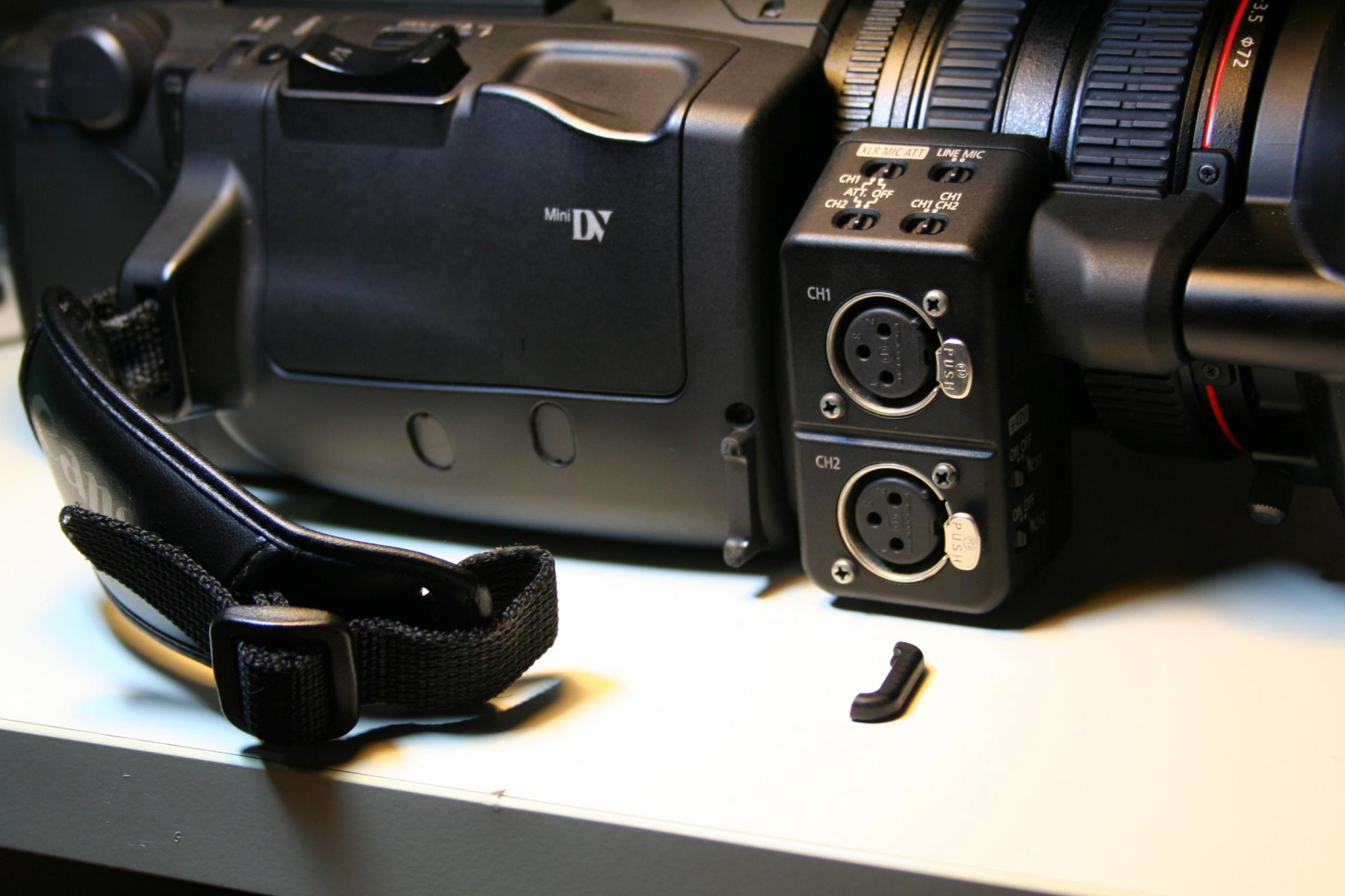

Hi there.
From an italian FORUM dedicated to video professional I have found two peoples here in Italy with the handstrap support broken, as you can see from the attached image
Anyone of you have experienced this nightmare? Do you agree with me this is a SERIOUS issue?
Bye

Yes it is very serious. It is an obvious design flaw that the strap attachment point is so flimsy. Not sure what needs to be replaced in order to repair this, but I expect it is quite expensive. Think I should stick some gaffer tape over mine to cushion it a bit in case of any knocks.

It is absolutely necessary to use both hands and to loose a bit the handstrap. Use the neckstrap should be a good insurance. If possible, it is better using a shoulder support or a steadicam rig.

Guess it would be if it happened whilst using it single handed, not a particularly smart way of using it.
Is it a "design flaw"?
Suppose it depends how you define the term. My understanding is that any component is designed not to fail in 99.99 % of units in a three year period from manufacture.
Given the number of XH units out there in the big wide world, the length of time they've been out there and the fact that I have only seen 2 documented cases of this item failing, I would have to conclude - no.
Of course, it is possible it's more common than reported here on DVinfo, but there's one heck of a lot of XH' ers here (I happen to be one of them) and if it was a weekly occurence someone would have raised the alarm long ago.
Don't panic and don't use it single handed.

If you don't want to trust a glue job, you still have some plastic left on the camera to work with. Use a fine drill bit, drill a hole through the top plastic part left sticking out, and another through the bottom plastic sticking out, run a single strand wire (the kind you hang pictures with) through the holes and loop it through the hand grip. May last forever, may not.
Drill the holes as close to the camera body as possible!

Never understood why Canon made that strap support out of flimsy plastic, this should not break, period. There is no excuse for it. That strap support is for handycam type of camera's on of the most stressed parts and should be made of strong materials. It should be a part of the camera internal case and not a part of the external plastic casing.

Another possible fix--if you look under the pod where the XLR inputs are, looks like there may be enough gap to slip a black cable tie through to re-secure the hand strap, assuming it won't interfere with the iris ring usage.

I just found this forum doing a google search for broken XH A1 strap mount. Howdy, Has anyone tried to send this back to Canon yet for a fix? Mine got snapped taking it out of the bag this weekend. I'm pretty meticulous with my gear and pretty surprised this broke.

Very poor show on the A1, I leave a dummy XLR plug in CH2 as a buffer.
I noticed Canon have redesigned it on the A1S.
Had a thought, wonder if it's worthwhile coating that A1 fixture in super glue as a sort of
shock absorber...?
