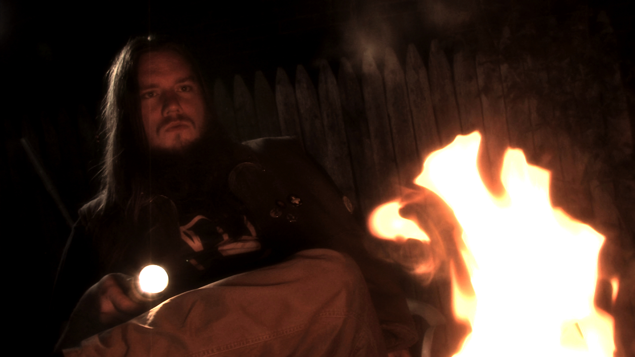

The attached jpeg is a screen grab of some low light test footage I took recently. It's a fire with 2 duralogs and 1 battery powered lantern behind the subject. This was filmed in 24F, 1/48 shutter, and 0db gain, with color correction, diffusion and noise reduction filters applied. I think it looks pretty good and I'm close to getting dialed in for a horror film I am shooting in June and July.
