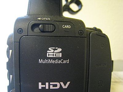

Unless the A1 specifically has an SDHC logo on the box or near the card slot...
It does though. See attached pic.
