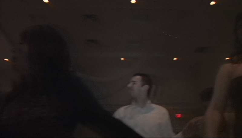

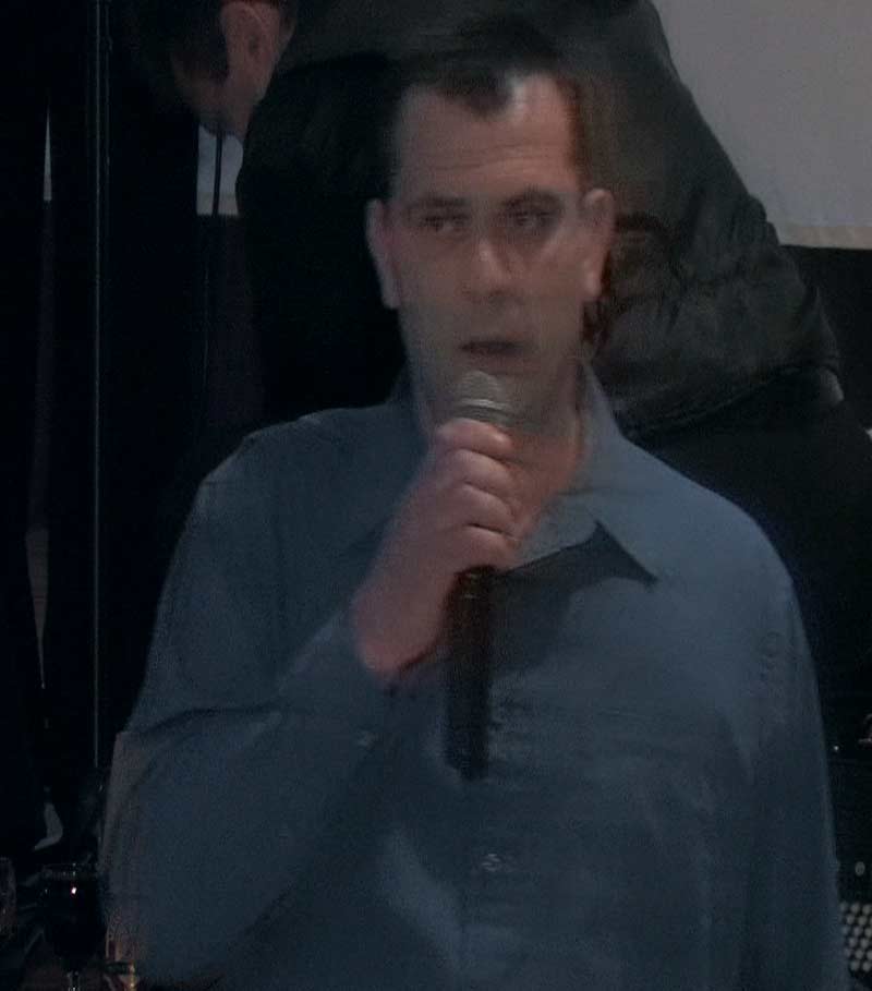

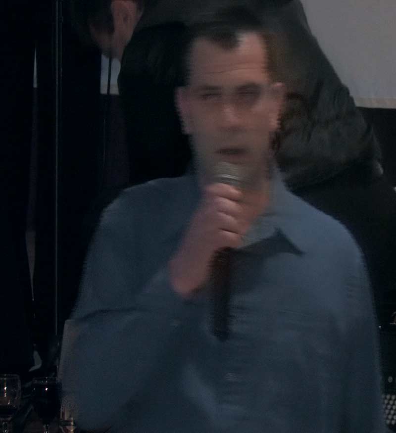

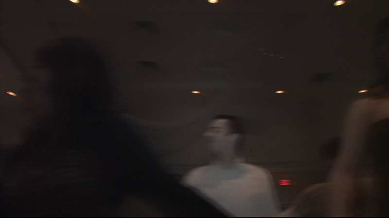

I freelanced a ceremony several days ago..It was SD and 4:3. Upon playback, the panning and zooming created a ghostlike behaviour on the whole image. To add insult to injury, the frame was softened (due to the nature of the ghosting)..Of course, i was on tripod and OIS is always turned off...Except for auto whitebalance, i was in total manual mode..
I've had this before, during my HD filming, but have always assumed that it's a product of Mpeg artifacting..I was in denial. It doesn't show up on the viewfinder at all...
But this just tops the cake. It's not normal..Since i can't produce the SD stills, i'll show you my HD equivalents.
As a side note to people interested, i switch back and forth between OIS on/off, depending on my situation..I'm never go lower than 60i and aperture is usually opened up all the way (due to lighting circumstances). Exept for an auto whitebalance, i'm usually in Auto mode with the Exposure lock turned ON, once i get the right exposure.
I've also allowed for Deinterlaced sreenshots from the timeline just for further analyzing. This is definately NOT an interlacing issue, for anybody thinking otherwise..
Here's some screenshots.
Another Ghosting problem-dance-deinterlaced.jpg   Another Ghosting problem-dance-interlaced.jpg
Another Ghosting problem-mic-deinterlaced.jpg   Another Ghosting problem-mic-interlaced.jpg

Seeing how dark those pictures are, I'd say that even with the Aperture maxed out open, the camera is having to set a shutter speed so slow, a tortoise would leave a smear trail.
I don't know what the slowest two shutter speeds are on a NTSC A1 but I'd really not use them on anything that's moving (unless, of course, you're trying to get that look).
Think it might be time to invest in some lights.

At a shutter speed of 60i, there is really nowhere else to go without smearing. Although this was a bit of an extreme situation, the SD shoot of late had plenty of light, but exhibited similair results during zooming.
Of course, i could try to bump up shutter speed, and bring up Gamma in post, but i've seen low light footage from other XH A1 owners, and it didn't seem as bad as mine.
My Panasonic GS400 never showed this kind of ghosting, and it was horrible in low light..
I've got a Swit 2010 from 5-6 feet away, and it should be good enough to avoid what i'm getting..
I've got to get back to some serious testing and find out button for button, what causes this anomaly...
