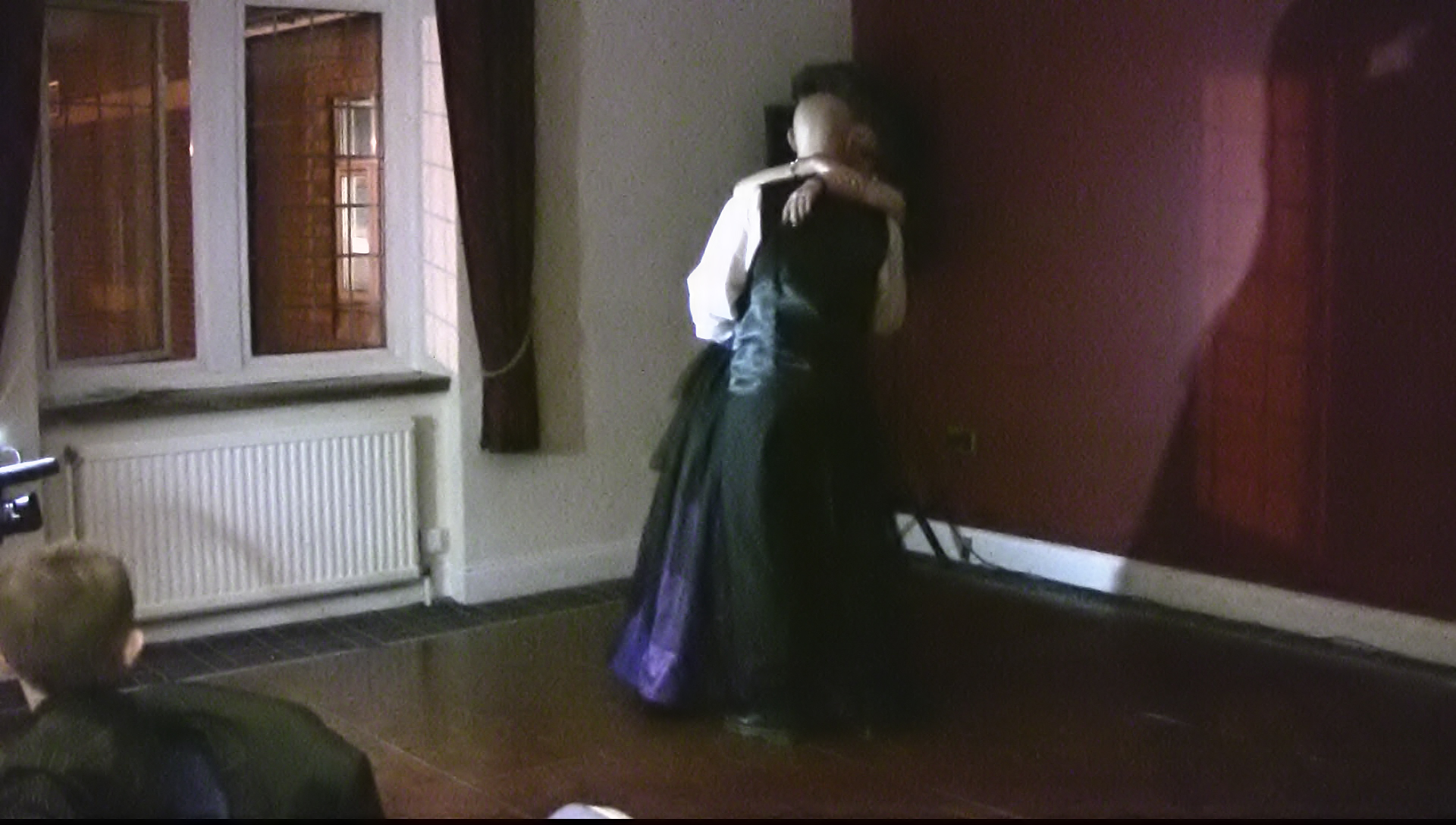

Hi guys, I recently filmed my first wedding for someone (for free so they don't expect much) using a borrowed XHA1s. Someone's given me footage
of the 1st dance from an HV40 so I'd like to do a multicam edit of it. Any idea how I can match the videos up so they look the same?
As they stand, the HV40 looks a lot better than the 3x more expensive XHA1s!
I had it on default settings, the dial was set to "M" and I put it on 12db gain. The HV40 was just on default settings I believe, and although the
screenshot below looks like there's a lot of colour noise when it's played back it's hardly noticable.
Any idea how to do it? (I've tried brightness & contrast on XHA1s but it ends up looking dull or too noisy)
I have Premiere and After Effects CS4
cheers
I had a 20W light on the XHA1s but it seems to have helped the HV40 more than the XHA1s! (you can see my cam on the bottom screenshot
in the bottom left), this is the light
screenshots (XHA1s first, then HV40)
http://www.maffmace.co.uk/1.JPG
http://www.maffmace.co.uk/2.JPG
Maff Mace is offline   Reply With Quote

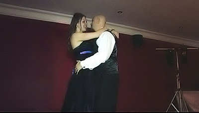

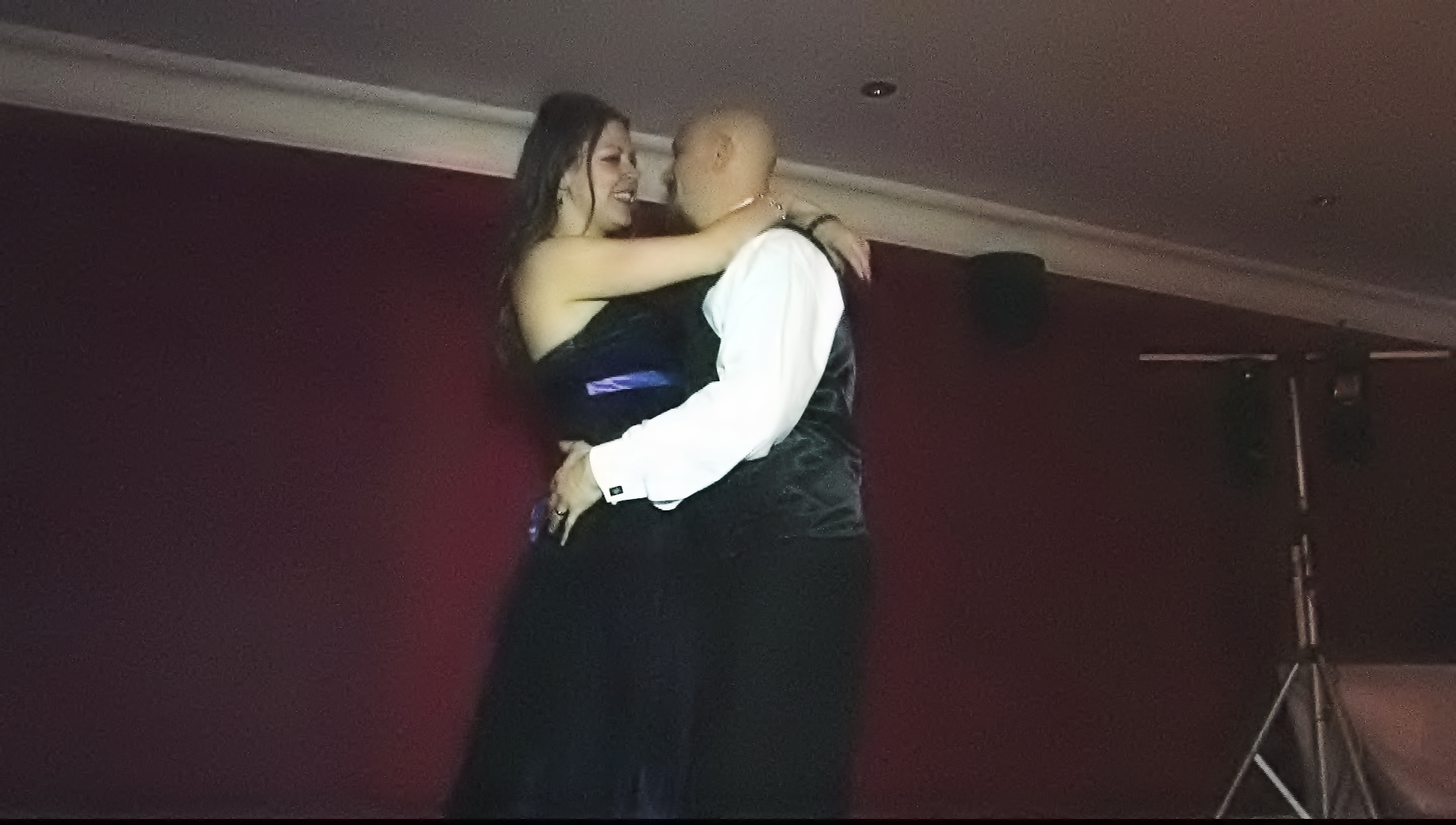

Matt....while I cannot speak to the two above suggestions, considering you have After Effects CS4 then you have a wealth of tools at your disposal.
I've attached two corrected jpegs of your footage for your comparison....
In both cases I added a levels adjustment to bring up the luminance somewhat, as well as the remove grain filter (because honestly both shots have a very high amount of grain noise).
In addition on the XHA1 footage I also added a curves adjustment adding in a little midtone and slightly blowing out the whites (not because thats good mind you, but it does match the hv40 footage more), as well as a very slight smart blur (to smooth out the noise just a bit more) and finally a hue/saturation adjustment to bump up the xha1's saturation.
I honestly believe that the XHA1 footage is better. The noise is very apparent in your original post but there is better sharpness/detail and far less chromatic abberation (blue fringing going on with the shot). So it is actually easier to manipulate it in post to achieve better results.
All said though I really recommend NOT shooting the XHA1 at 12db gain (6 is often pushing things) or at least look into a low light preset to help curb some of the graininess. Oh yeah and shoot wide open aperatures at these low light settings (if you were not)....you will need all the light you can get.
Finally, there are a wealth of tools to work video over....After effects is an excellent one (Premiere is good too), but neither are automatic...you must understand the filters/effects and tools within them to be able to logically apply them to any given situation.
Hope that gives you some ideas,
All the best,
James Hooey
Sound Pro Studios
How can I match HV40 to XHA1s footage?-hv40-cc.jpg   How can I match HV40 to XHA1s footage?-xha1-cc.jpg
James Hooey is offline   Reply With Quote
