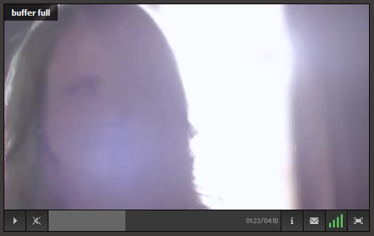

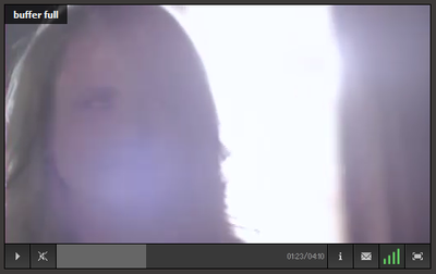

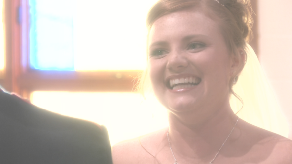

Originally Posted by Perrone Ford View Post
I've seen that effect tried in many video cameras with miserable failure. I'm curious how you'd go about replicating it
Is this the look you're referring to? See first image.
I just spent hours going through footage to try and find something like that scene, and this is the best I could come up with. See second image. I've never tried to do something like the music video. But now I'm tempted to try it. It seems I rarely shoot towards the sun.
Color temps are different in my video (I'm warm in this shot for obvious reasons) and I think if I had closed the aperture more I could have come a bit closer to the look from the video. I also wish the windows were a bit further away. They are only about 10 feet from the bride and couldn't be thrown out of focus.
My video has been desaturated and had soft focus applied in post.
I never meant to imply that the A1 could achieve the same look as a film cam or a RED.
Ken...
Thanks for taking time to find this comparison...very enlightening.
It's funny how I "overlooked" the gel on the windows. It's especially "obvious" on the front door when its opening. The shot through the screen door is clear, while the view through the door is disfused.
Ive never took time to really look at pro videos before, but I will from now on.
