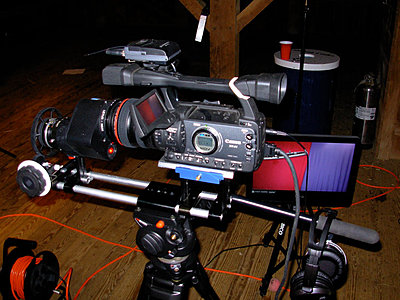

I currently own a Canon XH-A1 and have been using it with a Letus Extreme adapter. (See attached pic) I'm extremely familiar with the layout of my xh and love using it, but after working on more projects with more people, using a tape workflow just doesn't cut it anymore.
In an attempt to go tapeless, I purchase a FS-4 HD, not realizing that the format was .m2t, so editing in fcp stinks. I could sell the FS-4 HD, and purchase a FS-C or FS-4 Pro HD, but the issue now comes down to weight of my rig. I shoot more than half my stuff handheld aka shoulder-mounted, and with the xh, letus, mic accessories, firestore, and soon-to-be-attached Manhattan LCD monitor, the weight is getting up there.

Honestly, I think you should try to go for one of the new Canon/Focus Enhancement CF recorders and find a way to mount it to your camera. You're used to your system now.
You can try for the going to the HPX170, but I tend to agree that the image isn't quite as nice. But the tradeoff would be a more compact setup with less peripherals.

Kevin, it sounds like a used EX1 would be perfect for you. If you look around, you can find them for about $4,000, usually with an SxS card included. Sell your A1 for around $2,000 and you're halfway there.
The EX1 records to SxS cards, and they're generally cheaper then P2 cards. It has full raster 1920 x 1080 1/2" imagers, so it will be much better in low light and depth of field control. You may not even need your Letus rig anymore. The image will be sharper and all around better than the ones from the A1 and the Pannys. It has variable frame rates, everything you're looking for.
