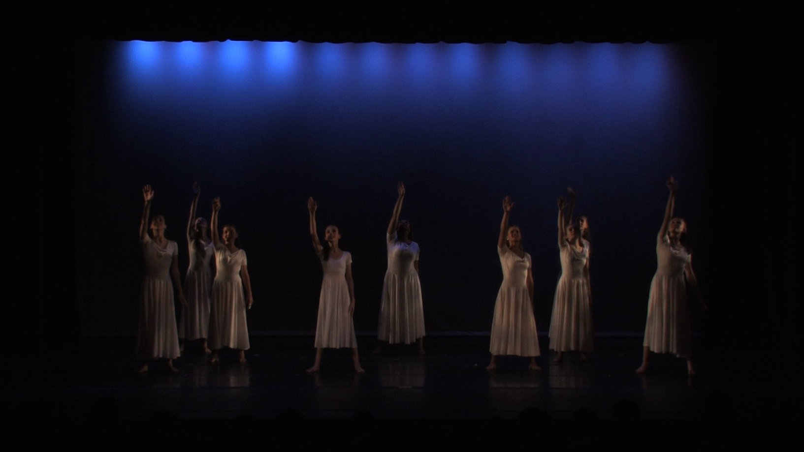

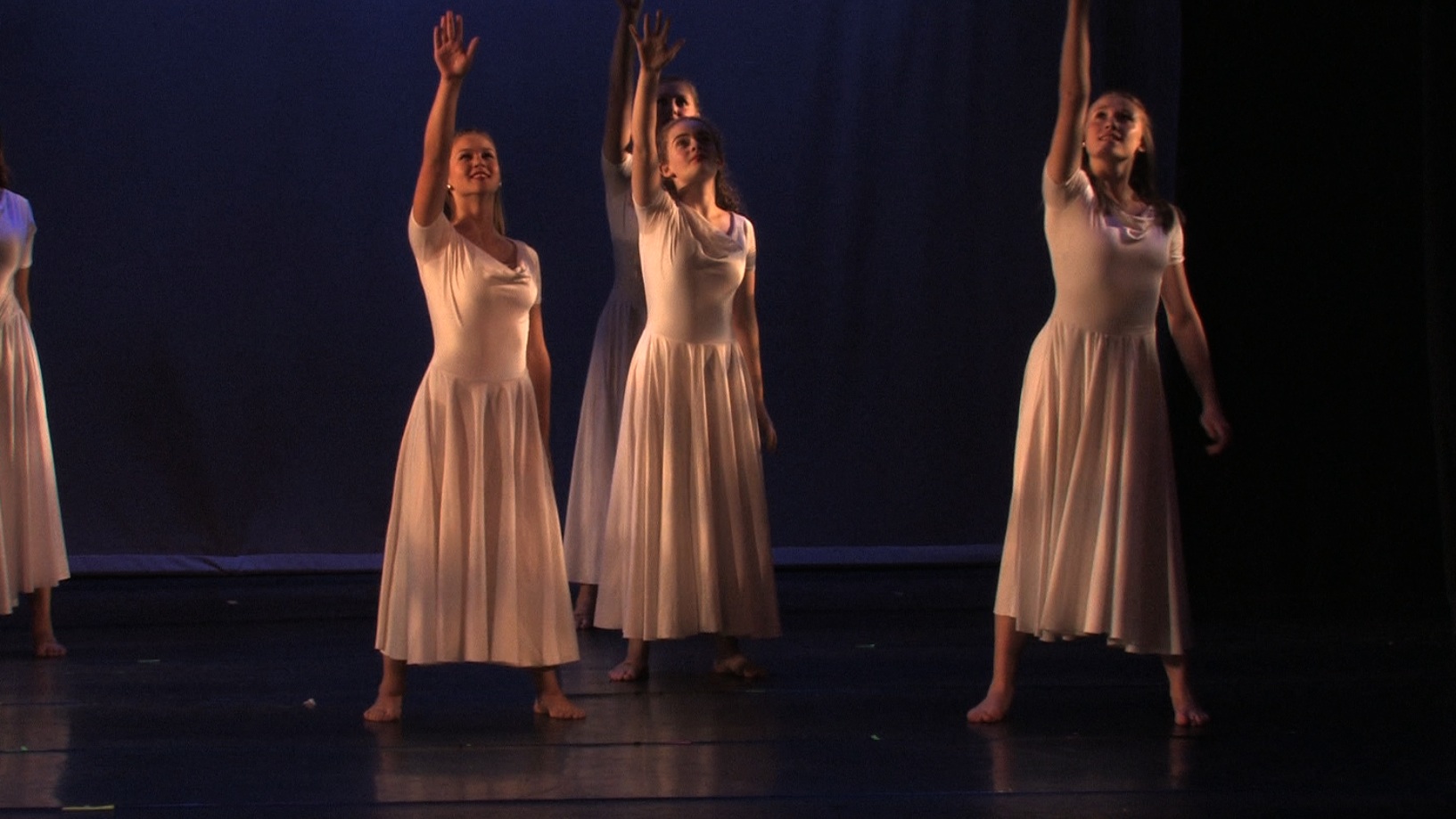

yeah, we tried that, have multiple times. I am attaching 2 stills, one from each camera; roughly the same spot. We stuck to I believe 3400K on temp. Seems that brightness looked good on her camera; and even with copying settings from mine to hers, her shot was still dark. Her active matrix screen is much brighter on her MBP; which was being used to monitor picture... with little LCD.
Was halfway considering running through FCP, and having the waveform monitor open there. Just seem easier to catch these using QuickTime.

I feel the meters are not going to help because they are two different shots. Brightest in one pic is the dresses, while the other appears to be the lights. Did you ever zoom into the same thing and try to match the cameras then back one off? If you zoomed in on the subject and set proper exposure, then back off would be a better chance for the two. Please excuse my ignorance, but what is a MBP? What are you using to match the camera's? What is your current "process" to match the cameras?

Thanks Michael, That ultimately may have been the problem on this one....those lights at top were bright, I think perhaps my wife was compensating her shot to make sure they weren't so bright. There were 3 performances, this was the last, and not every piece was so noticeable.

Guess it's already said, but you will probably have to overexpose the lamps in the wide shots to get the same level of exposure from both cameras. Setting the zebras to kick in at for example 80-90% on both camcorders, adjust exposure until the zebras disappear from the dresses on both camcorders. That will give you a wide shot that probably overexpose the lamps but the dresses will have about the same light level as the (now a little underexposed) closeup shots. Zebras at 80% will also give you a little room to adjust brightness and contrast in post.

I have a xh-a1 and never use any exteral lcd/laptop's to judge exposure, eventhough the lcd screen is too small and cluttered with info (which you can remove but I like to see what the camera is doing) I can get accurate exposure only by relying on my zebra's. Ofcourse when it's too dark it can happen that the zebra's don't even kick in but in that case your lens is wide open anyway and when working with 2 camera's you just need to check you both are using identical gain. Ofcourse in such a case you need to be carefull when zooming in with one camera as you will loose light sensitivity.
The shot I see above is clearly underexposed, compared to the other cam, something you can only avoid by using your zebra's (if there is enough light for them to show)
I also would never rely on the image you see on the lcd, maybe one camera has a bit brighter lcd then the other and you will have a problem allready. With 2 xh-a1 just make sure both camera are exactly set up in the same way, are using the same WB setting and you use the zebra in the same way. Never expose on a light above but on the subject you want to have exposed right, like the dancers in this case.
