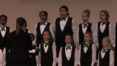

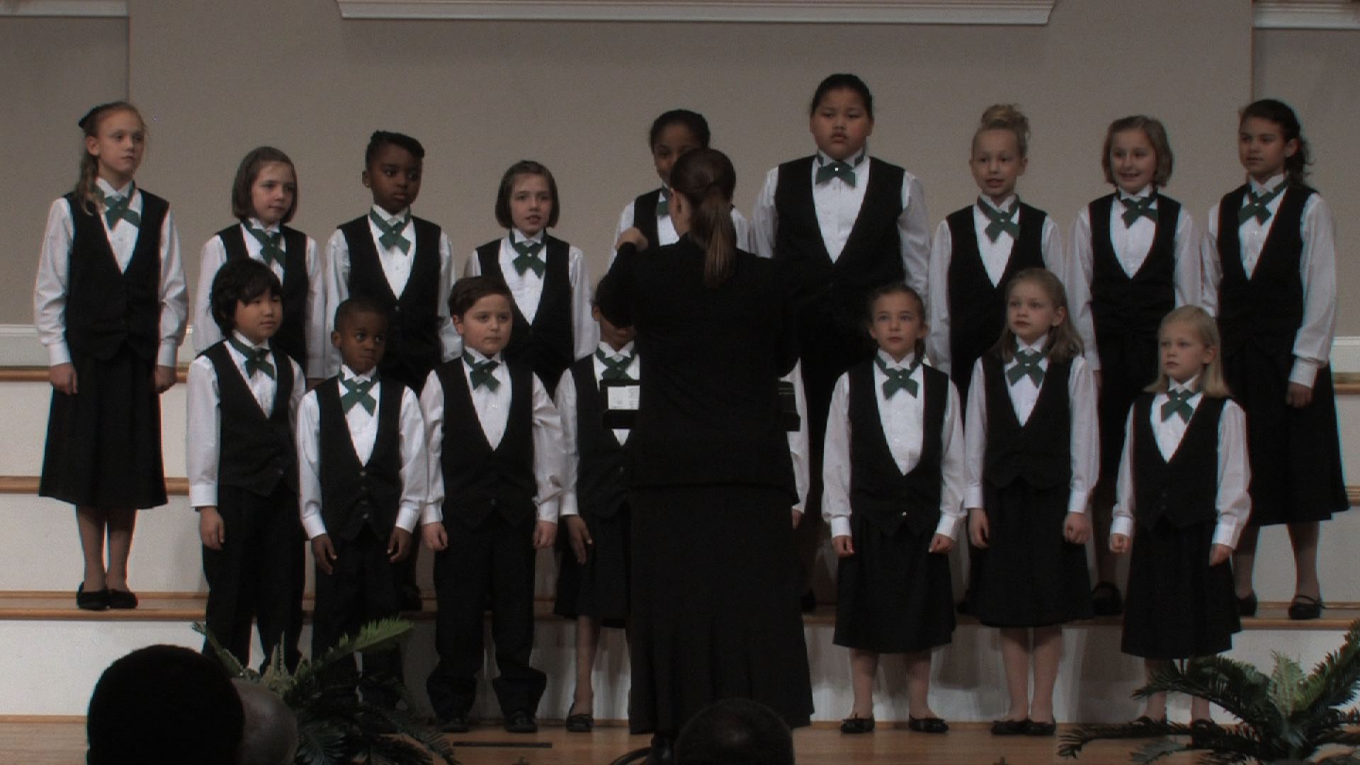

I did a shoot last week, and using the SD card, matched up settings on 2 (identical) XHA1s cameras. I set both of them on manual white balance at 2800K As you can see, the 2 cameras appear to be off still. Any ideas on what may have caused this, and suggestions on getting a solid white balance on 2 cameras in the future?

David .. we've seen this between my A1 and A1s cameras on a dual shoot.
My solution was to eventually get 2 neutral expodiscs, started with one but it took to long to wb both cameras, so after trying it we now have 2 and one warm one .. not cheap but they're absolute magic in mixed lighting, we never leave home without 'em. Saves hours in post.

At least on my PC monitor it looks like the exposures are slightly different as well causing one slightly brighter than the other. Was this using full manual setting? What gain settings? Any presets turned on in the camcorders?

These were on full manual, and to the best of my knowledge... they were set on the same preset, I generally use Truecolor; although thinking of trying one that doesn't give such strong saturation. Gain was set on 0

David you have one setting different between the two cameras. Spend some time and slowly compare every and all settings.

One thing I find strange though is that you get a white balance shift between 2 the same camera's that are also set the same, that should normally not be happening and I think a expodisc will not solve that.
I would check your camera's setting real close by diving deep into the menu's and comparing every value, do some wb test without a preset and see what that gives and if it's still off there must be a difference in set up. Maybe this can be of help to compare?

If the images are the same point in time, the cameras are not at the same location, they are offset by some sustantial amount.
White balance can be effected by stray light hitting the lens but still out of the field of view, especially if the white balance was set based on light hitting a disc on the lens that is not equally hitting the intended scene. Were there lights (spot, floor, or area) above the camcorders than might not have influenced the otheer camcorder expodisc or stage equally?

UV (or another) filter on one of the camcorders and not on the other?

I really appreciate all of the input everyone, I'll go through a little later and double check. I had another shoot this past Monday and Tuesday, and did a manual white balance on both, and that seemed to really help. My concern has been that using the custom Kelvin temp setting, on both cameras were looking different. Now, there's a chance that perhaps one of the camera's custom presets got turned off accidentally; which could have explained the difference as well.
