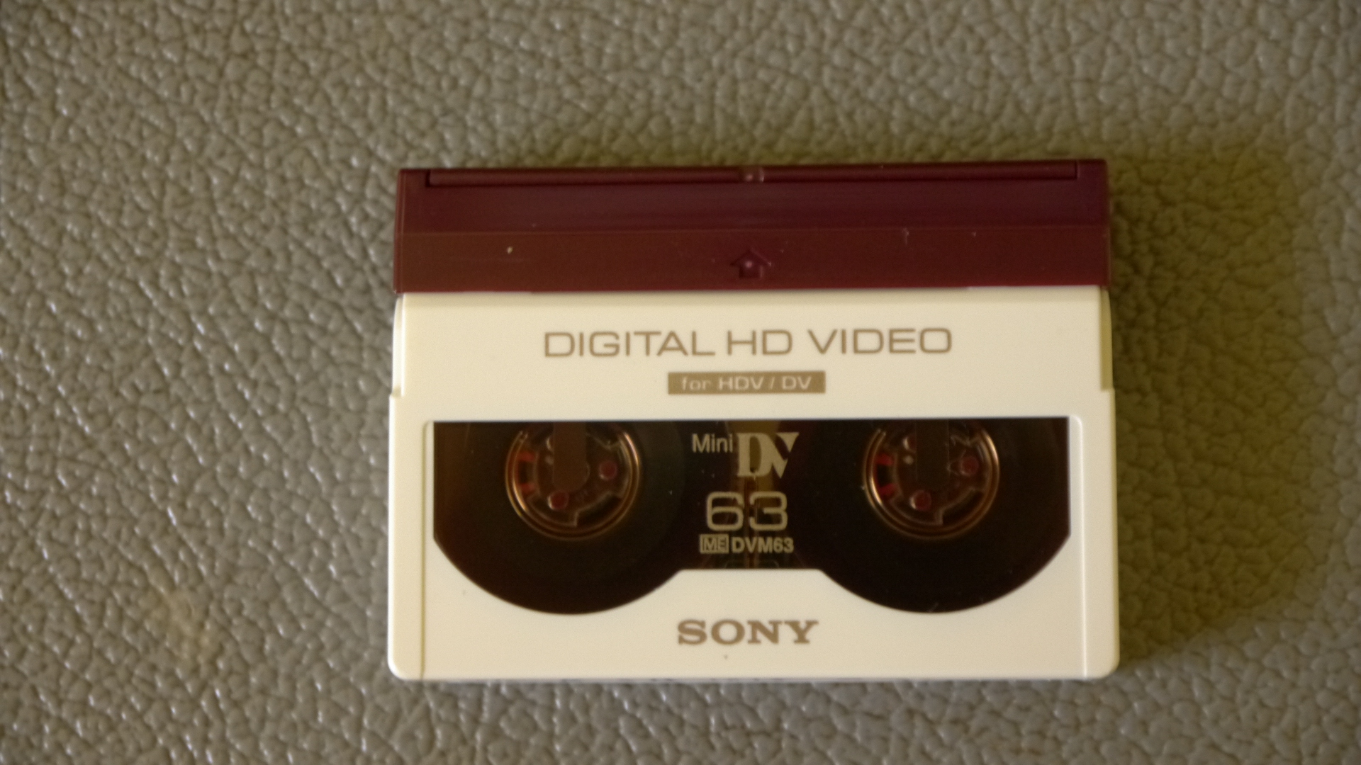

I've been having the same problem. I bought my last 5 pack of tapes about 4 months ago, and the camera started glitching. I thought it was just the camera, but now I'm not so sure. All 5 of the new tapes have the playback issue. Never had the problem before. It happens at random times, 60i, 30F, Maual, Auto, AV. Out of the 5 tapes I had about 1/4 with the glitch. It could be a bad batch. I may buy one new tape just to check, but I can't trust tapes anymore, I lost too much time and good footage. I put the camera on the shelf and am checking around for an external recorder so I can use the camera again with confidence.
I've used the same Sony tapes for 4 years and have been through about 35 of them.

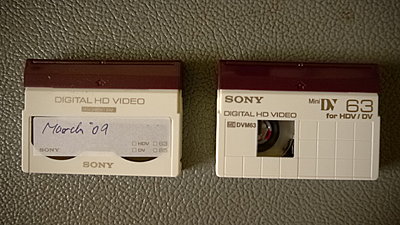

The first photo has the bad 2012 tape on the right and a good 2008 tape on the left. Looks like the design has changed. The second photo is also from an '08 tape. Can anyone else compare the design of their tapes with these photos?

I guess this problem will only get worse, maybe because some major suppliers that produced tapes in the past, and that did extensive quality control, have stopped producing and production has shifted to "cheaper" supplier that don't invest that much in quality control anymore? Maybe buying and using cheaper materials to save on cost, make more profit.
