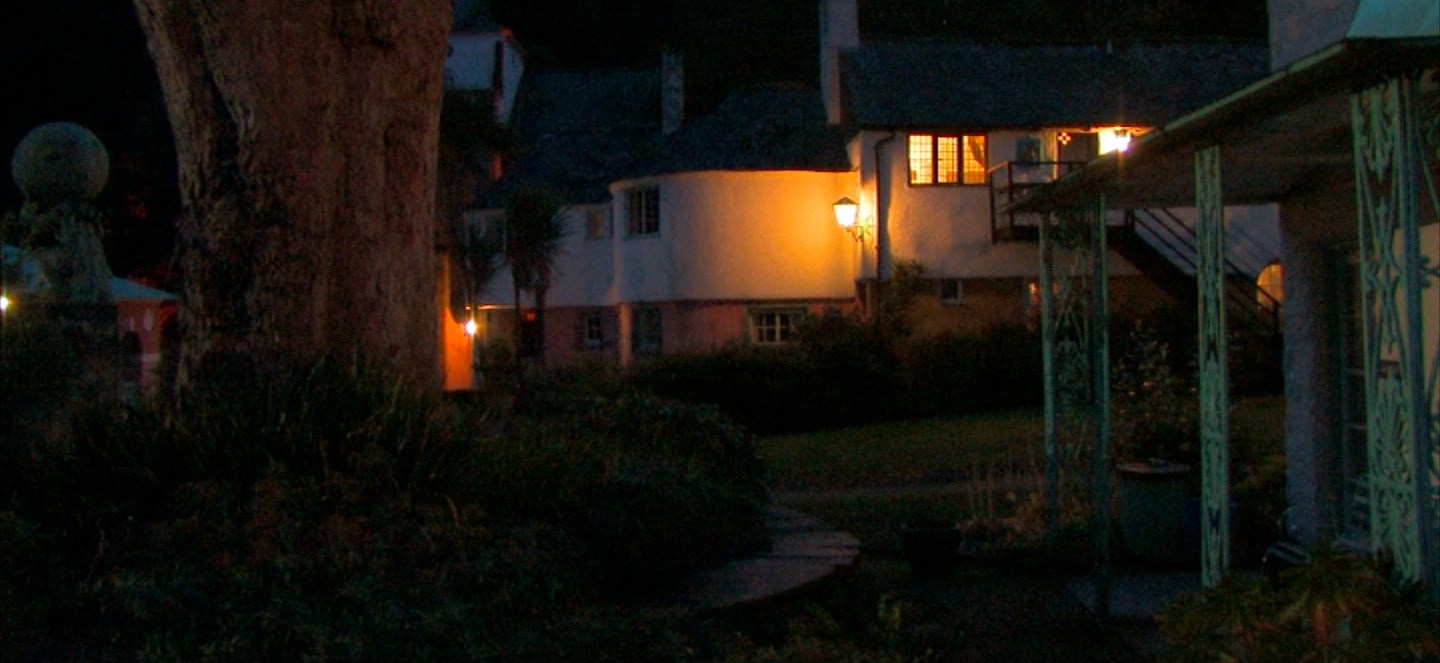

I haven't done Christmas Lights specifically, but I did do quite a bit of architectural filming at night recently by available light with a small portable fill light for foreground details. For low light work, I now mostly use the "PF Vision" preset, but there are others worth a try. I don't go higher than +6dB gain and try to use less if possible. I use full manual settings.
http://www.dvinfo.net/forum/canon-xh...ht-preset.html is worth a read, and the sticky at
http://www.dvinfo.net/forum/canon-xh...rary-copy.html contains all the recommended presets.
I don't know how much you want of the background to the lights - it will take a bit of experimentation so as not to overexpose the lights themselves - you don't want the colours washed out I imagine.
This screengrab has lamps in shot which are not too overcooked and the grain isn't totally disastrous.
Last edited by Colin McDonald; December 20th, 2012 at 03:16 AM. Reason: Added image

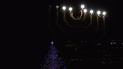

Sensor technology has advanced a lot in recent years, so you do not need a big-sensor camera (with accompanying lack of sharpness and moire if you are talking DSLR) to get good low-light performance (you do need a wide aperture).
The main trick is to actually close down the lens - lights are, well, bright and if you want to see colors you need to darken the scene.
Here are two Christmas night light frame grabs taken with a recent small one-chip camcorder (if 1/2.88" is considered small) at 1/60th of a second; no tricks. The first focuses on lights, and ensures the colors are apparent. The second allows more of the setting to be seen (the lights are not colored). The noise is way less objectionable than that in the frame grab posted above, which is not only noisy but not very sharp.
Filming outside CHRISTMAS lights with XH-A1-20121213195059-1-2-.jpg   Filming outside CHRISTMAS lights with XH-A1-20121213195059-1-3-.jpg
Mark Rosenzweig is offline   Reply With Quote

I'm with Richard on this. The larger the sensor, the greater the dynamic range, i.e the better the ability to handle highlights and shadows. Neither of the posted pictures does it for me I'm afraid (sorry guys) - the first one is too grainy and the second one is too dark - and I'm not convinced that you will find any small chip camera (1/3" or less) that gives an acceptable result ('acceptable' being very subjective, of course).

You did not comment on the *third* one, which is neither too dark nor too grainy, right? Btw, the criterion I use is whether the shot *accurately* portrays the scene. These do that - in fact the first was a scene that was pitch black; there were no lights other than the decorations.
I agree that dynamic range is important if you want to capture bright lights and some detail in the setting. Of course, no camera has the dynamic range of the human eye, but too many night shots brighten the real scene unnaturally.
And it would be really nice if you provided an example that did better.

<Screen> grab, not a frame grab - explains (some) of the lack of sharpness. :-)
I agree with Richard too, BTW, but I thought it might be of interest to post something that was actually taken on an XH-A1.

Mark, yes you're right, sorry, I didn't actually see there was a third picture! It is much better (although still a tad too dark for my taste). As you rightly say, though, if it is an accurate representation of what the scene was like at that time then no argument from me on a technical level.
I suspect, though, that the OP's objective is to capture the scene in its best light and to make it as attractive as possible to look at, rather than wanting it to be an absolutely pinpoint accurate representation of the scene at that time. I am happy to be corrected.
